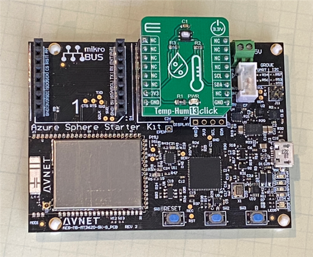

Recently I developed a new Azure Sphere demo for our sales team in Asia and thought I would share it with the community.  The project is simple, I added a MikroE Temp&Hum 13 Click Board (with a TE HTU21D sensor) to an Avnet Azure Sphere Starter kit and developed an application to read the sensor and send the data to Azure.

  1. Avnet Azure Sphere Starter KitAvnet Azure Sphere Starter Kit
  2. MikroE Temp-Hum13 click board
Demo Build
This is a pretty easy build, just plug in the click board to either of the mikro BUS sockets.  The click board uses I2C (ISU2) and the I2C ISU2 signals are shared across both mikro BUS sockets. Just make sure you insert the click board with the sensor at the edge of the Starter Kit, like in the picture above.   You should also be able to use a HTU21DHTU21D Grove device, but I have not tested with that hardware.

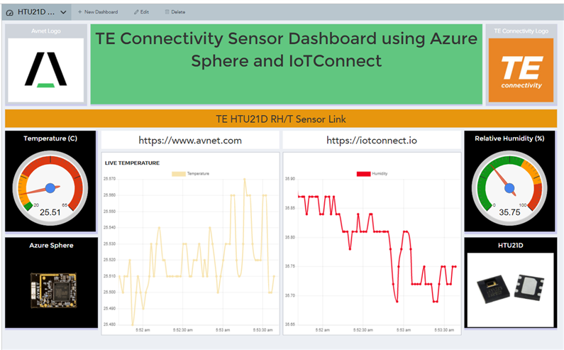

IoTConnect Cloud Dashboard
If you've never heard of IoTConnect before let me tell you a little about it.  Here's the Marketing description from the IoTConnect web site:
"IoTConnect is a full-fledged platform as a Service (PaaS). This horizontal IoT platform allows for device communication and management, data storage, app creation as well as enablement and robust security protocols.
IoTConnect is the only IoT platform available in the market that comes with a powerful device management system and built-in analytics that allows you to connect and manage devices with little to no coding. Its powerful yet easy-to-use interface enables enterprises to create applications faster than laborious coding saving a lot of time and money."
IoTConnect has lots of great features including pre-built vertical application across many different industries.  As a developer, I love the interface to visualize telemetry data in near real-time.  It's great for demos and pretty easy to use.  Avnet is working on an easy way to allow developers to test drive the Avnet IoTConnect cloud platform.  We're not there yet, but I thought I would at least show you the dashboard I created for this demo.  Once we have a way to turn on developer test accounts, I'll update this Blog.
For our demo I created a user defined IoTConnect custom dashboard to show the telemetry data and some company information for Avnet, IoTConnet and TE Connectivity.
Custom IoTConnect User Defined Dashboard

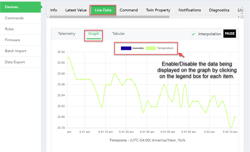

Live Data Screen
One of my favorite IoTConnect features is the real-time Live Data tab.  If you want to see your telemetry update in near real-time, you need to see this interface, it's pretty slick.

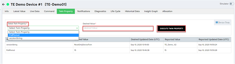

Device Twin Screen
IoTConnect also includes an interface for updating and viewing device twin properties.
