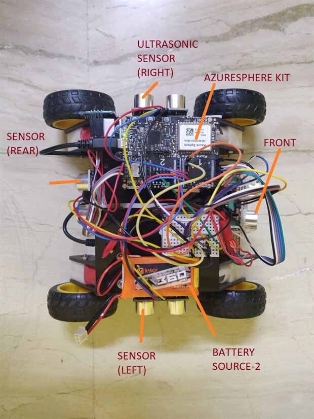

A simple architecture of the bot is shown below which includes the following components
BOT’s brain behind
  1. Azure Sphere MT3620
BOT’s taste buds - External Sensing
  1. Ultrasonic Sensors
  2. Avnet Azure Sphere – Handy OnBoard Sensors – Accelerometer, Gyroscope, Temperature, Light Intensity sensors
BOT’s Movement Aid
  1. 4 Wheeled Robotic chassis driven by  H-Bridge based driver board
BOT’s  Hunger Boost
  1. Power Source 1:
5V USB source from a mobile battery bank is used to power the MT3620 through its micro USB port.
  1. Power Source 2:
7-12V Li-Po used exclusively to power hungry motors.
BOT’s Human Interface

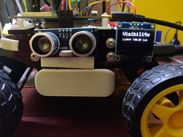

  1. 128 x 64 OLED Display
  2. Azure IoT Dashboard (Work-In-Progress)*
BOT’s Assignment
  1. UV LED mount plate with 5mm LED (3Nos)

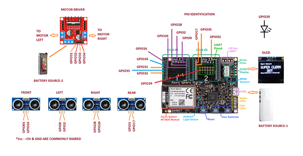

Wiring Diagram
As planned to make use of AzureSphere GPIOs, following are the connection / pin mappings

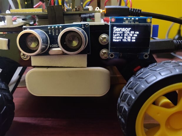

Pin Mapping for Ultrasonic Sensors
  1. Sl.No
AzureSphere PIN
Sensor Pins
Description
1
GPIO1
TRIG
Front Sensor
2
GPIO16
ECHO
3
GPIO0
TRIG
Left Sensor
4
GPIO2
ECHO
5
GPIO28
TRIG
Right Sensor
6
GPIO26
ECHO
7
GPIO3
TRIG
Rear Sensor
8
GPIO17
ECHO
BOT - TopView

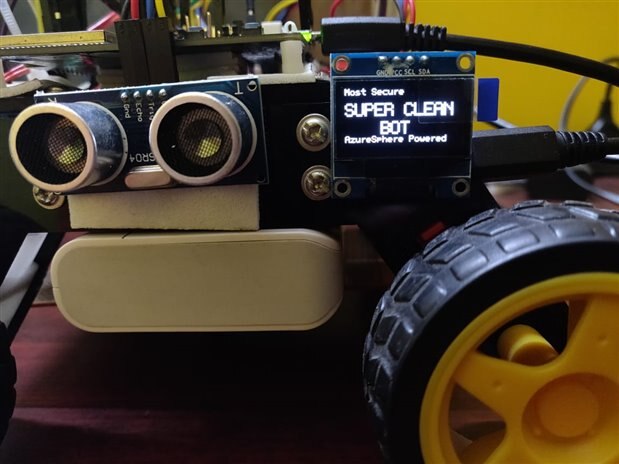

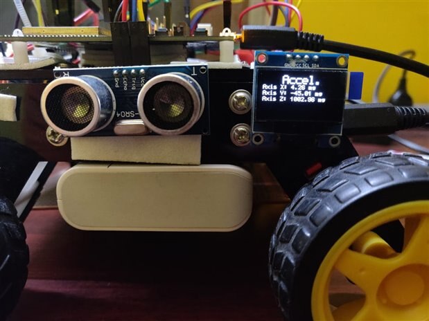

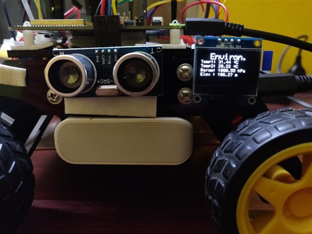

BOT – START SCREEN.
To check other parameters Press User Button B

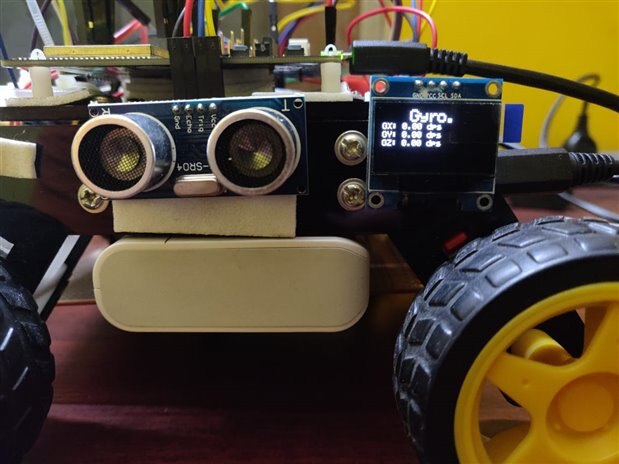

BOT – SCREEN - 2. (On Pressing User Button B)
BOT – SCREEN - 3. (On Pressing User Button B)
BOT – SCREEN - 4. (On Pressing User Button B)
BOT – SCREEN - 5. (On Pressing User Button B)
BOT – SCREEN 6. (On Pressing User Button B)

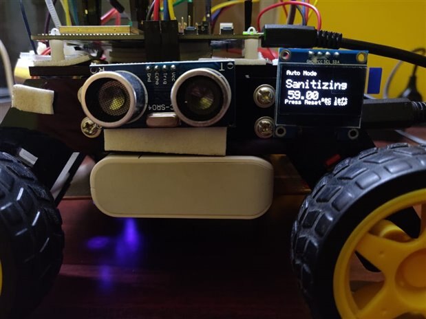

BOT – AutoMode. Default Time 60seconds - (On Pressing User Button A and User Button B together)
Working Demo:
https://youtu.be/88mr-1gAgaQ
To enable AutoMode – Press User Button A & Button B together. Sanitizing process starts with default period of 60seconds. To restart press “Reset” button.
