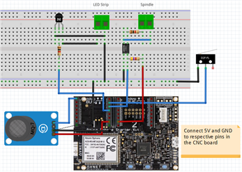

HARDWARE SETUP AND SCHEMATICS:

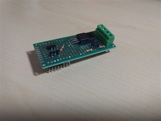

The project is fully replicable on bredboard and with dupont jumpers. I preferred to build a perfboard including the transistor, the optocupler and the resistors.
EDIT: pull-down resistors are required for the limit switch and the optocupler! They are not indicated in the schematics but must be used.

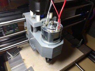

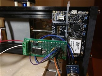

The board is powered by the 5V and GND pins of wookpecker controller. You need a way to get a 24V line (for LED strip) from the power supply, I have cut the cable and made a junction with plastic caps. Then you have to connect two cables in parallel to the spindle +/-. Do it where you prefer, I have connected them at the top of the spindle. Connect the limit switch and place it in a way that the door triggers it. Fix the board in a safe place, better if inside a box or however protected from dust and shortcuts.

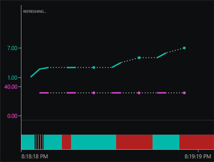

Go to the "Rules" tap and add some events that you like to invoke. For example I have added a temperature alarm that triggers when temp is bigger than 40 and sends a email to my address.
An other rule may send you a mail when cycles reaches a value to remember you scheduled maintenance.

The usage is basilar and easy. When you open the door, the limit switch is triggered and Azure Sphere will turn ON the LED strip. Spindle status (ON/OFF) will be monitored for each cycle of the loop, incrementing cycles value locally and sending the value to Azure Cloud when available. The value is resettable by pressing B button on the board.
Spindle cycles count, temperature, air quality and door status are sent to the cloud when a connection is available.
