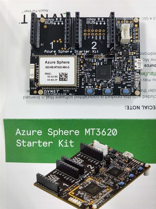

The Sphere MT3620 module is based on the MT3620 SoC, which includes built-in Microsoft security, WiFi connectivity, and the combined versatility and power of an Arm Cortex-A7 processor with the low overhead and real-time guarantees of two Arm Cortex-M4F microcontrollers. A suite of on-chip peripherals, real-time clock, Flash, and RAM are also available. In addition to the MT3620, the 33 x 22 mm module includes a dual-band WiFi chip antenna and system clock. Up to 27 configurable GPIOs and three configurable serial ports (UART, I2C, or SPI) are provided as I/Os on the module.
The core part is MT620 SoC, lead to Fast Development to Mass-Commercial Product. This is what I would like to try how long it takes me to build one MVP and prototype design beyond the maker's comfort zone.
With the Click board

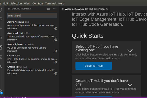

Install visual Studio Code for Linux https://code.visualstudio.com/Download
     After installation, configure VS Code with the path to the Azure Sphere SDK installation directory: In the File menu select Preferences > Settings > Extensions > AzureSphere. Under Azure Sphere: Sdk Path enter the path to the AzureSphere install directory
Install GNU embedded toolchain for ARM core CM4 https://developer.arm.com/tools-and-software/open-source-software/developer-tools/gnu-toolchain/gnu-rm/downloads
     After installation, configure VS Code with the path to the GNU Arm Embedded Toolchain:
     In the File menu select Preferences > Settings > Extensions > AzureSphere.Under Azure Sphere: Arm Gnu Path enter the path to the GNU Arm Embedded Toolchain install directory.
Optional, you can install terminal tools
sudo apt install minicom
sudo minicom -D /dev/ttyUSB5 -b 115200
The visual Studio Code comes with installed extension as Azure Sphere and Azure IoT hub for fast development
