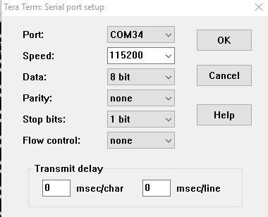

  • When using the Microsoft examples configure the PC serial port to 115200-8-N-1

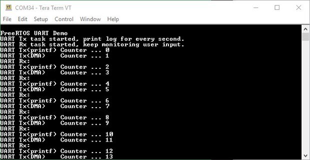

MediaTek Examples
The MediaTek M4 examples are mostly implemented using freeRTOS.  The examples use a printf() implementation to transmit debug information.
  • When using the MediaTek examples configure the PC serial port to 115200-8-N-1
CodeThink Examples
The CodeThink M4 examples are all BareMetal implementations and they use a custom routine called UART_Print().
  • int32_t UART_Print(UART *handle, const char *msg)
  • When using the CodeThink examples configure the PC serial port to 115200-8-N-1

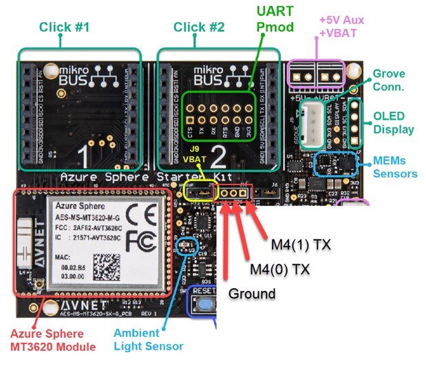

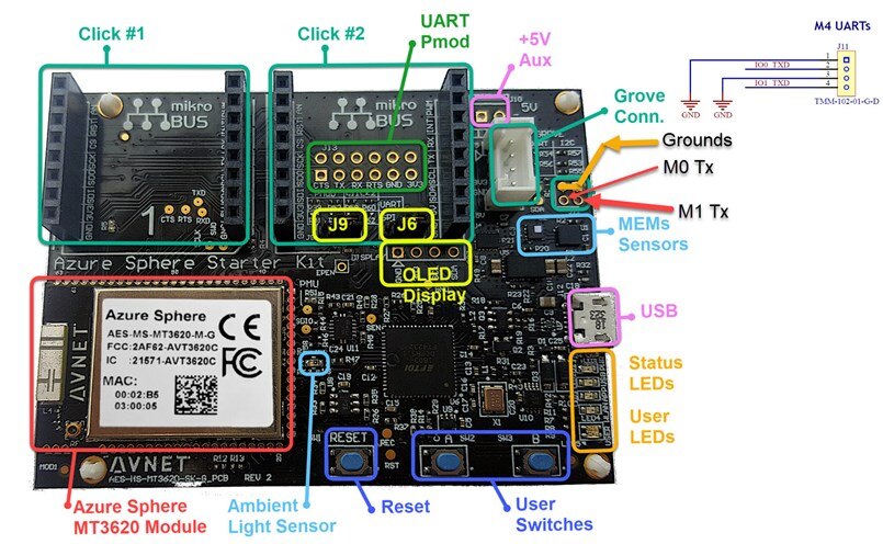

Using the M4 Debug UARTs
The MT3620 pins out both M4 Debug UARTs.  On the Avnet Kit these are exposed on the J11 header, see the diagram below.  Note that these are TX only from the M4.  The MediaTek examples document how to change the example applications to use the M4 Debug UART.

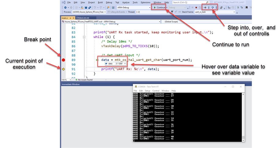

GDB Debugger Integration
One of my favorite Azure Sphere development features is the ability to use the GDB debug utility.  This allows me to set break points, monitor variables and single step through my code at run-time.  We're doing embedded development with Azure Sphere and having this functionality makes developing and debugging embedded applications as easy as debugging modern PC based applications.  To use the debugger for M4 applications we have to install an additional USB driver.  Actually, I think you need to install this USB driver to do any M4 development with Visual Studio.  If you try to run an M4 application and you see an error similar to . . .
"Unable to start debugging. Unexpected GDB output from
command "-target-select remote *:4444".
*:4444: No connection could be made because the
target machine actively refused it."
Then you need to install the USB drivers.  From the Microsoft documentation:
  1. To Install the USB drivers for the M4 debugger
    1. Right-click the Azure Sphere Developer Command Prompt shortcut and select More>Run as administrator.
      1. The --EnableRTCoreDebugging parameter requires administrator privilege because it installs USB drivers for the debugger.
    2. Enter the following azsphere command:
      1. azsphere device enable-development --enablertcoredebugging
    3. Close the window after the command completes because administrator privilege is no longer required. As a best practice, you should always use the lowest privilege that can accomplish a task.
After the driver is installed you can set breakpoints, monitor variables and single step through your code at run-time!  The screenshot below shows my application halted and the value of the variable my mouse is hovering over.

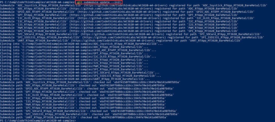

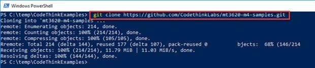

Links to Source Code Repositories
I've included links to the GitHub MT3620 repositories discussed in this blog.  In each case, you should clone the entire repository since there are usually supporting utilities/code/libraries included at higher levels.
  • Microsoft Example Applications
  • MediaTek Example Applications
  • CodeThink Example Applications

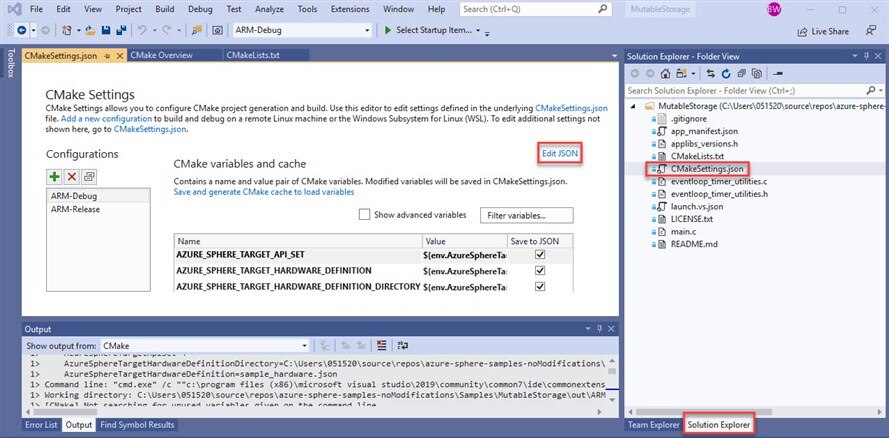

What you need to know to use these examples
The Microsoft examples all use the Hardware Abstraction layer that will allow you to use the examples with any of the current Azure Sphere Development Kits.  Since I work for Avnet, I use the Azure Sphere Starter Kit for all my development and demo applications. If you're using one of the other kits, you may not need to make any changes to use the Microsoft examples.

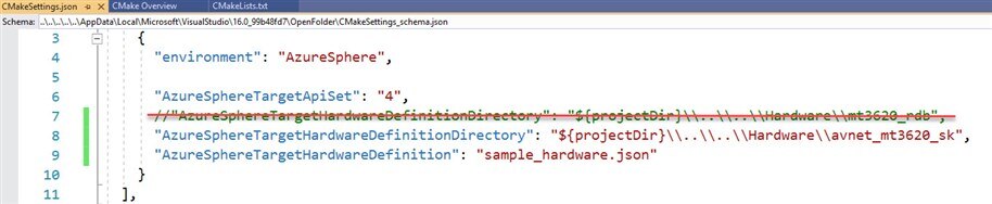

If you want to use the Azure Sphere Starter Kit with the Microsoft Examples you need to make the following changes . . .
  1. Open the CMake Project
  2. Open the CMakeSettings.json file from the Solution Explorer window
  3. Click on the "Edit JSON" Link in the CMake Settings window
  4. Change the "AzureSphereTargetHardwareDefinitionDirectory" entry to reference the avnet_mt3620_sk directory.
  5. Save the file
  6. CMake will regenerate the build files and you can build and run the example on the Avnet Starter Kit

        • Connect the GRD signal  from  the  MT3620 Kit to the GRD on the TTL Serial Cable
    • Terminal Software: Putty, TeraTerm or your favorite terminal application
      • Serial Port Settings
        • 115200, 8, N, 1
Example output
Here's my Tera Term configuration and example application output from  the MediaTek freeRTOS UART example.  Note that your com port will likely be different.

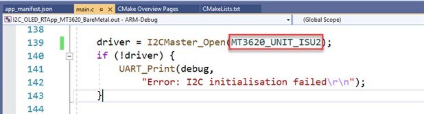

I have the least amount experience with the CodeThink examples.  These examples all target the Seeed RDB with no method to easily change the target device.  To use them with the Avnet Starter Kit you may need to make code changes (hw definitions) and figure out how to wire your kit.

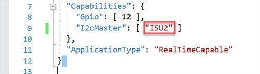

For example I ran the I2C_OLED_RtApp_MT3620_BareMetal example on my starter kit.  I needed to make two code changes.  This application assumes the SSD1306 OLED display is wired to ISU1.  On the Avnet Azure Sphere Starter Kit, the (un-populated) OLED connector is wired to ISU2.  So I had to update the app_manifest.json file and change main.c to reference ISU2.  After these two changes the application ran just fine.
What I like about these examples
The examples include implementations like using the ADC interface to read joystick outputs, or using the I2C to drive an OLED.  These examples not only show you how to use the hardware interfaces, but have examples that do useful things!
To use these examples you need to first clone the main repository, and then pull in the lib directory files.  Follow the directions below . .  .
  • Identify a directory for the source file, I'm going to use c:\temp\CodeThinkExamples
  • Start a command line application such as "Windows PowerShell"
  • Create the directory and change to that location
  • Clone the repo with the command git clone https://github.com/CodethinkLabs/mt3620-m4-samples.git
  • Now change to the newly created mt3620-m4-samples directory
    • cd mt3620-m4-samples
  • Pull the library files.  This command will update each example directories \lib folder
    • git submodule update --init

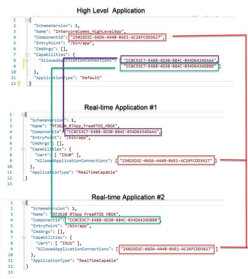

Partner applications is the implementation to allow applications on different cores to communicate with each other.
app_manifest.json
Just like we have to give our Azure Sphere application explicit permission to use any hardware interface in the app_manifest.json file, we must also give our application explicit permission to communicate with other applications on different cores.  Each application is identified by it's component ID as defined in the app_manifest.json file.  The example below is from the MediaTek MBOX example.  The app_manifest.json capability is called "AllowedApplicationConnection."
The MBOX example includes three different applications.  One high level application and two real-time applications.  Let's examine the app_manifest.json files from each application to see how they define the partner applications.  Notice that the Red boxes all contain the same GUID (*627).  That's the GUID for the high level app (as defined by the ComponentId field).  Both of the real-time applications list the Red GUID (*627), so both real-time applications are allowed to communicate with the high level application.  Conversely, the high level application lists both of the real-time application GUIDS the Purple (*AAA) and Green boxes (*BBB).  So the high level application can talk to both of the real-time applications.

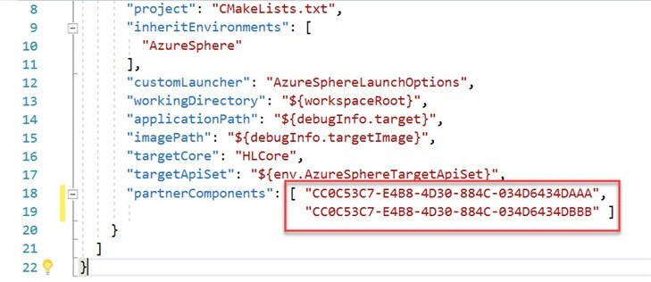

launch.vs.json
For OTA deployments the app_manifest.json files are the only requirement for the applications to all run on the MT3620 at the same time (other than correctly configuring the OTA update, that's a future blog).  But for the applications to all run in a debug scenario, we also need to define the partner applications in the launch.vs.json file.  Visual Studio uses this file to determine if more than one application should be running on the target when starting a new application.  By default when starting a new application from Visual Studio all other applications on the device will be removed from the device.  The partner component entries tell Visual Studio that the other specific applications should be allowed to run.  When these entries are not correct you can start an application on the device then when you start a second application, the first application will exit.  This is pretty frustrating, ask me how I know!
The concept is exactly the same as with the app_manifest.json file, just the key names are different.  See the launch.vs.json file for the high level application below.  Note that the *AAA and *BBB GUIDS are both defined.  If we looked at the real-time applications launch.vs.json files they would contain the high level applications *.627 GUID.
