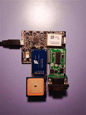

The hardware
In order to build this logger, you'll need the following items:
  • Obviously, an Avnet Azure Sphere Starter Kit (with its USB cable),
  • A MikroElektronika OBDII Click (buy here),
  • A NMEA-compliant GPS module configured to work at 9600 baud (I used and u-blox NEO M8N),
  • A microSD card reader module (possibily with no on-board regulator, see documentation),
  • A DB9 to OBDII cable (I used this one from MikroElektronika),
  • A microSD card,
  • Some perf-board (for building the custom "click" module),
  • Two diodes (I used two 1N4007 rectifiers),
  • A 4.7kΩ resistor,
  • Strip headers (2x 1x8 headers)

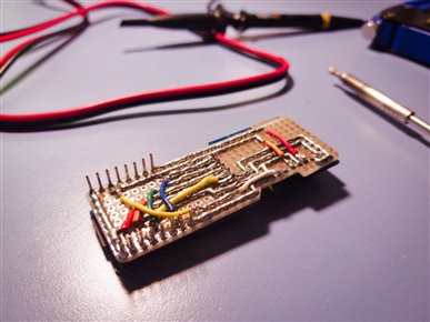

The detailed connections for building your custom click module are documented on the GitHub repository. You'll need to follow this table to correctly connect the GPS receiver and the microSD card reader to the strip header pins of the module, but remember that since you are working on the back side, everything is reversed (actually got it right only after the third error).
You'll need to connect the OBDII click to the first socket and the custom module to the second one. They can be swapped, but you'll need to edit some constants in the configuration files (for both the Cortex-A application and the Cortex-M firmware).
I'm working on a 3D printed case, but since it will only fit my specific build, I prefer to share better future ideas in the last section.
Here are some pictures of the custom module I made before adding two diodes and an external voltage converter (along with a picture of my desk):

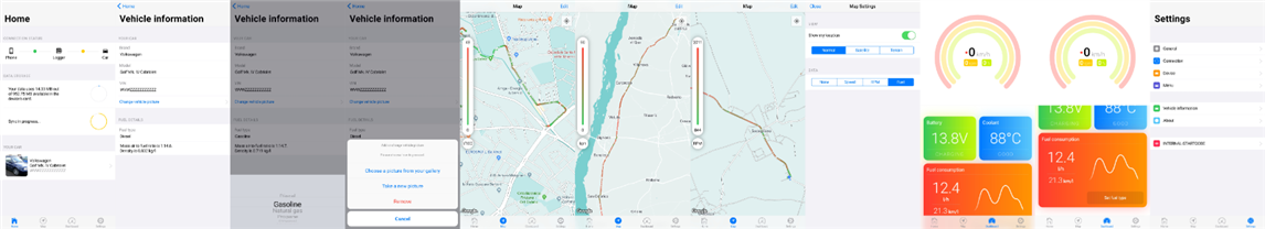

I wrote a mobile app for visualizing a map with all the data recorded by the logger. The app is complete from the point of view of what this project should do (showing the better route in terms of fuel economy for commuting and moving), but I decided to take it to the next level and start to implement more features. Many of the "extra" parts are still incomplete (such as the dashboard, which shows dummy data since I'm experimenting with its design).
I chose Flutter as my reference framework because porting the app to other platforms (iOS, desktop, embedded, web) is very easy. Currently the application is only available for Android 9+ devices. Unfortunately, iOS apps can't be compiled on a Windows machine, but I'm looking into CI/CD solutions for this. Now, let's go straight to what the app is. Here there are some screenshots.
The setup process:
Here is the main menu with four tabs (the first two are most important ones):
As you can see, I used Flutter's Cupertino theme (yes, it looks very similar to iOS, but it's running on an Android device). The most interesting parts are the download section, on the "Home" page, which tells you the currently available space on the logger's memory card and shows you a download button in place of the yellow progress indicator when the device is connected and detects an SD card with new logs, and the three maps, with three different data types selected. The first of the three maps shows the fuel consumption (green is better), the second one the speed from the GPS sensor and the third one shows the engine's RPM count. On the following screen you can select the desired data type, the map type and whether to show your current position. The number of markers is fixed in order to keep the same performance over time.
