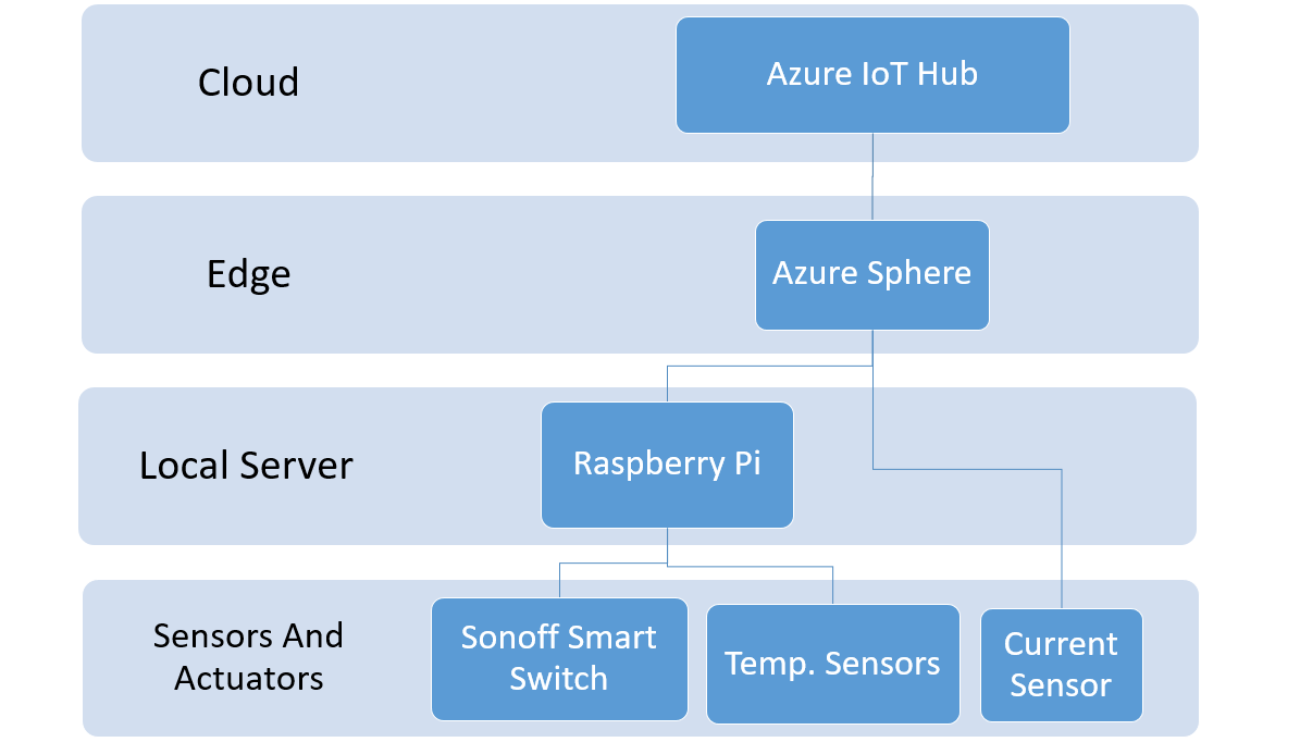

Architecture of the system i came up with:
In this architecture Azure Sphere serves as telemetry broker and secure gateway to the cloud. Telemetry from sensors is being provided to Sphere OS by local server (Paspberry Pi) and by Real Time capable Application which is using ADC to sample data.
Connection between Cloud, Edge (Azure Sphere), Local Server (Pi3) and Sonoff Smart Switch is possibile thanks to WiFi.

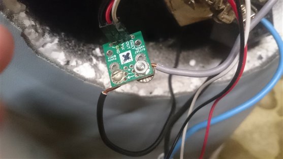

I have also used current sensor ACS711EX wchih has output proportionall to measured current. Sensor is powered using 5V Vcc form Azure Sphere, its output voltage when current is 0 is at Vcc/2 wchih is equal to 2.5V. This output has been connected to Channel 1 of ADC controller. (Channel 0 is used by built in light sensor). This way when current increases, voltage decreases proportionall to sensitivity and it is measured by Real Time Core.
Like you can see on above photo, white cable goes directly to AN header on Socket 1 click, Red and black goes to 5V and GND respectively on Socket 1 click. This thick black and grey cables are transferring current to immersion heater. Sensor is connected in series on plus side.

Current actual value is measured by ACS711EX connected to ADC 1 of Azure Sphere. ADC on the other hand is acceses by Real Time Core.
ACS711EX sensor is based on Hall efect, it converts current to proportional voltage. It looks as follows:
ACS711ex sensor view
Thanks to holes on left side thick cables can be connected, this is needed in case of high currents. In my case current up to 9 Amps will be measured.
When current is 0 A output voltage is equal to sensor supply voltage divided by 2. (Vcc/2). In my case it is 5V/2 = 2.5V. When DC current starts flowing in either way ( from IP+ to IP- or reverse) the output voltage increases or decreases proportionally. In this way this sensor can measure current in both directions. It also has FAULT output which indicates that current has exceded maximal rated current.

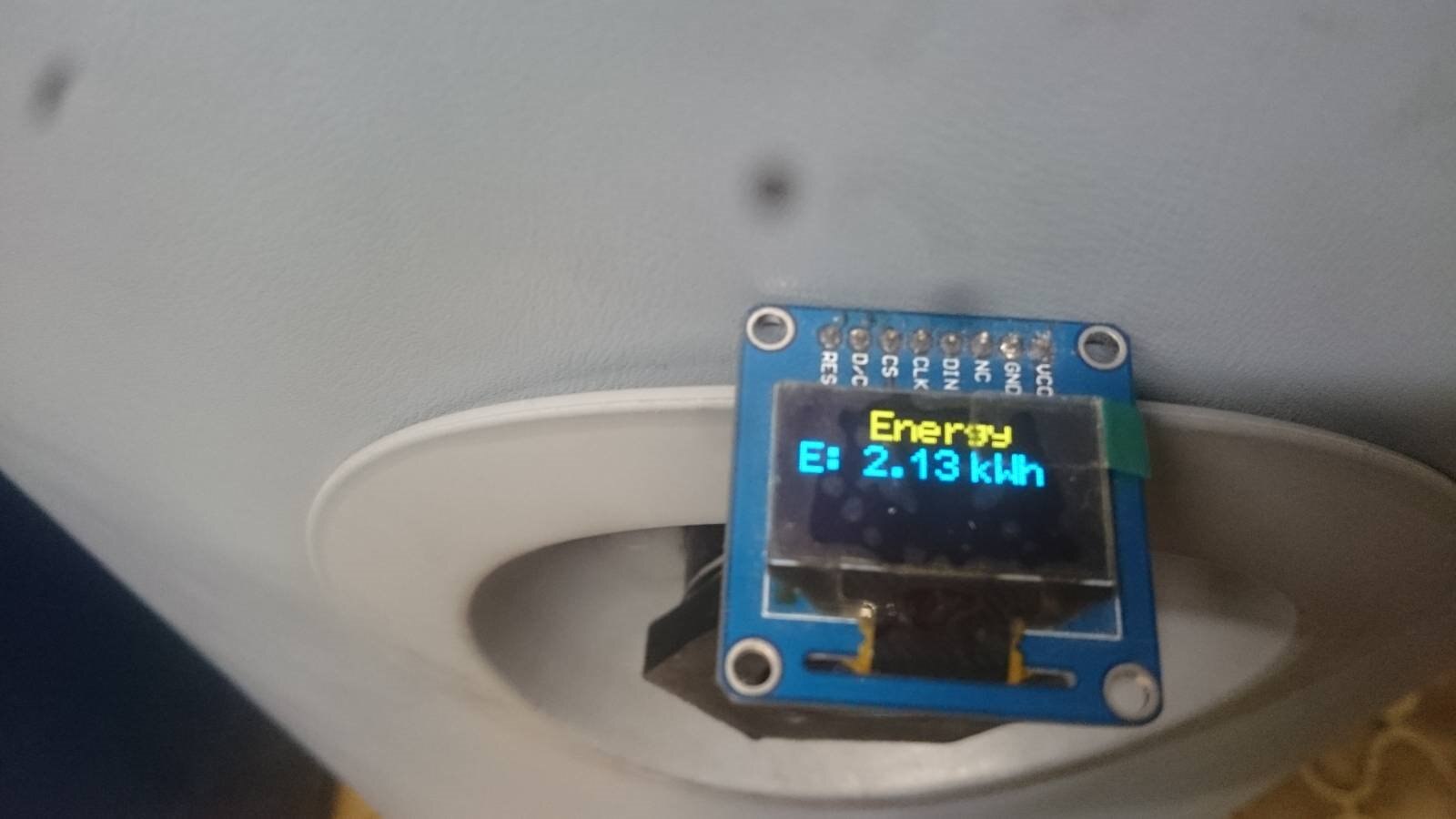

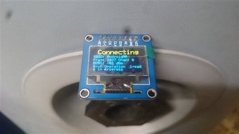

Oled display serves few purposes. One of them is to see diagnostic information regarding connectivity. It would be WiFi network SSID, signal strength and status of connection to Raspberry Pi 3 server.
When connection to server is not present display shows actual error strerror(errno) (string.h) from socket. It works great and description is self explanatory.
Hardware connection to Azure Sphere is also very interesting. On display side it is connected using 8 pin female header, on other side is is connected using USB type A. This way I can anytime unplug my OLED and Azure Sphere from installation and take it at my desk leaving connection cable fixed to water tank.
Other important feature is displaying total Energy generated by photovoltaic panels.
Display is placed on water tank and connected to nearby Azure Sphere. Despite the fact that this place is far from WiFi router, connectivity is good.
It might be thanks to built in WiFi antena on MT3620 chip.
Also displayed screen is changed every 4 seconds so every parameter can be reviewed.

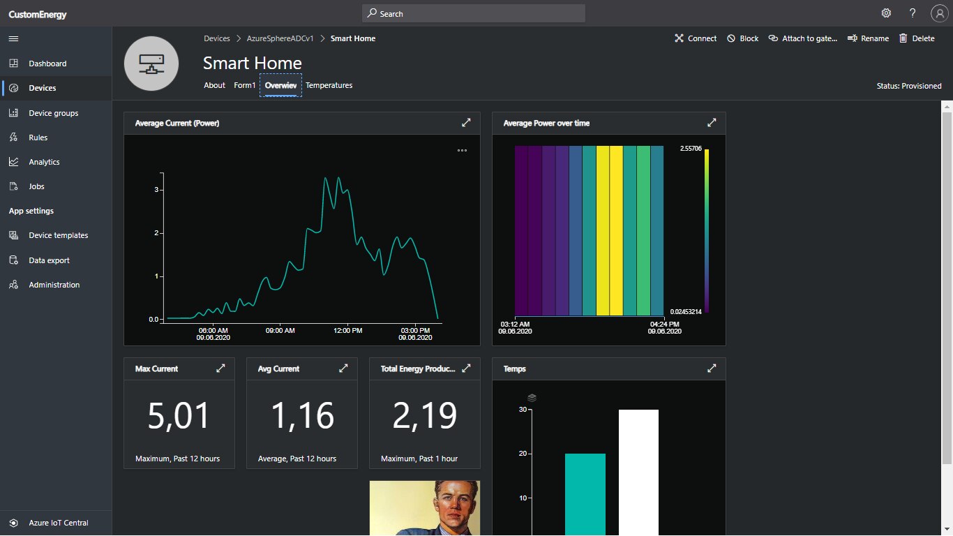

Azure IoT Central is used to store and visualize current (power) value through entire day. It is also collecting total energy value sent from Azure Sphere. Temperatures are sent also and visualied as bar charts.
I have created simple dashboard to monitor current value.
My approach was to just forward scaled and conditioned telemetry value to IoT Central. Rest of processing will be done there. For example I can view custom timeframe of my measurements, change displayed samples interval time despite actual interval with samples are sent to cloud. Drop markers on specific values or time or view data on table instead on chart.
IoT Central allows to analyze energy usage patterns to forecast generation and demand, extreamely usefull when we receive more photovoltaic panes with inverter for power generation. Also it is possible to download data locally as .csv or export data to Azure Blob storage.
On Azure IoT Central I have created Dashboard containing:
On Overview:
  • Line chart showing average current over time. This way i can see how early sun went up or wheter it was cloudy day. It is also very important for diagnostic purposes. If I see that sun is up and it is strong but current produced is not as expected it could mean that panels are damaged or dirty. Ploting current value is also usefull for planing further modernizations or optimization. Panels on my house are placed on the roof at 40 degree angle. This angle can be modified manually. It is extremely important in summer or winter when sun is on different maximal height on the sky depending on season.
  • Maximal Current value. Azure dashboard provides boxes showing KPI. I have choosen max value indicating max current value from 12 hours.
  • Average current value from 12 hours. I have choosen this KPI to see how efective this day is so far or was because average current is proportional to power produced by system.
  • Total Energy value. Cumulated total energy is sent from Azure Sphere every 4 minutes, It is stored in non volatile memory of MT3620, read on every power up and saved every 4 minutes. I think it is one of most important KPIs because it indicates how many energy my panels have poduced overall.
  • Heat map showing Power produced over time. This way i can see which timeframe of the day was most efficient in energy production.
  • Temperatures of water in heat exchanger heated by gas furnance and water in water tank. Bar chart representing this temperatures side by side is extremely efficient.
Like You can see on above screen this was very cloudy day, sun was at its max power at noon, temperature in water tank was higher (gray bar) than this one in gas furnance so pump was not activated.
Power generated was so far 2.19 kW.
