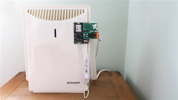

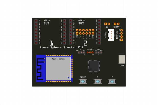

This is where IntlAir comes in, IntlAir is a device powered by the Azure Sphere board which monitors the indoor air quality by reading the TVOC and carbon dioxide levels and turning on the air purifier and/or the fan, respectively. The device also monitors barometric pressure to ensure that the atmosphere is optimum.
This way, any fan system and purifier can be modernised and brought into the age of IoT in minutes, no need to purchase new, expensive systems. IntlAir can significantly reduce the amount of energy used by these devices and provides the user with a comprehensive dashboard and application where they can visualise both the air quality in the home, and when the purifier was running.
This gives the user full control over the data and ensures that the air in their home is always clean. Bring your home into the future with a smart, cost-effective implementation.

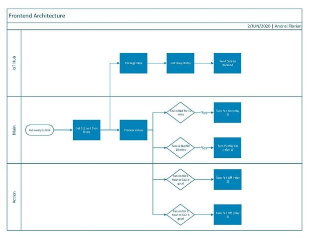

The frontend of the project refers to the device that controls the purification system. The diagram above shows this process. As seen above, the device will turn on every 2 minutes (sleeping in between).
The device will collect the TVOC and Co2 data from the click modules attached and will then process it to see if the values are abnormal. If this is the case, the relay controlling the fan and the one controlling the purifier will be toggled. The device will also pack all this data and send it to the cloud.
Managing the Relays
The system was designed to turn on the fan and/or the purifier until the air is clean. But to prevent the device from running the purifier excessively. It will turn off after 1 hour of running if the air is still not clean.
The device will prevent the purifier/fan from turning on for one hour to let the air in the room circulate and if the air is still dirty afterwards, the purifier/fan will turn on again.

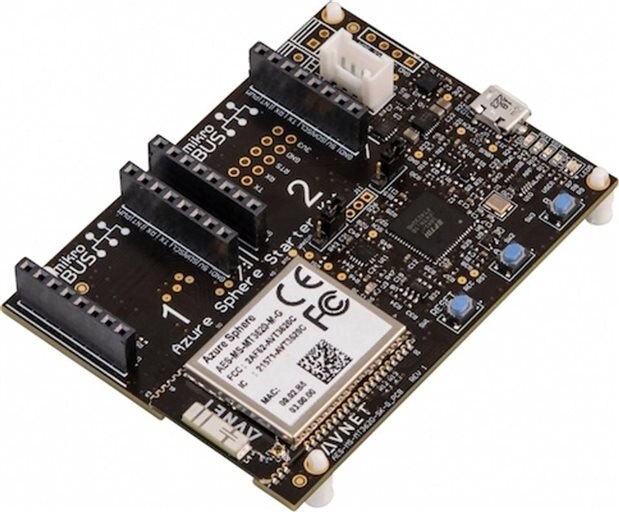

I find the Azure Sphere development board a great device to work with. It is true that it takes a bit longer to get started with it than other platforms but since its debut, support, libraries and tutorials have poured online and now it is easy to prototype an application on the board. Avnet’s iteration is especially great because of the addition of the MikroE bus pins which makes developing so much faster and easier. A shout out to Walter Coan for the great tutorials on Hackster and element14!

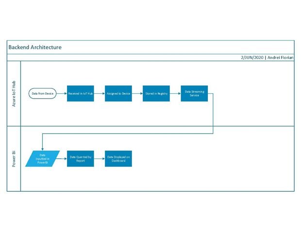

Backend
The backend of the project refers to the cloud infrastructure implemented to deal with the telemetry data sent by the device as well as the Power Bi dashboard which the end user will be able to access from anywhere.
Automatic connection and Integration with the Azure Sphere
The Azure Sphere is limited to connecting to the Azure Cloud which ensures data is sent in a safe environment. I personally use the Azure cloud for my projects, honestly mainly because of the brilliant interface so it is great to see that the Azure Sphere makes the connection easier.

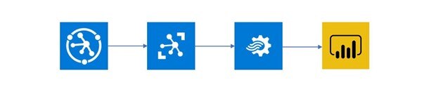

Message Routing
A DPS (device provisioning service) connects the device to the IoT Hub. This feature allows for the connection of thousands of devices if needed without human interference making connection seamless.

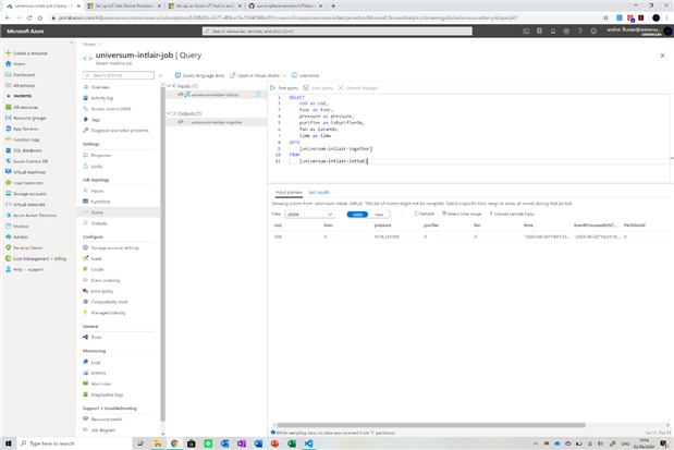

The messages are then placed in the IoT Hub. They are then extracted by a Stream Analytics job and forwarded into a Power Bi dashboard and mobile app. The data is displayed live in the dashboard.

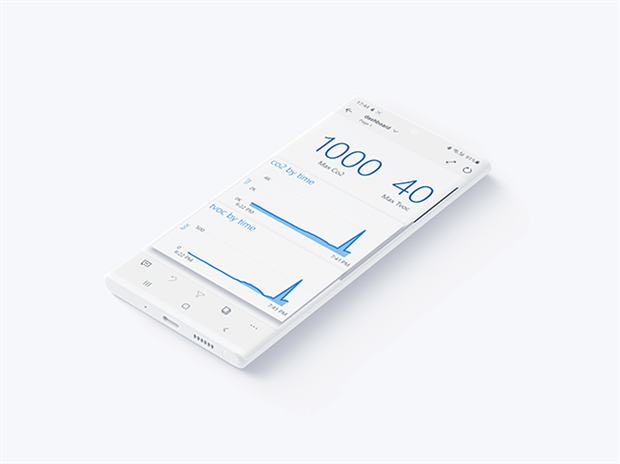

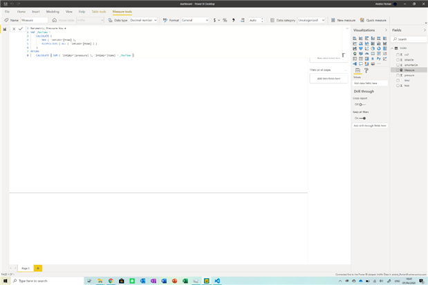

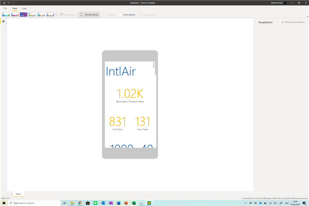

The Dashboard and App
Aesthetically pleasing UI is essential for a modern application targeted at individuals. A dashboard which shows the user all the information they need in an orderly and beautiful fashion is just as important as the data collected by the device.

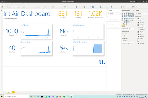

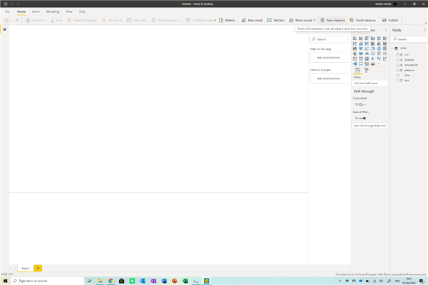

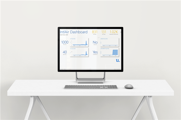

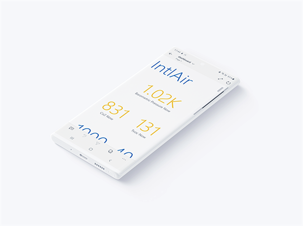

I leveraged the powerful capabilities of Power Bi to develop a stunning dashboard which is available to the user in the cloud so they can see the data from anywhere at any time. I also converted it into a mobile application using Power Bi’s powerful phone layout so that users can carry their data in their pockets being able to check the air quality at work, on the bus, and everywhere in between.
The dashboard shows the user the current levels of TVOCs and Co2 in the home as well as the barometric pressure. This data is also shown on graphs over time. The user can also see within the app if the purifier and/or fan is running even if they are at work putting the data in the user’s hands.

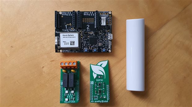

Ok, let us get started by ensuring that we have all the components we need to create this project. Below is the BOM needed. Please make sure that you purchase the correct versions of the MikroE modules.
  • Azure Sphere MT3620 development board
  • MikroE Air Quality Click 4
  • MikroE Relay Click 1
  • Power bank

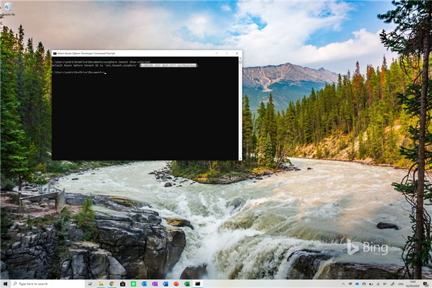

  4. The next thing we will need to do is claim the device to our tenant. You will need to create one first using your Microsoft account. Everything you need is at this link, ensure to read through it all.

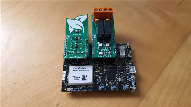

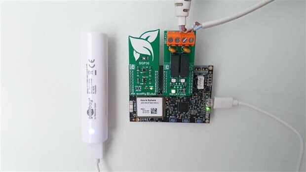

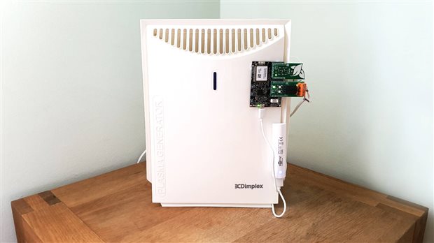

Ok, so the next thing we need to do is get the MikroE clickboards mounted on the device. Well, you just have to attach them on the pins. Make sure that you connect the first socket to the Air Quality click and the second socket to the Relay Click. It should look like this:

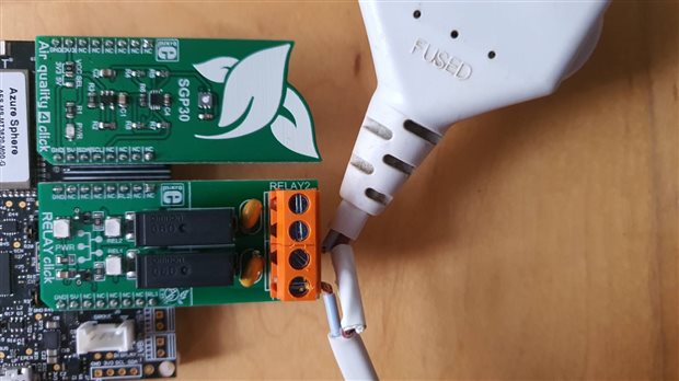

Moving on with the Relay
Now that we have the components ready, we must attach our fan and purifier to the relay to be able to control them. Now there is a small caveat; the devices have to be able to turn on automatically when they are plugged in, the purifier I had used a switch so if I would set it to on, it would automatically start running if I plugged it in. Something like this is needed for the project to work. Please look at the table below to see which devices must be connected to each relay.
Relay 1 – Terminals 1, 2
Air Purifier
Relay 2 – Terminals 3, 4
Fan

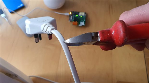

Ok, so we have to cut the power cable running from the plug to the device to reveal the wiring to get started.
Now we will need to connect the ground wires together again but keep the power ones separated. We now need to take the relay click and connect the ends of the power wire to the terminals of the device.
Make sure to insulate the wires after you do this to ensure the safety of the device. Repeat the same process for the fan ensuring that the wires are in the correct place. Once that is done, you are ready to move on.

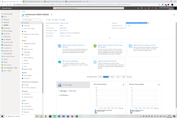

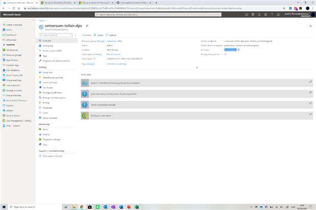

Working in the backend, getting the IoT Hub Ready
For this section, you will need to have a free Microsoft Azure Account. You can get your account for free here and also get $200 credits to get you started.
Please follow the tutorials below to get your IoT Hub, Device Provisioning Service and Certificates ready. It is very important to note that although the tutorial uses the S1 tier IoT Hub, you can use the F1 tier which is free of cost and achieves the same thing in our case.
  1. Use this link to set up your IoT Hub and DPS. Do not do the Cleaning up section at the end.
  2. Finally, follow the tutorial at this link to get your Azure Sphere connected to your hub

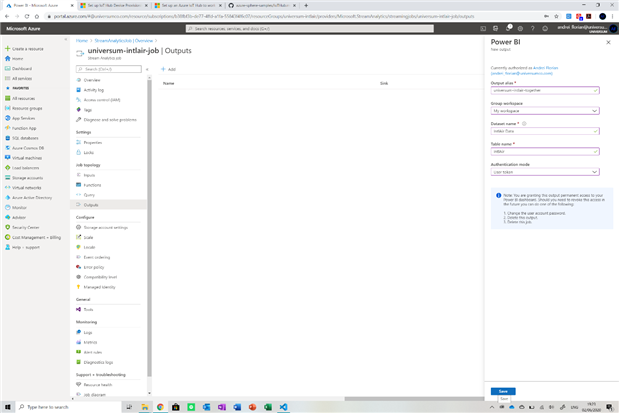

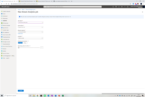

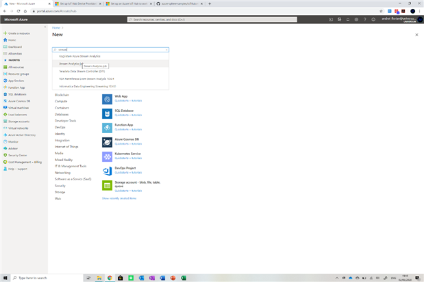

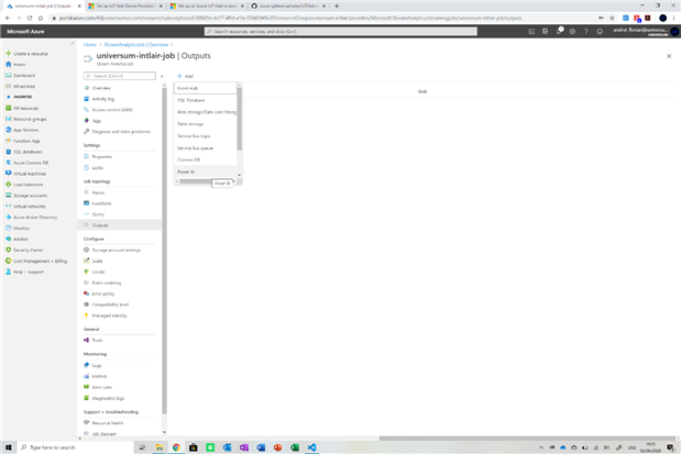

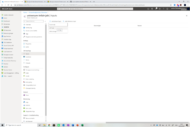

Ok, so if we are going to use the Stream Analytics job, the first thing to do is open our Azure Portal and then navigate to the “create a resource” button in the menu on the left of the screen.
Search for Stream Analytics job and click enter. Now set it up using the following variables. Make sure you select the resource group used in the IoT Hub. Ensure you reduce the units to 1 to reduce the cost.
Now wait for it to deploy and then navigate over to it (pin it to your dashboard if you wish). In the resource’s menu, find Inputs from the item list and click on it.
Now select the IoT Hub option and from the menu, choose the IoT Hub you used. Set the resource name to “universum-intlair-iothub” to prevent having to change the script. Do not change any other parameter. Click save and wait for the connection to test out. Now select the Outputs option from the menu (below inputs).
Select the Power Bi option. It will now prompt you to sign in. Sign in with the Microsoft account you have with a Power Bi subscription. If you do not own a Microsoft Business Account, use this tutorial to create one based on your existing account for free to use this service. After that is done, ensure that all your fields match the ones shown in the image below. Make sure you name the output “universum-intlair-together”.
We are nearly there, now navigate to the Query option (above Outputs) and select it. Now we will have to include the script that will pull the data out of the IoT Hub and push it into the Power Bi dataset. Copy and paste the script below in the field and then click Save Query. Note that if you named your input and/or output something else, you would have to edit the names in the query.
SELECT
    co2 as co2,
    tvoc as tvoc,
    pressure as pressure,
    purifier as isPurifierOn,
    fan as isFanOn,
    time as time
INTO
    [universum-intlair-together]
FROM
    [universum-intlair-iothub]
Great! The last thing we need to do now is start running the job. To do this, go back to the resource’s home page and click the run button at the top of the page. Then select run from now and you are ready to go.

int controlRelays(void) // code to turn relays on and off
    if (isRelayTvoc) // if the relay is on
        loopNumberTvoc++;
        Log_Debug("loop tvoc %d \n", loopNumberTvoc);
        if (loopNumberTvoc > 29) // if 1 hour passed since the relay was on
            loopNumberTvoc = 0;
            isRelayTvoc = false;
            isRelayTvocBlocked = true; // block for 1 hour
            // turn relay off
            relayTvoc(false);
        if (tvoc_goodCount > 4) // if air was clean for 10 mins
            loopNumberTvoc = 0;
            // turn relay off
            relayTvoc(false);
    else
        if (tvoc_badCount > 4) // if air was dirty for 10 minutes
            if (isRelayTvocBlocked)
                loopNumberTvoc++;
                if (loopNumberTvoc > 29) // blocked for 1 hour
                    isRelayTvocBlocked = false; // unblock
            else
                isRelayTvoc = true;
                loopNumberTvoc = 0;
                // turn relay on
                relayTvoc(true);
    if (isRelayCo2) // if the relay is on
        loopNumberCo2++;
        Log_Debug("loop co2  %d \n", loopNumberCo2);
        if (loopNumberCo2 > 29) // if 1 hour passed since the relay was on
            loopNumberCo2 = 0;
            isRelayCo2 = false;
            isRelayCo2Blocked = true; // block for 1 hour
            // turn relay off
            relayCo2(false);
        if (co2_goodCount > 4) // if air was clean for 10 mins
            loopNumberCo2 = 0;
            isRelayCo2 = false;
            // turn relay off
            relayCo2(false);
    else
        if (co2_badCount > 4) // if air was dirty for 10 minutes
            if (isRelayCo2Blocked)
                loopNumberCo2++;
                if (loopNumberCo2 > 29) // blocked for 1 hour
                    isRelayCo2Blocked = false; // unblock
            else
                isRelayCo2 = true;
                loopNumberCo2 = 0;
                // turn relay on
                relayCo2(true);
This final function will check to see if the relays should be turned on and if they should be turned off.

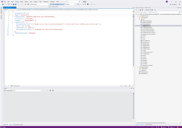

The first thing we must do is open the Azure Sphere command prompt. This is done by pressing the Windows button and typing azsphere. Make sure you are signed in with your account and the correct tenant is selected. Type the following command to get your tenant ID.
Azsphere tenant show selected
You should see something like this in your window. Copy the tenant ID that is displayed and go to your code. Paste it in the DeviceAuthentication field. Now navigate to your Azure Portal and open the IoT hub the device is connected to. Copy and paste the hostname field on the main page into the AllowedConnections filed in the application manifest.
Finally, navigate to your DPS and copy and paste the ID Scope field displayed on the main page into the CmdArgs field in the application manifest. You are now ready to go!

Now that all of that is done. We must flash the application to the device. Connect the Azure Sphere device to your PC and then select the HighLevelCore from the flash options and click the run application button in the Visual Studio IDE.
Now before you use the product for distribution, please follow this tutorial to get the application running on the device in release mode.
Mounting Everything
For the sake of this prototype, I did not create a case or enclosure for the device. In most cases, the device can be hid away somewhere, I decided to put it behind the air purifier But you could put it somewhere on the wall if that’s better, probably if you do enclose it.
Finally, let’s work on the dashboard!

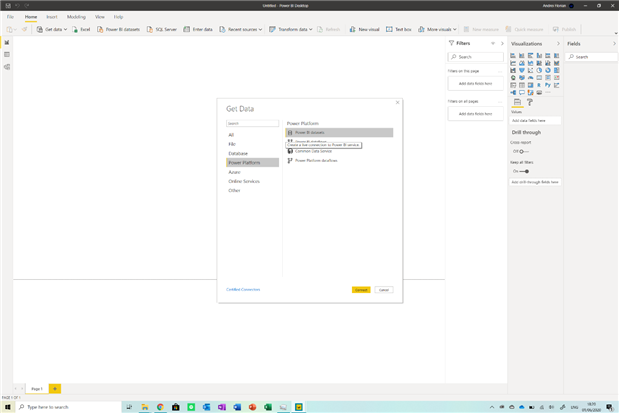

The last thing we need to do is get the dashboard ready to go. The first thing we need to do is open the Power Bi app (get it on the Windows store if you do not already have it, you can also use the web app). Create a new report and click on the Get Data button.

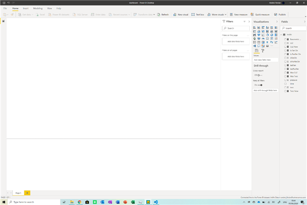

Navigate over to the Power Platform and then select Power Bi datasets. Now simply select the dataset we have (make sure you ran the code for a while before, so we have data available). The data should now be ready to go. Ok, on to the frustrating part, we now have to create a dozen measures or so for the project. I will guide you through making one and you will have to repeat the process for the rest. To get started, make sure you have the expressions folder open (from the GitHub repo you downloaded earlier). You will see a dozen or so expressions there, we need to create new measures based on those scripts.
In Power Bi, navigate to the menu bar at the top of the screen and select the New Measure button. This should create a new measure and give you a text box. Now open any one of the files (you can open them in VS code or a lightweight editor) and copy and paste the content into the box.
Ok, so now repeat this process for all the values, do not worry if errors appear, once you do not edit the scripts, everything should be fine at the end. After you added all the scripts, your report should look something like this:
Now we can get to the fun stuff, this link from Power Bi will show you how to get started with creating stunning visuals on the platform. This is my product:
Now click on the View option from the top nav bar and select mobile layout. Drag and drop the graphs and text onto the phone frame to create a mobile version of the dashboard. Mine looked like this:
Ok, so finally go back to the home page on the app and click on the Publish Report button from the options. This will publish your dashboard to the web allowing you to access it from anywhere. Just log into Power Bi and you should see it there. That is it, we are done!
Make sure to get the Power Bi app, it is available on Google Play and the App Store.

    dubbie over 6 years ago

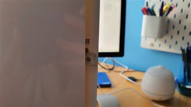

    An interesting project. I'm a bit concerned about the safety of how you connected the mains. Maybe that bit might be better inside a box.
    Dubbie
  • andreiflorian
    andreiflorian over 6 years ago in reply to dougw
    hi Douglas,
    I have not added the specifications of the purifier because the project can be implemented on virtually any existing purifier that fits the specifications described in the project (turns on when plugged in).
    The purifier that I used is the DC Dimplex dxapv3  https://www.dimplex.co.uk/product/air-purifier-hepa-and-active-carbon-filter-viro3-technology.
    Thanks a lot,
    Andrei.
