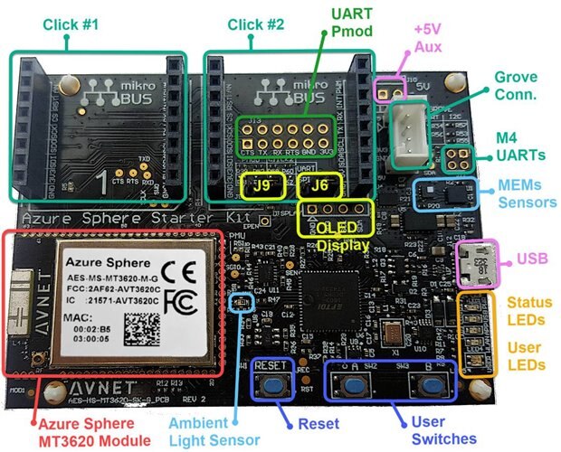

Physical Changes
These graphics identify all the different locations on the board for expansion connectors, buttons, LEDs, sensors and so on.  If you are familiar with the Rev 1 board you may notice the following physical changes . . .

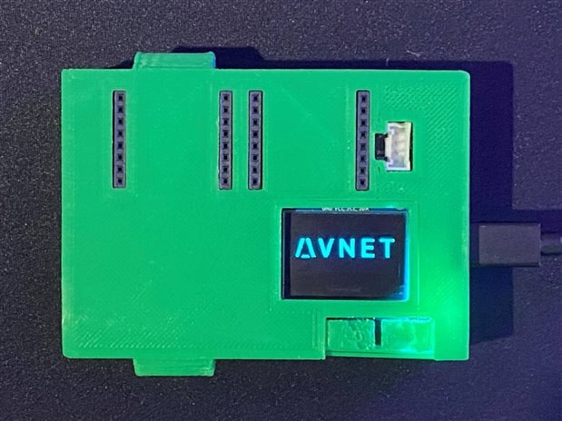

  • The OLED Display (unpopulated) header was moved from the edge of the board to the center of the board and rotated 90 degrees
  • The M4 debug UART TX header was moved from the center of the board to the edge of the board
    • The M4 debug UART header now contains two GND signals, one for each M4 core
  • The (unpopulated) external power header only has a +5V connection, the +VBAT connection was removed from this location

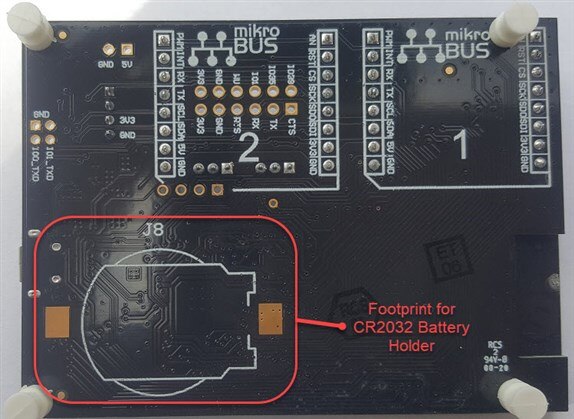

  • A (unpopulated) CR2032 battery holder footprint was added to the bottom of the board to supply the +5VBAT power
A Rev 2 board with the OLED soldered to the new location in a 3D printed case

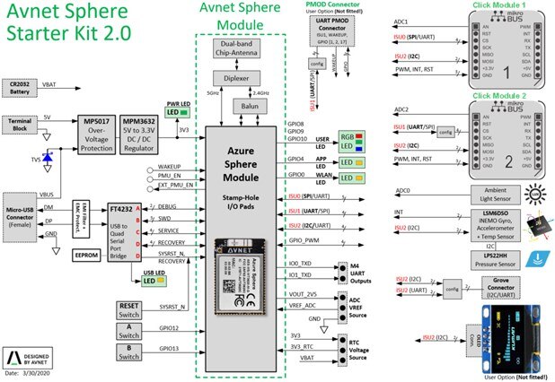

Block Diagram

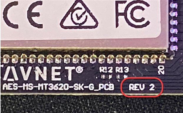

How to identify which Revision you have
The Rev 2 board is marked as such.  Look for the silkscreened text under the Avnet Azure Sphere Module

There were quite a few enhancements/features added between Rev1 and Rev 2.  For the nitty gritty details, please reference the Hardware User Guide, all the changes are documented there in great detail.  You can find the Hardware User Guide here. (Select the "Technical Documents" tab, then scroll down to the "Azure Sphere MT3620 Starter Kit - V2" section)
CategoryEnhancement or New Feature
Use case enhancements (Click sockets)
  • ISU0 (SPI/UART) is dedicated to Click socket #1
    • Supports using the ENC286J60 SPI interface via ISU0 and GPIO5
    • Supports the ETH Click board
  • ISU1 (UART/SPI) is dedicated to Click socket #2
    • Added type 4A UART support (TX, RX, CTS, RTS)
    • Supports the BLE 8 Click board
  • ISU2 (I2C) is shared by both Click sockets and all I2C peripherals on the PCB
Use case enhancements (Pmod connector)
  • Default configuration supports type 4A UART (TX, RX, CTS, RTS)
  • Pmod connector can be reconfigured for type 2A SPI (set via zero-ohm resistors)
  • Avnet BLE Pmod add on board supported
Use case enhancements (Grove connector)
  • Default configuration supports Grove I2C interface
  • Grove connector can be reconfigured to support two wire UART interface (TX, RX) (set vis zero-ohm resistors)
Sphere module enhancements
  • Updated Avnet Azure Sphere Module Rev 2 is used on the board
    • Additional ISU2 pins available to support SPI and UART use cases
    • Pull up resistor change ensures that Power down mode can be entered
Power Supply robustness enhancements
  • MP5017 device replaces MP5018
    • Allows for additional margin for voltage drop across some USB cables/connectors
  • MPM3632 device replaces MPM3822
  • Additional improvements to ensure power input quality and protection
Wi-Fi LED GPIO reassignment
  • GPIO0 now drives LED4 (Wi-Fi LED)
  • Replaces GPIO5 that is required to support ethernet board configuration file on Click socket #1
VBAT changes
  • HW implementation now matches Microsoft's revised VBAT selection circuit
  • Option to add Lithium CR2032 coin-cell battery holder to bottom of board
OLED display moved to center of PCB
  • The optional OLED header was relocated to the center of the PCB
M4 UART headers moved to edge of PCB
  • Header pins for dedicated M4 core UART outputs are now easier to access at the edge of the PCB
