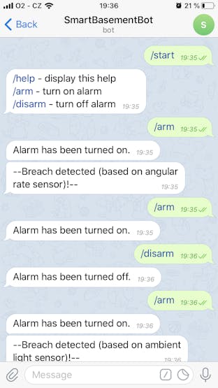

So if at least one sensor detects important change (higher than some threshold), device starts alarm - it sends notification to my phone via Telegram Bot.
Remote control + alarm notifications via Telegram

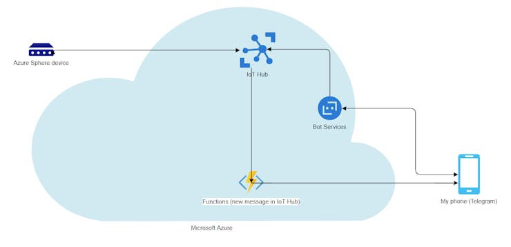

Solution Design
Architecture
Sphere SDK provides simple APIs to Microsoft Azure services. Device communicates with IoT Hub (which cares about device management) and message routing (bi-directional - cloud-to-device & device-to-cloud).
SmartBasement architecture overview
SmartBasement project architecture
Azure Bot Services is kind of WebApp - which provides all needed integrations and webhooks needed by Telegram's API. This part allows to communicate from phone to device (via IoT Hub), but not the other way.
That's why I have in solution also Azure Function service, which provides native IoTHubTrigger (when is new message in IoT Hub detected, it will call your code) - this will cover also a scenario "send notification when breach".
Important advantage of this solution (with my current needs) is cost - it costs $0 per month, because all used services run on Free tier.

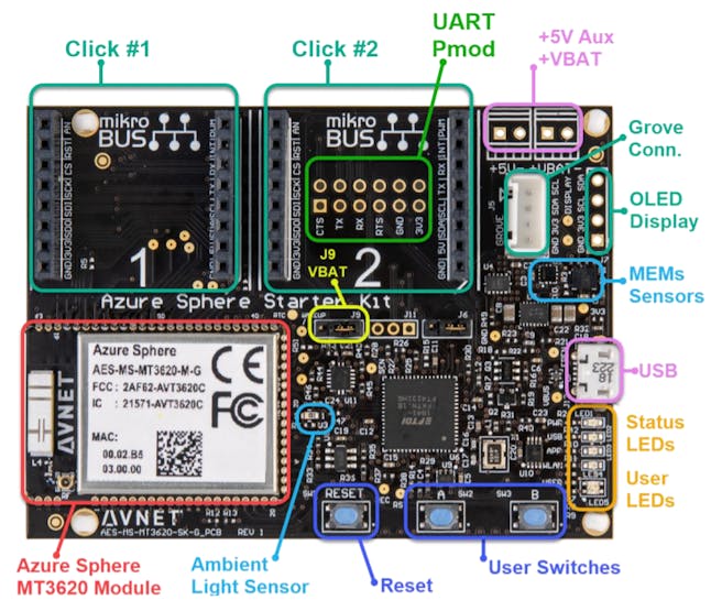

Peripherals (Sensors, Button, LED)
Azure Sphere MT3620 Starter Kit board
On-board Ambient light sensor - is connected via ADC, and on Starter Kit is directly connected to ADC0 (diagram).

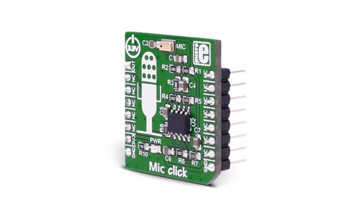

Microphone - I used MikroE's Mic Click module for MikroBUS. MikroBUS allows you to connect module without wiring anything, you just click module into socket on board. Starter Kit has two sockets, Click #1 (socket #1) is connected to ADC1, Click #2 to ADC2. To protect your board, you have to do small wiring - because of Mic Click module has reference output voltage up to 3.3V, board is designed for maximum input voltage only 2.5V. You need to add 300KΩ resistor between module and board.
Mic click (MikroBUS socket)
On-board accelerometer+ gyroscope sensors - are connected via digital I2C interface, on ISU2 port.

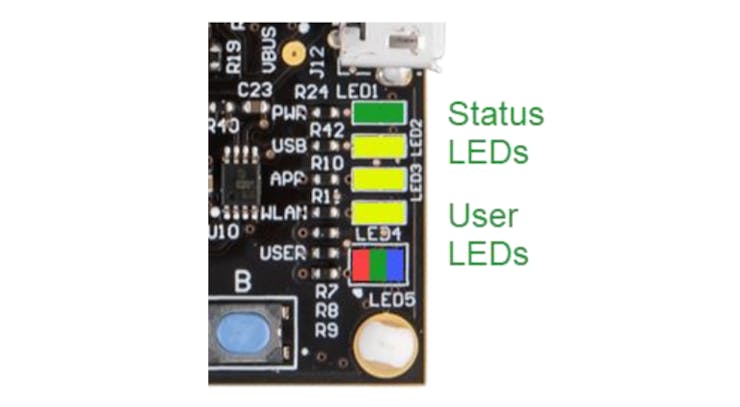

UserLED - is connected via GPIO ports. For every color (RGB) there is GPIO port - ports GPIO8, GPIO9 and GPIO10, so you can mix them.
In this project I am using user LED for indicate device status:
- permanent blue=armed- blinking blue=waiting 10 seconds to arm- permanent red=something went wrong
In the code you can easily control user LED via method:
void setNewLEDStateRGB(bool isRedOn, bool isGreenOn, bool isBlueOn);
Button A - is also connected via GPIO port, on port GPIO12. In this project is used for arming alarm manually (when you click this button, device will wait 10 seconds and arm alarm - to give you time to leave the basement).

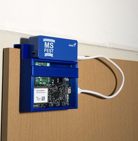

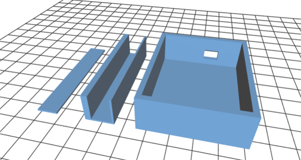

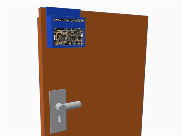

Mounting To Doors (3D Printed Case)
I prepared mount case to be printed on 3D printer - it has space for microUSB connector + powerbank can be put on the top. Because the doors are moving, I also added top piece to secure device from falling-down from case (there is space from top, because we don't want cover the microphone chip).
Instruction for assembly - glue middle component with right one (biggest one) together - on the middle component use the stronger edge and on the right component use back top edge (hole for USB should be on right bottom). After inserting the board inside, glue with smallest part on the top (be sure you not cover sensors on MikroE board).
Testing
I mounted device on doors with powerbank (powerbank is secured against falling down by 3M sticker).
Smart Basement deployed with powerbank (secured by 3M)

demo - alarm is armed (permanent blue LED) and door opening is detected and notification sent
