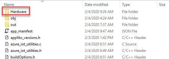

Include the Hardware specific files in your project
  • If you don't already have the Microsoft examples, clone the Microsoft Azure Sphere GitHub Project.
  • Copy the Hardware directory to your project directory
    • You can choose to include a common Hardware directory in your directory structure.  I like to include this directory inside my project directories.  I share my projects and it's easier to share when I package all the required files together.
    • I add my Hardware directory to the same folder where all my source files are located.  You're free to add the Hardware directory anywhere you wish.

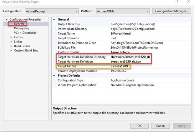

Next we need to tell Visual Studio about the Hardware directory.
  • Open your Visual Studio project in Visual Studio
  • Use the shortcut keys <ALT> + <Enter> to bring up the project properties page
  • Fill in the "Target Hardware Definition Directory" and "Target Hardware Definition" fields
    • I'm using the Avnet Azure Sphere Starter Kit so I specify that folder and definition file
    • If you placed your Hardware directory somewhere else in your file system you need to adjust the path to reference the location of your directory
    • If you're using a different hardware platform, then specify the folder and Hardware Definition file for your platform
  • While you're in this dialog make a note of the "Target API Set."
    • Actually screen shot this window, we'll need this detail for our CMake project

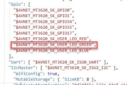

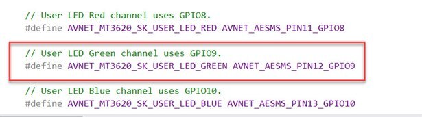

  • Using the *.h file from your <Target Hardware Definition Directory>/inc/hw/ folder, find the #define for each resource you reference in the app_manifest.json file.  Add the string identifier to the app_manifest.json file with quotes and a '$' like this: "$<my identifier here>"
For example: My app_manifest.json file included a 9 for the GPIO to drive the Green LED on the on-board RGB LED
I used the definitions found in avnet_mt3620_sk.h:
And updated my app_manifest.json file as shown below:
Once you update all the constants in your app_manifest.json file you should be able to build and run your Visual Studio project.

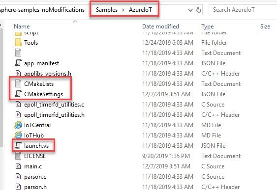

Add CMake specific files
We need to add three different CMake files to our project.  My recommendation is to pull the current Microsoft Azure Sphere GitHub Project as a starting point.
  • Clone the Microsoft Azure Sphere GitHub Project
  • Open the <project folder>/Samples/AzureIoT folder
    • Copy CMakeList.txt, CMakeSettings.json and launch.vs.json to your project folder

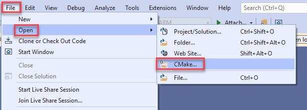

  • Launch Visual Studio
  • From the pull down menus File --> Open --> CMake...
  • Navigate to your project file and select the CMakeLists.txt file you just copied there

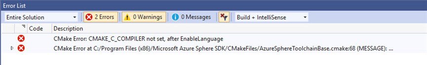

  • The project will open and CMake will try to generate the build script.  It will fail as shown below.  Don't worry about that, this is expected and will happen until we get the CMake files tuned up
Note: Anytime you want to regenerate the CMake project, just change and save your CMakeLists.txt file.  I just add a space somewhere and save.

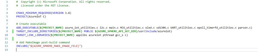

Edit CmakeLists.txt
  • From inside Visual Studio, open the CMakeLists.txt file
  • Update the ADD_EXECUTABLE(${PROJECT_NAME} line
    • Find all the *.c files in your project and list them on this line
    • Use " " spaces between the file names

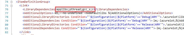

  • Update the TARGET_LINK_LIBRARIES(${PROJECT_NAME} line
    • Open the *.vcproj file in the Visual Studio editor and find the <LibraryDependencies> line
    • Copy the list of dependencies and paste it into your CMakeList.txt file
      • Note you need to remove the ';' separators

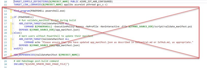

Remove section about POWERSHELL and validate_manifest script
This CMakeList.txt file that we started with is a great start because it's for the AzureIoT example and let's face it; If you're developing an Azure Sphere application, it's more than likely going to be connected to Azure.  But, this CMakeList.txt file adds checks to make sure we've updated our app_manifest.json file for the actual AzureIoT example.  We don't need that section.  Use the graphic below to identify and remove all the lines inside the red box from your file.
My final CMakeList.txt file

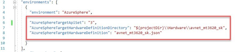

Edit CMakeSettings.json
We're almost finished.  The last thing we need to do is tell CMake about our TargetAPISet and our Hardware definitions.
  • From inside Visual Studio, open the CMakeSettings.json file
  • Click on the "Edit JSON" link at the top of the display
  • Refer to the screenshot you took of your Visual Studio Project properties page and modify the three lines inside the "environments" object shown below.  Make sure you use the settings from your Visual Studio project page that worked earlier.

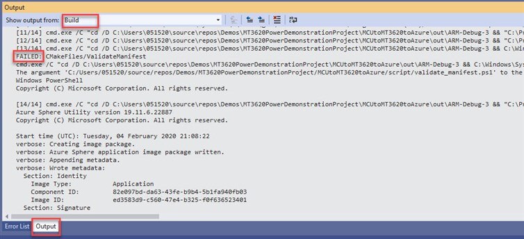

Build and test our project
Hopefully you can now build and test your application.  If things don't work navigate to the "Output" output tab to look for hints.
