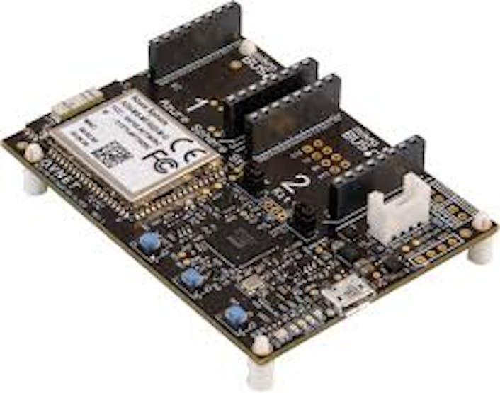

Platforms like Azure Sphere are designed to provide end-to-end security and can revolutionise the voting process. This project describes demo solution of the voting machine, based on AvNET Azure Sphere MT3620 Starter Kit.
Right now, it allows you to say only “yes” or “no” by pressing built-in user buttons. However, thanks to MikroE click boards extension, it can be easily converted into real voting machine which can also verify uniqueness of each voter, e.g. via biometric finger print reader or using NFC reader to read the cheap of his / her ID.

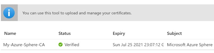

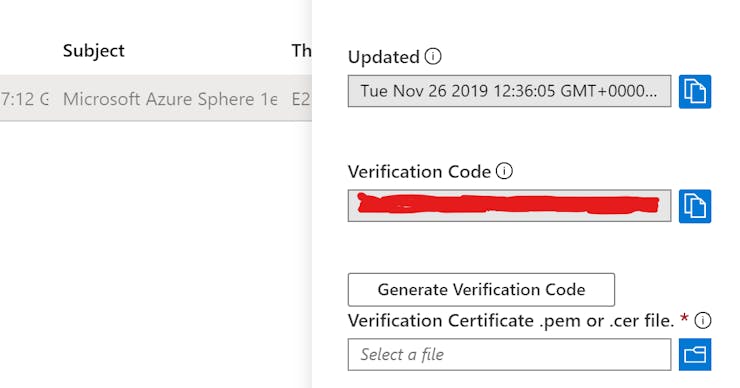

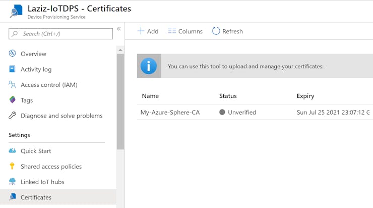

3. In Azure portal, upload certificate to Azure IoT DPS -> Certificates. After upload it will show new entry with an “Unverified” status.
4. Then open certificate record and click “Generate Verification Code” button.
5. In Azure Sphere Developer Command Prompt, download validation certificate signed with the DPS verification code from Step 4 above using the following command:
azsphere tenant download-validation-certificate --output ValidationCertification.cer --verificationcode <DPS_VERIFICATION_CODE>
You should see confirmation that the validation certificate has been saved.
6. In Azure portal, upload validation certificate into “Verification Certificate” field of the record window from Step 4 and click “Verify” button. After validation, Azure will change the status of your certificate to “Verified”.

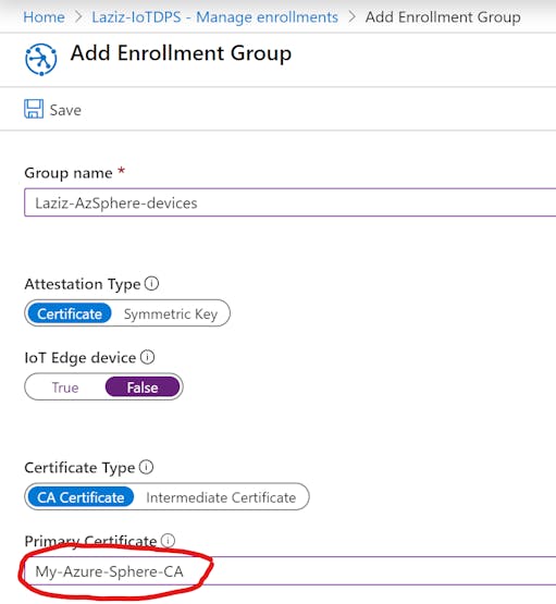

7. Switch to Azure IoT DPS -> Manage Enrollments menu and add new enrollment group with the primary certificate that we verified in Step 6 above.

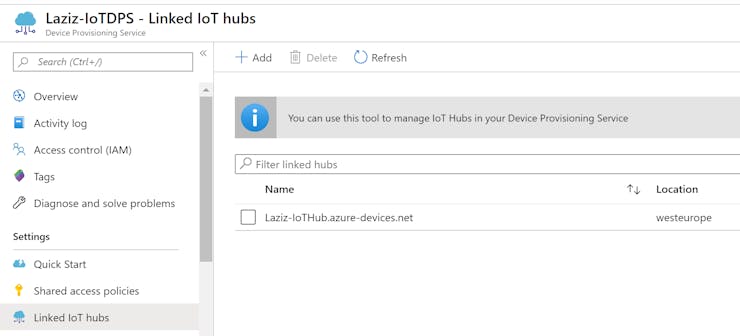

3. From Azure IoT DPS -> Linked IoT Hubs copy the full name of the linked IoT Hub.

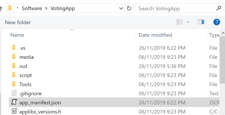

5. In Visual Studio, click File -> Open -> CMake, navigate to the repo’s Software -> VotingApp and then open app_manifest.json file.
6. Update placeholders highlighted in the screenshot below with the values of your Azure Sphere tenant’s ID, DPS ID Scope and IoT Hub names collected in Steps 1, 2 and 3 above.

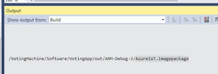

7. Select CMakeLists.txt file and then click Build -> Rebuild Current Document (CMakeLists.txt). Verify that an image package is being generated as shown below.

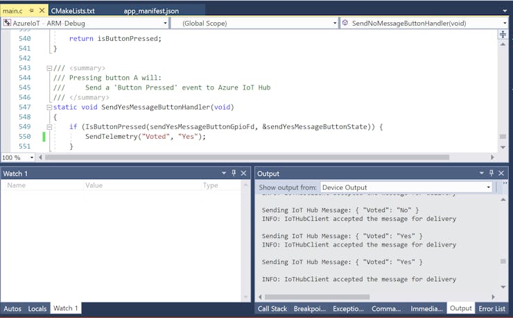

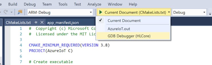

8. In the toolbar, choose “GDB Debugger (HLCore)” as the target.
9. In Azure Sphere Developer Command Prompt, enable application development capability on Azure Sphere device:
azsphere device enable-development
10. Back in Visual Studio, click Debug -> Start (or press F5) to deploy Voting Machine app to the device. If successful, Visual Studio will execute Voting Machine app on Azure Sphere device. In Output window, choose “Device Output” option. If you will press any of 2 buttons, you should see the message updates in the debug window.

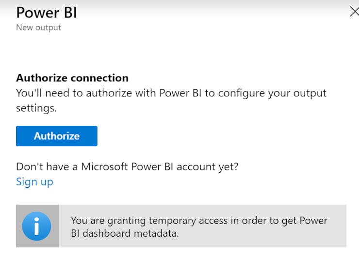

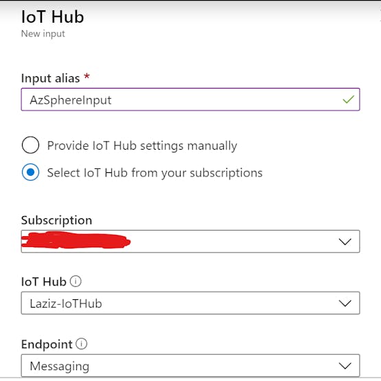

Analytics configuration:

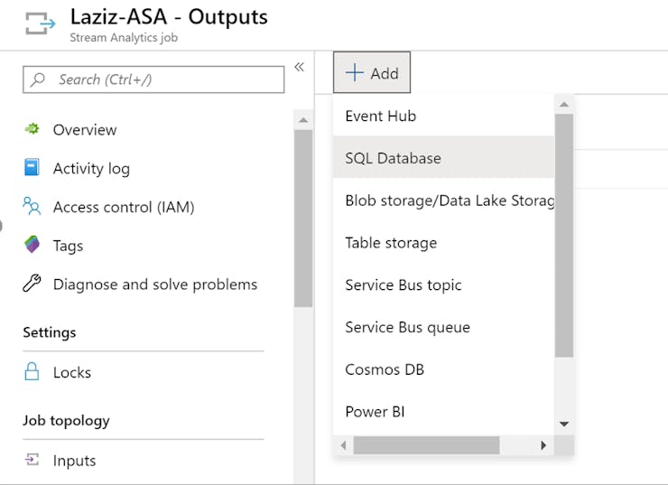

1. In Azure, create new Stream Analytics job and add IoT Hub as its stream input

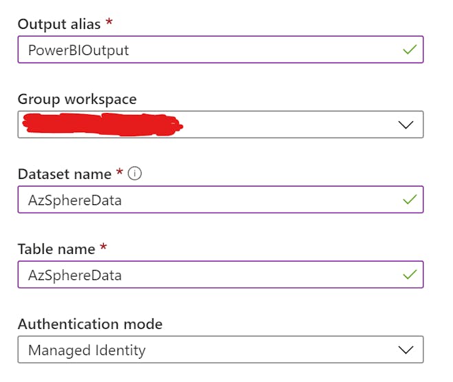

2. Add PowerBI as the output for Stream Analytics job and click Authorize.
3. Provide relevant output alias name, so that you can use it in the Stream Analytics query.
4. Alternatively, you can setup Azure storage account or a database as an output for Azure Stream Analytics job.

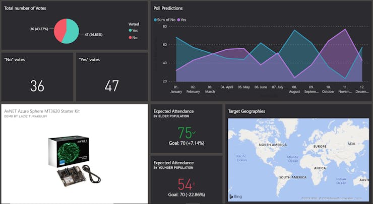

5. Last step is to visualise your data in the PowerBI dashboard. You may configure it online directly at https://powerbi.microsoft.com or use richer functionality with offline PowerBI desktop client. This is an example of my PowerBI dashboard, which combines historical data from the database with the live stream from the Azure Sphere device.

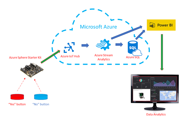

High-Level Design:
The following diagram shows the main components utilised in this project.
