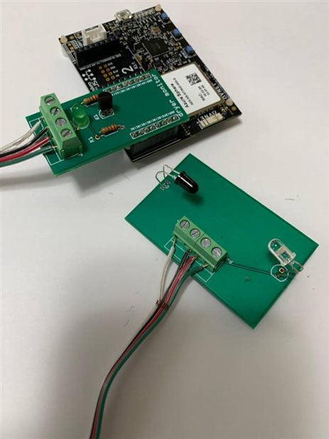

Here is a picture of the completed system outside its case, showing the custom mikroBUS board and remote sensor I developed for this contest:

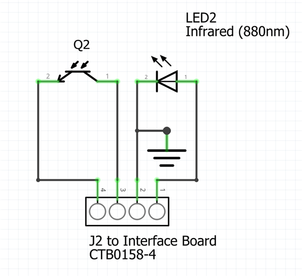

    2. And thus I could sense lint build up with an obscured transmissive photo interrupter!
      1. When the receiver senses no light, the lint has built up between the LED and its sensor.
      2. This method directly senses lint.
      3. I could build a simple circuit with an LED to indicate when lint has built up.
        1. IR LED to IR Phototransistor over air driving an LED

Integration of the IR Circuit and the Azure Sphere Starter Kit
  1. Hardware

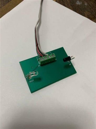

    1. The MikroE Opto Encoder Click module supports one opto encoder.  Perfect.
    2. However, this Click module must go inside the dryer hose. That means you have to put the module, and the Azure Sphere Starter Kit in the dryer hose. This won’t cut it.
    3. image

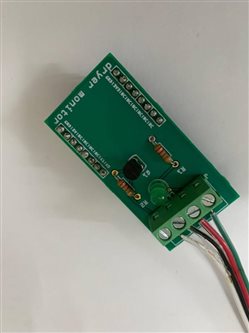

    4. There are hundreds of Click mikroBUS boards out there, but none that suited my needs directly: I needed a simple LED and sensor board.  I couldn't find one that had a remote sensor wiring point.
    5. I built my own mikroBUS board and deployable IR sensor board. Notes:
      1. The mikroBUS standard is easy to use.
      2. Click modules names are trademarked so I did not build a Click module, I built a mikroBUS-compatible module. Also, I fought with Fritzing for a while to get the mikroBUS logo on the board, but I had to give up. I'll figure this out in future iterations.
      3. I built two boards for this project:
      4. mikroBUS interface module
      5. image
      6. Remote sensor module
      7. image

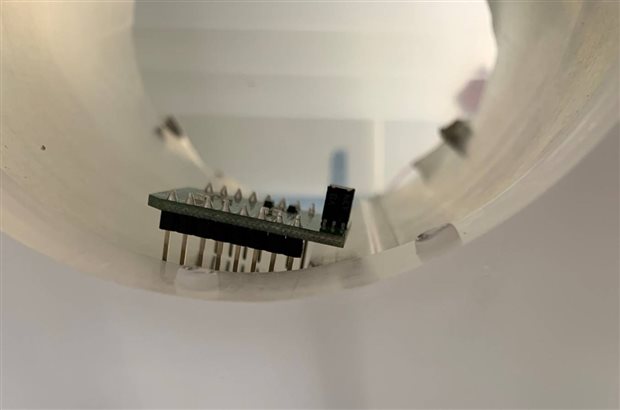

  2. One deployment model is for inside the apartment:
    1. I made a cylindrical section of aluminum sheet configured such that a dryer hose could slide over it.  This forms a dryer hose “interstage” so that the sensors could be placed inside it. This would let me secure the Transmissive Photo Interrupter Sensors and further ensure I could sense what I wanted.
    2. The interstage should be connected between the dryer and the dryer hose.
    3. image

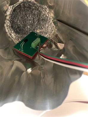

  3. Another deployment model is for outside the apartment, and is shown installed here by my own house.
    1. A weatherproof case is attached outside the wall and where it can get power.  The US National Electric Code requires this appliance to have a separate circuit because it is permanently installed.   Apartment complexes have multiple dryer exhaust vents together, so one device can monitor several dryer hoses for lint.
    2. The deployable sensor is shoved right into the hose outlet.  It will collect lint inside there and eventually, the sensor will telemeter the fact that the hose requires cleaning.

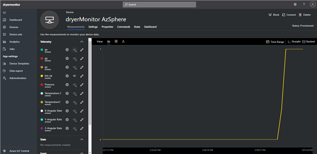

I created an Azure IoT Central application that receives and displays the dryer monitor lint telemetry. As part of the application, I created an alarm for when either or both lint sensor types declare there is lint. The below screenshot shows the activity going from "dirty" to "clean" because the lint_ok message changes from 0 to 1.   Apartment managers would see this when their cleaning crews perform their activities.
I wrote and updated an Azure Function to receive and log the dryer monitor lint rule result payload.

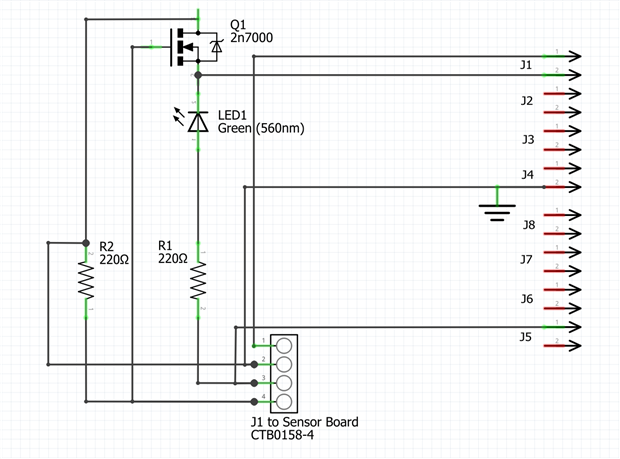

Schematics
Interface Board Schematic:
Sensor Board Schematic:
