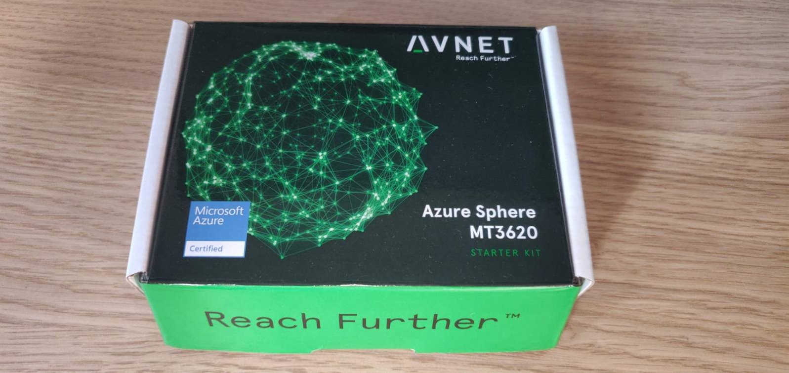

Hardware

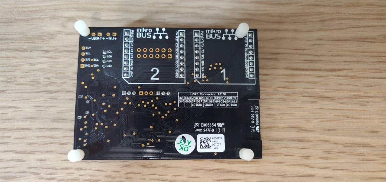

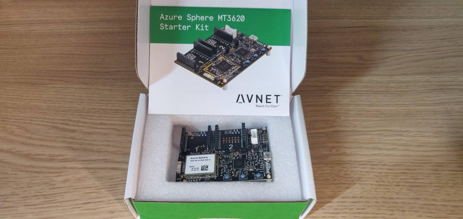

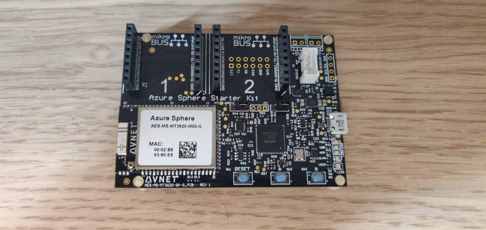

Avnet MT3620
So we talked about the contest, but how does our device actually look like? Well when I received it, it looked like this fresh out of the box:

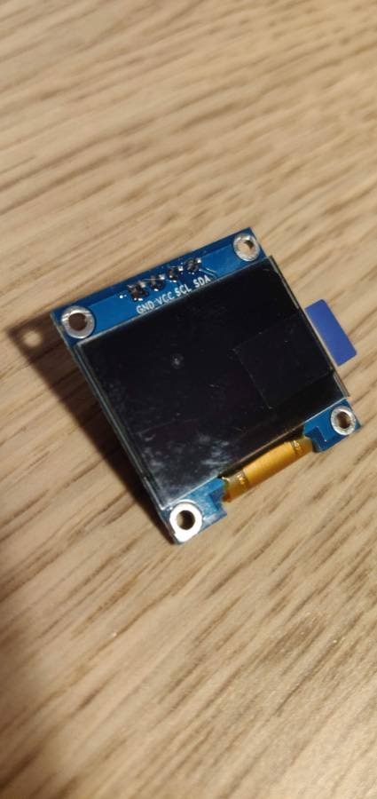

OLED Screen
For our OLED screen I bought an IZOKEE 0.96" I2C IIC SPI Serial 128x64 px display

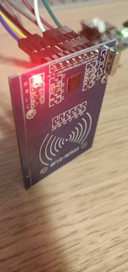

Connecting the RFID Scanner
Since we learned what the SPI interface is, we can now connect our RFID scanner. For that just connect the corresponding pins on the RFID scanner with the ones on our devkit as shown here. For this we look at the SPI details in the datasheet on page 9. Here we find the following:
PINUART(input)SPI (output)I2C-bus (I/O)
SDARXNSSSDA
I2C001
EA01EA
D7TXMISOSCL
D6MXMOSIADR_0
D5DTRQSCKADR_1
D4--ADR_2
D3--ADR_3
D2--ADR_4
D1--ADR_5
Where we see that for SPI we need to utilize NSS, MISO, MOSI, SCK on our development board, which refer to SDA, MISO, MOSI, SCK on the RFID scanner. Once connected, we will have this:
Drawing this out, we will get:
RFIDDEVICECOLOR
SDACSGREEN
SCKSCKPURPLE
MOSISDOGREY
MISOSDIWHITE
RQ--
GNDGNDBLACK
RSTRSTYELLOW
3.3V3V3BLUE

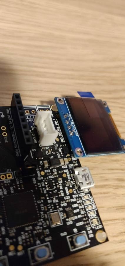

Connecting the OLED screen
The OLED screen is quite straightforward for our project, seeing that it's the one as shown on page 22 in the datasheet. It has the following pin connectors:
Grove Pin #Signal NameSignal Name
1GNDGND
23V33V3
3SCLGPIO37_MOSI2_RTS2_SCL2
4SDAGPIO38_MISO2_RXD2_SDA2

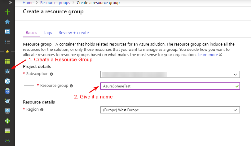

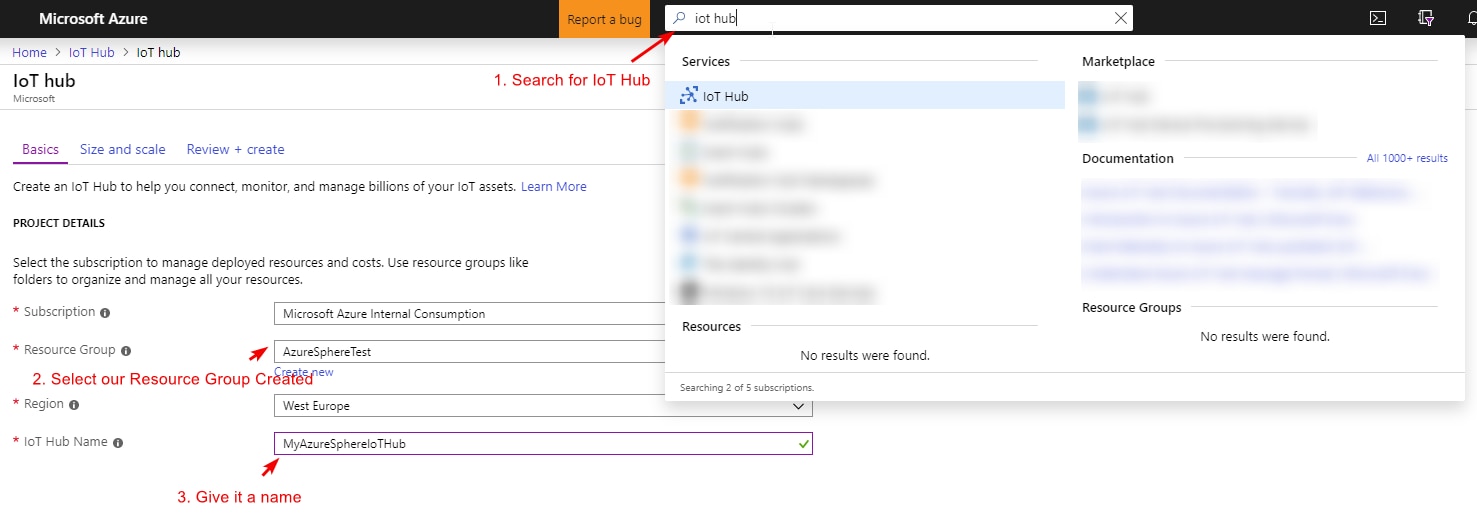

To be able to connect our device and control it, we will work with Azure. In Azure we always start off with creating a resource group when we want to test something.
Azure IoT Hub
Connecting devices to cloud is done through IoT Hub, this is a service that allows us to manage our devices as well as receive / send data from / to them. For our demonstration we will choose the S1 tier.
Note: the F1 tier will also be sufficient but has a smaller limit of messages / day

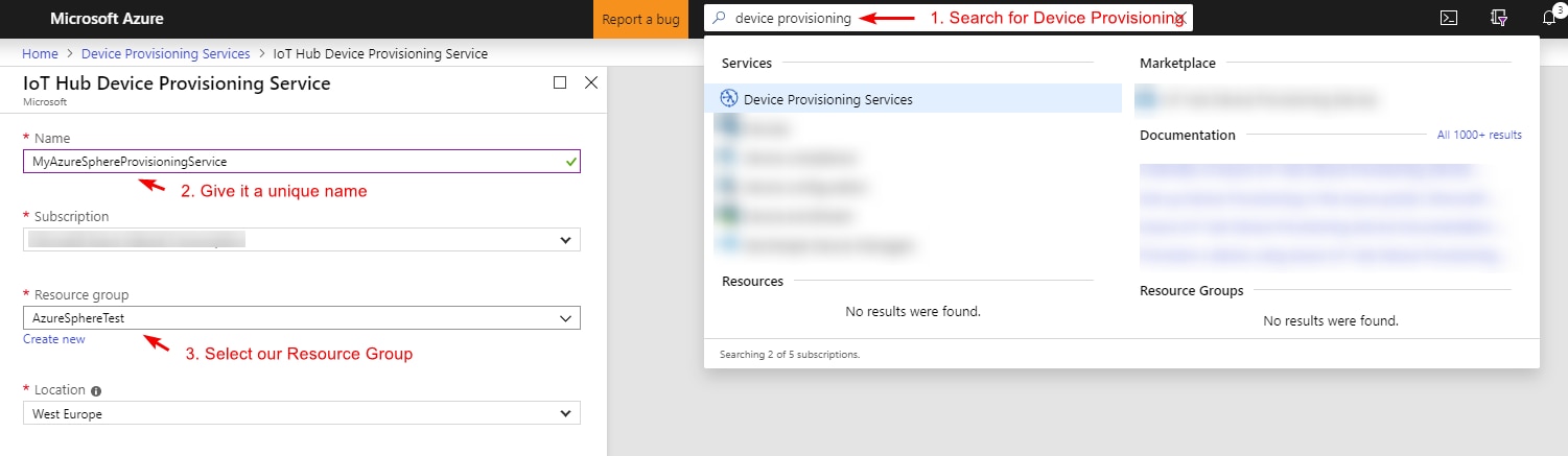

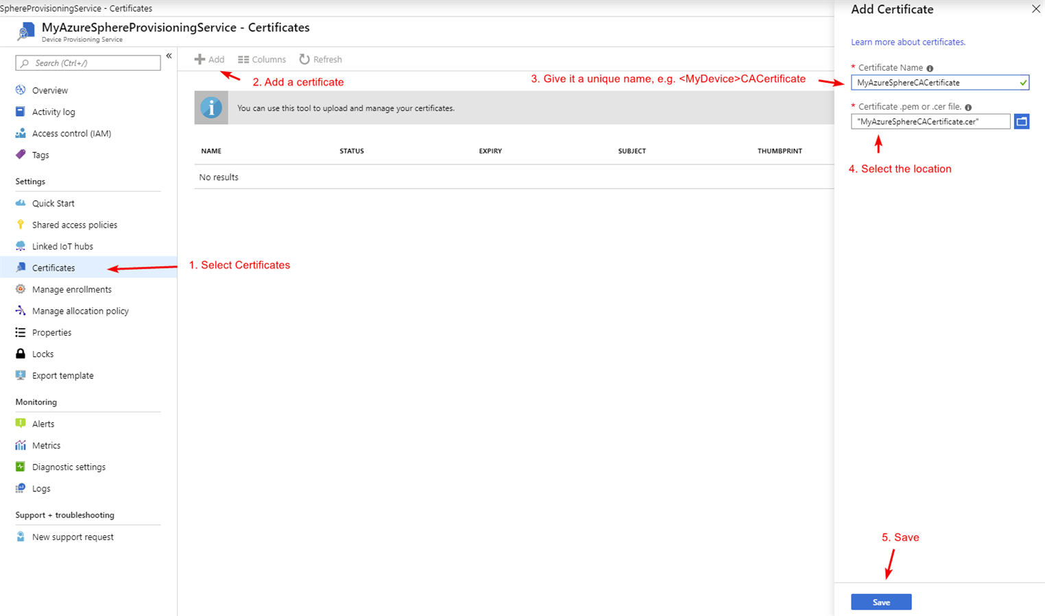

Azure Device Provisioning
Now we have an IoT Hub and an IoT Edge device, how do we actually connect this device to IoT Hub? One way would be to go through the portal and create our device manually. This is however not something we want to do seeing the manual work involved, wouldn't it be better if we could let our device handle all of this automatically?
For that we have the Azure Device Provisioning Service, which will  automatically provision our IoT device once it gets connected to the IoT Hub (this through a Enrollment list, but more later on that).
Once our Device Provisioning Service (DPS) has been set up, we can link our IoT Hub to it:

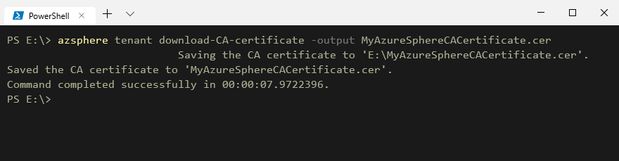

The last thing we now have to do is add our device to the enrollment list, here we have the choice to add our devices through Certificates our symmetric keys. Seeing the nature of IoT Edge devices and that we want to let them be as secure as possible, we will thus utilize a Certificate for this. First we will get our device its CA certificate by running the command azsphere tenant download-CA-certificate -output MyAzureSphereCACertificate.cer, whereafter we will add it to our DPS service and create an enrollment for it. See the pictures below on how this will look:

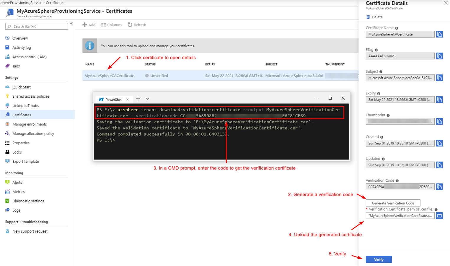

Now since we uploaded a certificate we need to verify that it's the correct certificate, for this get the code on the detail pane and verify it with azsphere tenant download-validation-certificate --output MyAzureSphereVerificationCertificate.cer --verificationcode <code>. Whereafter we upload this to the portal.
Last but not least we are now able to create an Enrollment Group where this device will be part of.
Now when our device connects, it will be automatically added.

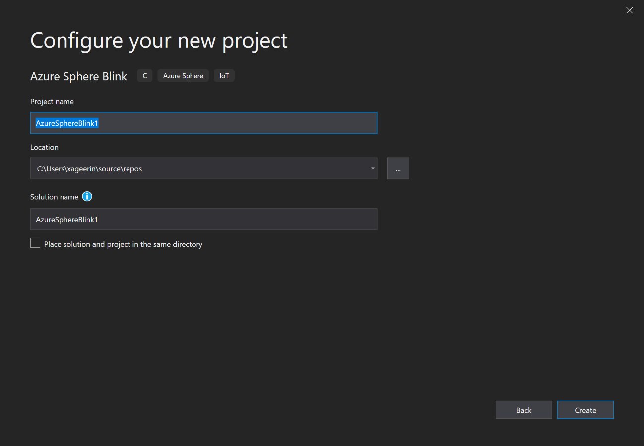

Code Setup
Now, since we connected our hardware, let's get started with coding our project. For that start off with creating a solution in Visual Studio as follows:
Since we now have a project, we now want to correct some properties:
  1. Change the SDK to the BETA version. For this, follow this guide and select the "2+Beta1905" version.
  2. We want to set the correct Hardware Target reference to be utilized in our app manifest. For this, we will copy over the Hardware folder from the Azure Sphere Samples to our project root (where our solution is sitting) as shown here.
  3. We want to access easy pin definitions as defined in step 2. For that, find the respective header files in the Hardware folder from step 2 and include them into your project. (for our Avnet development board, we thus have to include mt3620.h, avnet_mt3620_aesms.h and avnet_mt3620_sk.h).
Hello World - OLED Screen
The easiest code samples always start with a Hello World sample, so let's create one for the OLED display.
Note: Seeing that the scope of this post is to actually make a fully E2E working project, we are going to skip through this quite quickly, but feel free to find the source code in the GitHub repository.
Luckily for us, Avnet already used this type of OLED screen and working source code is available. Therefor we copy the following files:
  • oled.h
  • oled.c
  • sd1306.h
  • sd1306.c
  • font.h
We then change some parts to let it suit or needs (as well as strip unneeded code that access the accelerometer and other sensors) and add this in our main.c code:
// OUR IMPORTS
int main(int argc, char* argv[])
    // Start the OLED Screen    if (oled_init())
        Log_Debug("OLED not found!\n");
    else    {
        Log_Debug("OLED found!\n");
    // Clear the buffer    oled_buffer_clear();
    // Draw the strings    sd1306_draw_string(0, 0, "Test", FONT_SIZE_TITLE, white_pixel);
    sd1306_draw_string(OLED_LINE_1_X, OLED_LINE_1_Y, "Hello World", FONT_SIZE_LINE, white_pixel);
    sd1306_draw_string(OLED_LINE_2_X, OLED_LINE_2_Y, "Hello World", FONT_SIZE_LINE, white_pixel);
    sd1306_draw_string(OLED_LINE_3_X, OLED_LINE_3_Y, "Hello World", FONT_SIZE_LINE, white_pixel);
    sd1306_draw_string(OLED_LINE_4_X, OLED_LINE_4_Y, "Hello World", FONT_SIZE_LINE, white_pixel);
    // Send the buffer to OLED RAM    sd1306_refresh();
    return 0;
We can now see Hello World being printed on the screen:
Hello World - RFID Scanner
As a Hello World for our RFID scanner, we will be reading the version of our RFID scanner.
Note: this is not an easy feat since there is no library in existance for the RFID scanner that works with the Azure Sphere chipset
For this we will rework this library and bake in our chip support through the SPI applibs .
In short, we will adapt the read and write methods to utilize our Azure Sphere SPI interface so that they look like this:
void mfrc522_write(uint8_t reg, uint8_t data){
    const size_t transferCount = 1;
    SPIMaster_Transfer transfer;
    int result = SPIMaster_InitTransfers(&transfer, transferCount);
    if (result != 0) {
        return;
    //const uint8_t command[] = { (reg << 1) & 0x7E, data };    const uint8_t command[] = { (reg << 1) & 0x7E, data };
    transfer.flags = SPI_TransferFlags_Write;
    transfer.writeData = command;
    transfer.length = sizeof(command);
    ssize_t transferredBytes = SPIMaster_TransferSequential(spiFd, &transfer, transferCount);
    if (!CheckTransferSize("SPIMaster_TransferSequential (CTRL3_C)", transfer.length, transferredBytes)) {
        Log_Debug("Transfer size is not correct");
        return;
uint8_t mfrc522_read(uint8_t reg)
    uint8_t readDataResult;
    //uint8_t readCmd = ((reg << 1) & 0x7E) | 0x80; // Set bit 7 indicating it's a read command -> 0x80    uint8_t readCmd = ((reg << 1) & 0x7E | 0x80); // Set bit 7 indicating it's a read command -> 0x80    ssize_t transferredBytes = SPIMaster_WriteThenRead(spiFd, &readCmd, sizeof(readCmd), &readDataResult, sizeof(readDataResult));
    if (!CheckTransferSize("SPIMaster_WriteThenRead (CTRL3_C)", sizeof(readCmd) + sizeof(readDataResult), transferredBytes)) {
        return -1;
    Log_Debug("INFO: READ=0x%02x (SPIMaster_WriteThenRead)\n", readDataResult);
    return readDataResult;
We can then adapt our main.c code to initialize the RFC library and start reading the version:
// INCLUDES
void delay(int s)
    sleep(s);
int main(void)
    Log_Debug("IPC RFID RC522 Application Starting\n");
    // Start the RFID Scanner    if (mfrc522_init())
        Log_Debug("RFID Scanner not found!\n");
    else    {
        Log_Debug("RFID Scanner found!\n");
        return -1;
    // Look for a card    while (1)
        Log_Debug("Trying to get version\n");
        // Check version of the reader        // Can be 0x91 for 1.0 or 0x92 for 2.0 -> https://www.nxp.com/docs/en/data-sheet/MFRC522.pdf (p66 - VersionReg register)        uint8_t byte = mfrc522_read(VersionReg);
        Log_Debug("Detected version %d (Hex: %x)\n", byte, byte);
        delay(5);
    return 0;

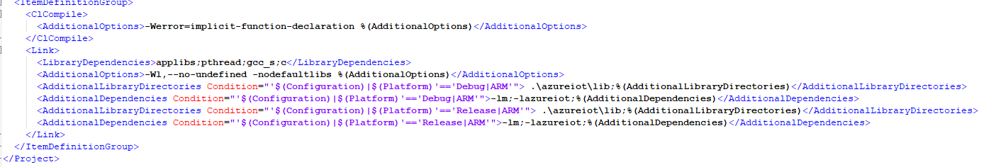

First we configure our project by opening the .vcxproj in a text editor and adding the following in the <Link> tags:
<AdditionalLibraryDirectories Condition="'$(Configuration)|$(Platform)'=='Debug|ARM'"> .\azureiot\lib;%(AdditionalLibraryDirectories)</AdditionalLibraryDirectories>
<AdditionalDependencies Condition="'$(Configuration)|$(Platform)'=='Debug|ARM'">-lm;-lazureiot;%(AdditionalDependencies)</AdditionalDependencies>
<AdditionalLibraryDirectories Condition="'$(Configuration)|$(Platform)'=='Release|ARM'"> .\azureiot\lib;%(AdditionalLibraryDirectories)</AdditionalLibraryDirectories>
<AdditionalDependencies Condition="'$(Configuration)|$(Platform)'=='Release|ARM'">-lm;-lazureiot;%(AdditionalDependencies)</AdditionalDependencies>
Making it look like this:
Luckily for us, the azureiot files are included through the Azure Sphere SDK installation (typically in C:\Program Files (x86)\Microsoft Azure Sphere SDK\Sysroots\2+Beta1905\usr\include\azureiot\), so we can have the following includes defined:
