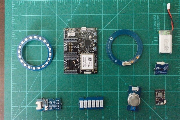

Parts
  • Bearings x2 (Outer diameter 1.125 in and Inner Diameter .038 in)
  • Spring
  • Custom end caps
  • Aluminum rod 0.36in diameter
  • Cap screws (M4)
  • Tap for M4 screws

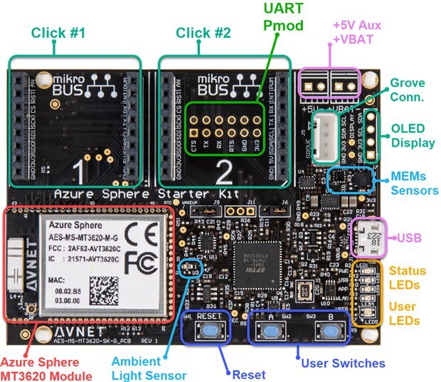

  • USB Breakout board
  • Battery Charge Module
  • Avnet Azure Sphere MT3620
  • 2 Neopixel Rings
  • Grove Rotary encoder
  • Grove Lidar range sensor
  • A good soldering iron
  • Heat shrink tube
  • Extra wire (salvaged wire is ok)
  • Lithium battery salvaged form something else (or go buy one if you feel the need)
  • 3D printer (yay!)
  • JB Weld or some decent glue
  • Thermoplastic just in case. As a maker, its a great tool to have on hand
  • Arduino Nano (for now)
  • An Azure subscription (can be free etc)

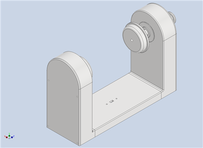

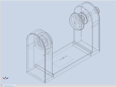

The first thing I did when I resolved my tissue issue, was to sit down and sketch. I drew a few designs, some were needlessly complicated, but I settled for something simple. Something I could print and design in a short time. Using Inventor, I designed the base and spindle that would house the electronics. I knew I would need to sense on dispense, so I settled for a Lidar range sensor and magnetic rotary encoder. Both should be simple. I also decided to have the option for status lights, so decided to design spots for two NeoPixel rings. This is what I came up with:
In theory, the range sensor would go in the square hole in the base, and the right side spindle would be pushed inward to hold the TP roll by a simple spring. A handle on the opposite side would be pulled to release and replace a roll of toilet paper. This helps accommodate variances in roll with and size. Both ends have panels that are screwed on with M2 screws that I have on hand, which i would later replace with M4 screws.
The model is included in the Git repo. At the time of writing, this is the prototype version where the next revision will include openings for USB (debug/programming and charging) and an additional channel for the pixel ring on the left side. For power and other electronics, i figured there was enough space and I would figure it out later. I wish I had thought to add a power switch -_-

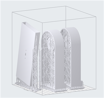

The Print Layout

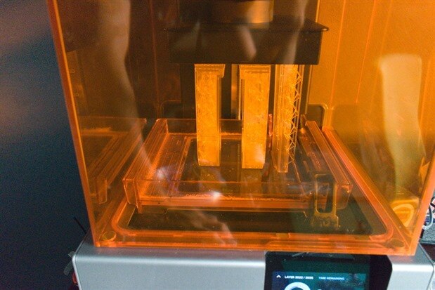

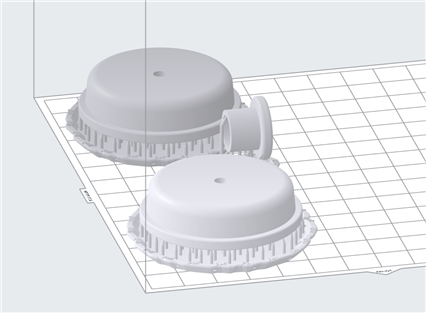

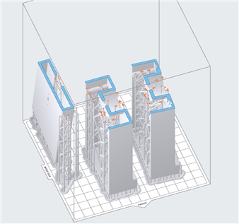

The printing took a full 24 hours. The model was also split into three pieces to fit in a Formlabs SLA printer. I used the standard clear resin because it is cheap and has many finishing options. After the first revision, assuming I could afford the materials and setup, I realized i should have used a blend of Durable and Tough resins.
The prints were laid out as seen below:
The print files will be included in the github repository

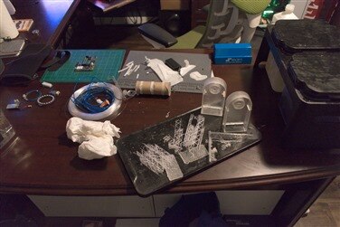

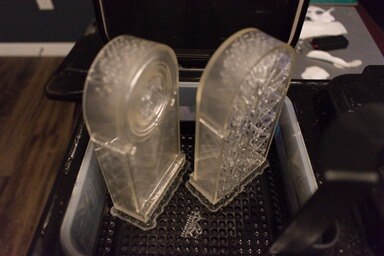

Print Day

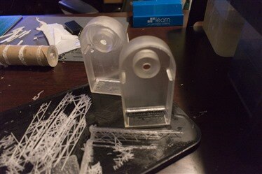

After a full 25 hours of printing, the larger parts were completed! How exciting! I couldn't wait to get them out of the tank, but had to wait until later in the day (after work!).

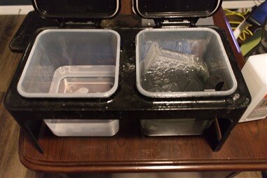

Cleaning parts
With resin prints, cleaning and finishing is a critical process. It is important to get any excess resin out of the small holes and detailed areas. A good scrub down in Isopropyl Alcohol does the trick. Wear gloves and work in a ventilated space.
As you can see the process is quite messy. No matter what printing process you use, you will need to clean the support structures and any residue. Now we have some parts!
Next was to decide on a finish for the parts and the end product. Since it is a prototype, I thought keeping it clear would be a nice touch. It would better show the insides! I sprayed the parts with clear coat after maskign off parts where glue will be needed.

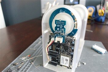

Assembly

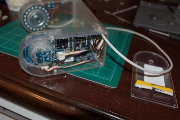

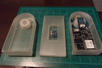

Once parts are printed and cleaned, it is time to clear the table and cleanup a bit. That was messy and we don't want the mess to carry over. Work clean and the end result will be clean as well!
The first stage of assembly was pretty simple. The parts snapped right into place, but some improvising was needed to address a few oversights.

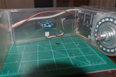

Simply assemble the parts into the case as shown. If you want to expose the USB on the Avnet MT3620, you will need to rotate it. I plan to update the 3d model to match.If you chose this configuration, some good glue will be needed to hold the board in place since the screws may not line up perfectly after rotating.
Be sure to put the NeoPixel rings in first, then the controller board, and last the rotary encoder and lidar sensor.
The Lidar should fit in the base, held in place with two small screws.

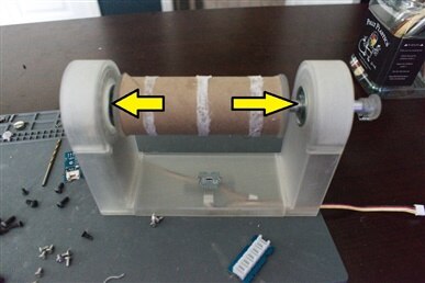

Next its time to finish up. Put the two large round printed spindle parts onto the shafts and screw them in. Be sure to screw in the electronics. Some glue can be used for the neoPixel rings.
On the side of the base with the moving shaft where there is no controller or electronics, mount your USB port, the battery controller, neo Pixel ring, and battery. I used double sided tape to stick my battery to the cover.

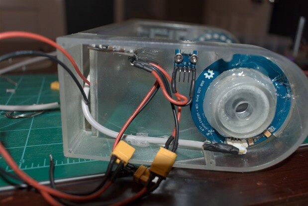

Wiring
Get some wires and wire up the USB Power and Ground to the battery controller
  • Connect Vin and GND to the USB Breakout board
  • Connect the Bat and GND pins to the battery. DONT cross the wires!
  • Wire the OUT 5V and GND to a long wire running under the base past the LiDAR sensor
  • Connect the long wire from the 5v OUT to the Avnet MT3620 board on the 5V AUX and ground pins and NOT the battery header. That is not what you think it is image
For reference:
For the sensors, you can splice together three Grove connectors. Use a soldering iron and heat shrink tubing for good results. The objective is to jsut solder together the matching colors so you have a cable with a grove connector on one end, and two on the other. This is a 'branch' as they call it, but really its just a janky cable. Plug the side with one connector to the Avnet control board, and the other sides to the liDAR sensor and the rotary encoder.
The LED rings are a bit of a problem, because they are not I2C and not really compatible on a branch like Seeed would like you to think. Really I regret using Grove components, because they are just basic sensors with basic over priced cables attached. Either way, IO have them so might as well use them. Things get a little complicated here, since this gets into the programming of the device.
As it turns out, the LED rings wont be compatible on the same bus as the sensors. Also there is no suitable driver, and time is running out. I decided to drop in an Arduino nano to get things going for now. The problem is the NeoPixels have strict timing requirements, which makes troubleshooting very difficult if you don't have the right tools. For one, an o-scope would be helpful in this case. Lacking the proper tools, I decided to settle for a less elegant solution to get this thing finished. The LED rings can be attached to the Arduino by wiring the 5v pin to a splitter with three wires. Two wires going to the pixel rings, and one wire going to the 5v output of the battery controller. Connect the ground wire in the same way. Next wire both yellow signal wires to pin D6 of the Arduino nano. I then programmed the Arduino with the boiler plate exmaple from Adafruit. And off we go!
Tuck the nano into the compartment with the battery for now. Later I will write a driver for the pixel ring so it can be controlled directly from the Avnet MT3620.
After that, screw on the panels and make sure all of the rollers are in place. Put the spring on the moving dowel between the roller and base for some added tension to hold the roll. And that is it, plug it in, charge it up, and off you go!

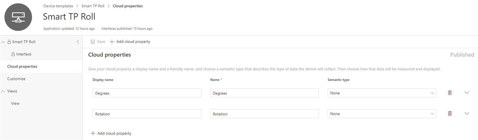

Once you have the code, you will also need to setup an IoT central application. The directions are a bit lengthy and I followed the steps provided HERE. Be sure to follow these steps carefully and make sure to pull the certificate from your IoT tenant and verify it. When creating the device template, be sure to add "Rotation" and "Degrees" as shown below:
Now its time to upload your code.
You can click the gear icon on the bottom of VSCode
And if all goes well, you should see no errors. Make sure your SmartTp roll is plugged into the USB port attached to the Mt3620 board. Next press F5 to start debugging. The program should upload and the device should be running!
Now plug in the Arduino Nano if you have not already. Make sure to install the Arduino Library located HERE. Then open the sketch located in the repo "SmartTp\Arduino\PixelRing\Lights.ino" and then build/upload. As soon as the program uploads, the lights will startup.
That is all for now on programming!
Cloud Stuff!

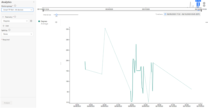

Next up is the cloud stuff. You should already have creatd your IoT central in Azure, and have a device showing up on the portal. You will need to approve the device and apply the template you created earlier.  Once that is complete, you will start to see data flow!
This image shows the sensor data from our rotary encoder. It will pulse up and down as degrees moves from 360 to 0. Each falling edge represents a new rotation on the roll. Rotation is currently not saved when the device powers off, but that is a planned feature. For now data will be sent and can be analyzed in the cloud!
You can also create a nice dashboard to show the data. As I test more with the device, additional data will show up on the dashboard.
