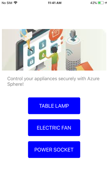

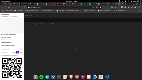

We start by developing the mobile application first. Once the 'expo start' command is run on the terminal, a local development server is initialized where the QR code can be scanned by your phone to view and debug in realtime the code developed for the application.
A simple user interface is designed on the application to control appliances such as Table Lamps and Electric Fans.

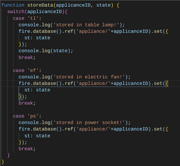

And here's a code snippet to store the state based on button presses to the Firebase Realtime Database. A switch case to determine what appliance is being switched ON/OFF where tl is the Table Lamp, ef is the Electric Fan and ps is an additional Power socket to be controlled.

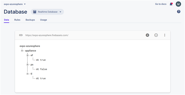

image     Verifying data on Firebase Console

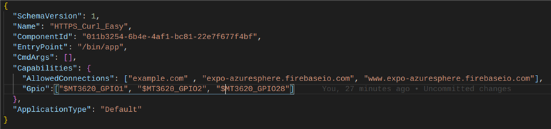

First, we set the app_manifest.json file to include capabilities to connect to the Firebase Realtime Database and to allow signaling to the GPIO's used in the project.

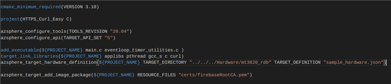

Next, the CMakeLists.txt is modified to include the hardware descriptors of the Azure Sphere as well as including the Root Certificate of the web service that is being accessed.

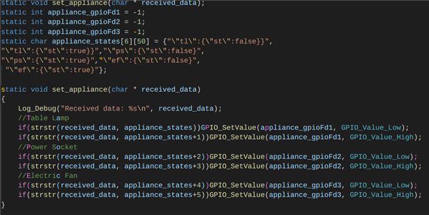

Here's the code snippet that checks whether the obtained data from Firebase (obtained via the libcurl sample code) is to set an appliance ON/OFF. Raw string comparison isn't probably the best for comparison of data and a JSON library such as this is much better for tokenization since the data obtained from Firebase is JSON formatted. That will be for future improvements but for now, this approach works out.

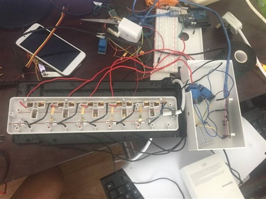

image    Putting it all together

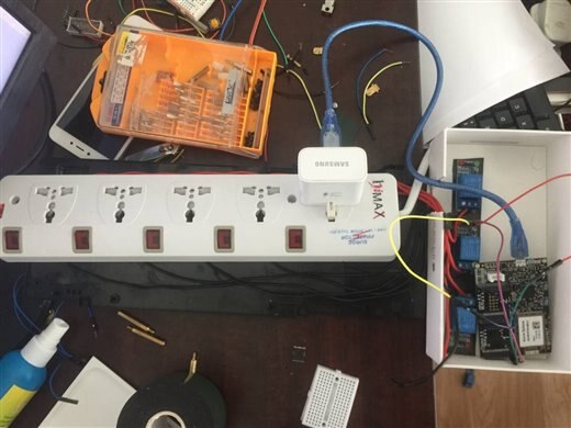

Here are the disassembly and connections of the Relay modules, Power Extension and the Azure Sphere.
And after all the wire configurations have been made and tested, the Azure Sphere and the Relay modules will be nicely tucked away when the cover is placed.
