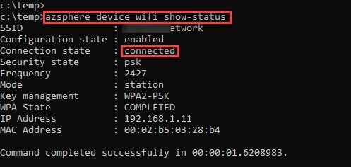

The first thing we need to do is verify that our Azure Sphere device is connected to a Wi-Fi network. From the Azure Sphere command line tool execute the following command.
  • azsphere device wifi show-status
If the device is connected then you’ll see a status printed out similar to the graphic below

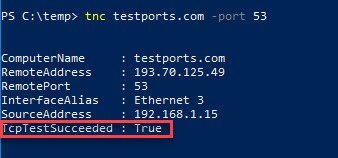

The network requirements for Azure Sphere are documented here:  https://docs.microsoft.com/en-us/azure-sphere/network/ports-protocols-domains.  If your ISP or internet connection blocks any of these ports you’re connection likely won’t work.  We can use Windows Powershell and the tnc (Test NetConnection) utility to probe ports on our IoT Hub and other azure resources to verify if they are reachable.  If your network blocks any of these ports, try using a different network, for example the network on your mobile phone’s wifi hotspot.  For the test below your PC should be connected to the same wifi network as your Azure Sphere device.
A successful tnc execution will look like the graphic below:
  1. Launch windows power shell
  2. Copy paste in each tnc * line below to check network connectivity.  Note that if the command shows <Your IoT Hub Hostname> you need to replace that text with your IoT Hub hostname
    • Device provisioning and communication with IoT Hub
      • tnc <Your IoT Hub Hostname> -port 8883
      • tnc <Your IoT Hub Hostname> -port 443
    • Communication with web services, network time (NTP) server, and Azure Sphere Security service
      • tnc prod.device.core.sphere.azure.net -port 443
    • Internet connection checks, certificate file downloads, and similar tasks
      • tnc www.msftconnecttest.com -port 80

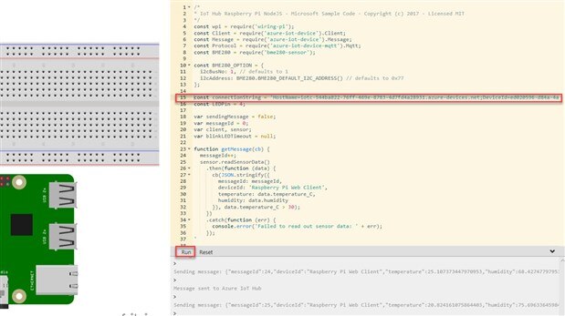

We can use a simulated device running in a web browser to connect to the device we provisioned on the IoT Hub (or IoT Central).  While this does not validate that we can send data from the actual Azure Sphere device, it will confirm if we can connect to our IoT Hub and that the IoT Hub is correctly configured.  If the web browser and the Azure Sphere device are on the same network, then we can assume that the data path from our local network to the IoT Hub is good.
There is a Raspberry Pi simulator that will connect to the IoT device on your IoT Hub.
  1. Open the simulator: online Raspberry Pi simulator
  2. Using your IoT device connection string modify the source code at line #15
    1. Note this connection string can be from your IoT Hub --> IoT device, or the connection string you generated for your IoT Central application
  3. Click on the run link under the source code
  4. You should see the device send data to the IoT Hub

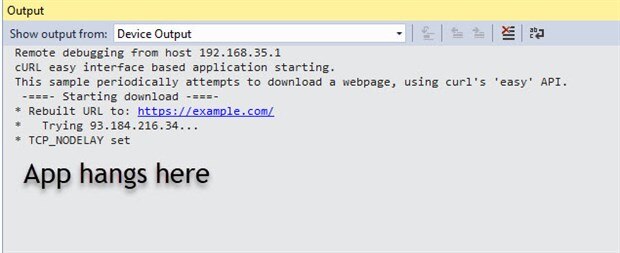

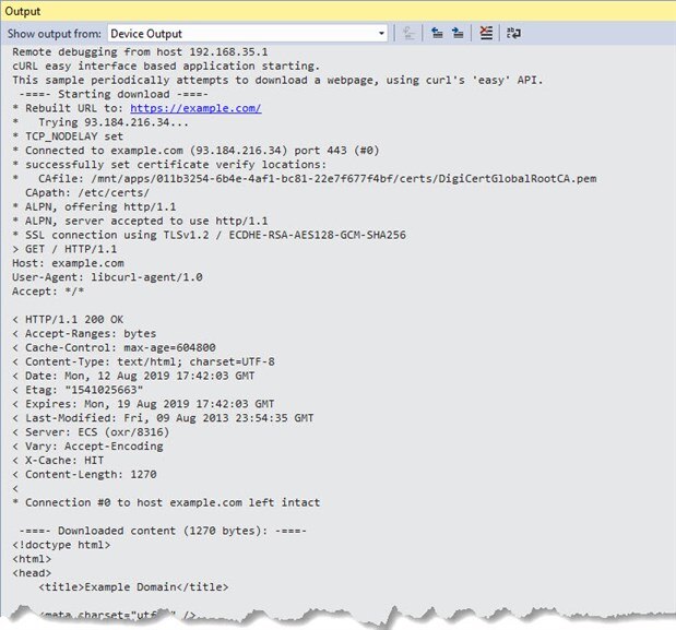

One way to determine if your device is working properly is to run one of the Microsoft Azure Sphere examples called "HTTPS_Curl_Easy.sln" that can be found here: https://github.com/Azure/azure-sphere-samples/tree/master/Samples/HTTPS/HTTPS_Curl_Easy .  This application demonstrates how to use the cURL "easy" API with Azure Sphere over a secure HTTPS connection.  The application periodically downloads the index web page at example.com.
A working system will display output similar to the graphic below . . .
A non-working system will display output similar to the graphic below.  Note, I turned off my cable modem and left my wifi router on-line to capture this state.  The application just hung waiting for a connection.
