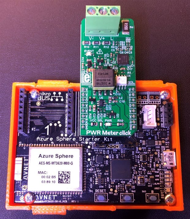

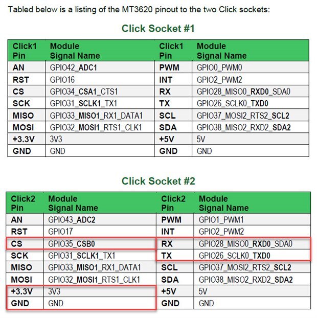

Hardware Configuration

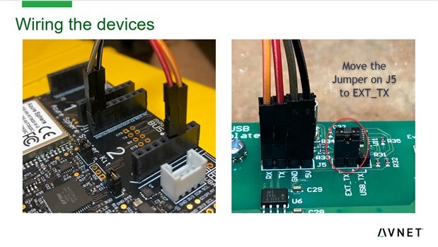

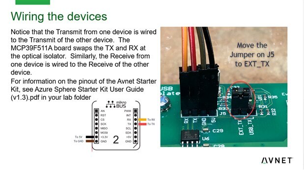

Since we're using the Avnet Azure Sphere Starter Kit, putting the hardware together for the Power Monitor is as easy as plugging your MIKROE-3169 PWR METER CLICK into your Starter Kit.  The software application expects the board to be in Click Socket #2.
The specifics for  Click Socket #2
  • The UART TX and RX are connected to the MT3620 ISU0
  • The Enable (EN) signal on the Click Board is connected to the MT3620 GPIO35
Note: If you wanted to relocate this board to Click Socket #1, you would need to use GPIO34 instead of GPIO35 for the EN signal.  ISU0 is common between both Click Sockets.  See the pinout tables below.  The signals used by our click board are identified with red boxes.

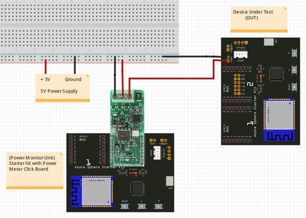

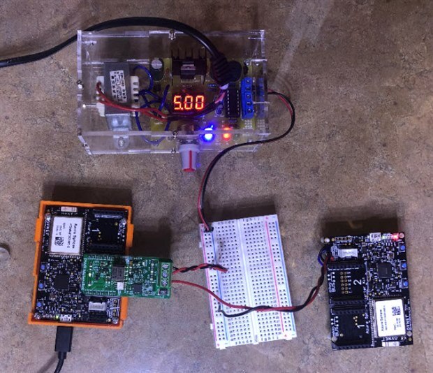

Test Configuration
Since a power meter /  data logger is not very useful without something to measure, I've created a test configuration to measure the voltage and current drawn by another Avnet Azure Sphere Starter Kit.
You can use the table and diagram below to reproduce my test configuration.   Note that you could substitute just about any equipment for your device under test (DUT) as long as you provide the correct supply voltage and don't exceed the voltage limitations of the PWR METER click board.  The PWR METER click board has a limit of 60V (AC or DC), so don't exceed 60V on your specific test configuration.  If you need to measure line voltages (120V AC), I'll provide some details at the end of the blog to show how you can use the same Azure Sphere Application with a different MCP39F511 test device.
SignalFromTo
+5VPower Supply+5V rail on breadboard
+5V+5V rail on  breadboardV+ terminal on PWR METER click board
GroundPower SupplyGround rail on breadboard
GroundGround rail on breadboardV- terminal on PWR METER click board
GroundGround rail on breadboard5V- terminal on DUT Starter Kit
+5V LoadL on PWR METER click board5V+ terminal on DUT Starter Kit
  • My test configuration, don't laugh at my $22 adjustable power supply, it works!

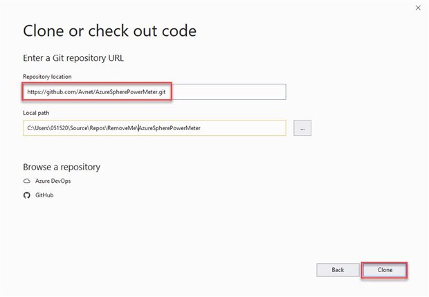

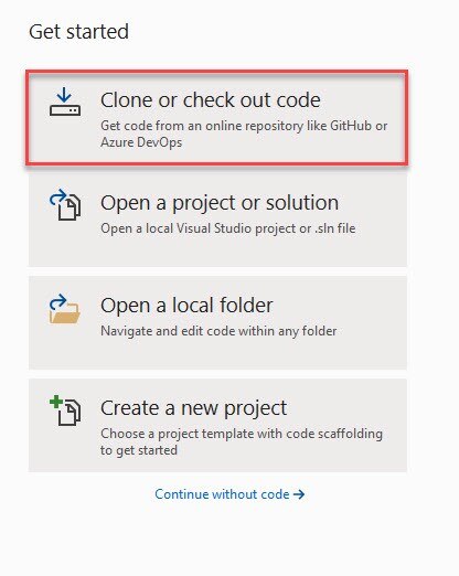

Clone the project from Visual Studio 2019
  • Launch Visual Studio 2019
  • When the application opens, select the "Clone or check out code" option
  • For the Repository location, enter: https://github.com/Avnet/AzureSpherePowerMeter.git
  • Change the Local path if you want to
  • Click on the  "Clone" button
  • The project is cloned

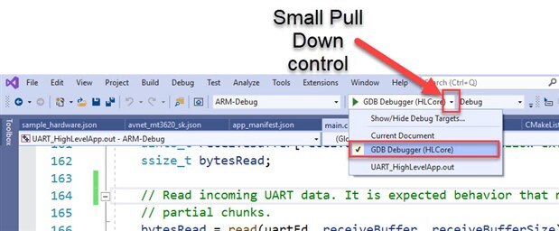

Build and Run the Project
Run the application
  • To run the application, first select "GDB Debugger (HLCore)" from the pull down menu.
  • Next click on the "GDB Debugger (HLCore)" link
  • Your application builds, loads on the target, and runs
That's it!  The application should be running.

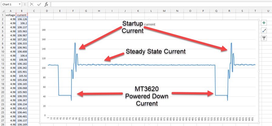

Plot Data from the Application
I captured a ~4 minutes of data from my DUT.  My DUT was running the Microsoft PowerDown example application.  This application periodically puts the MT3620 into a power down state with instructions for the device to wake up after a 10 second period.  The current data should show this behavior.

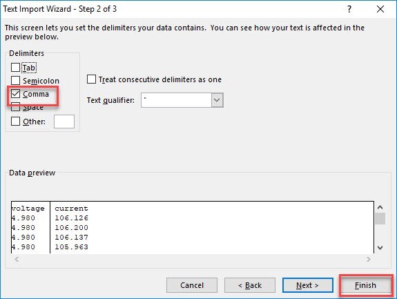

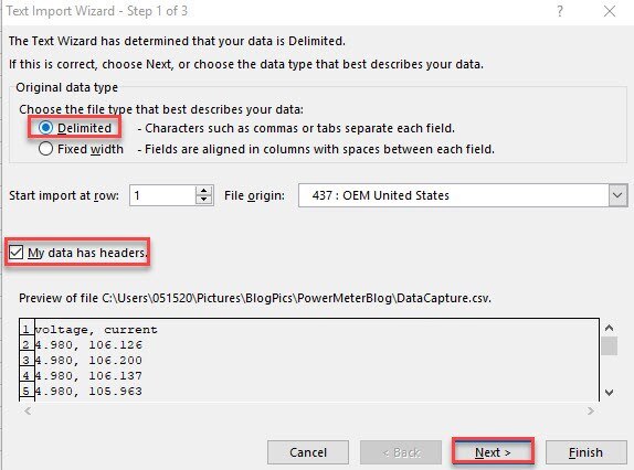

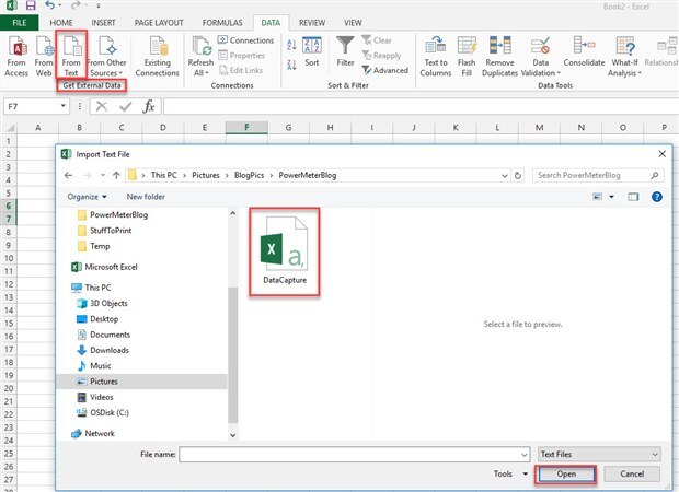

Import the Data into Excel
I'm using Excel 2013, your Excel implementation may be different.  You'll get the idea.
  • Open Microsoft Excel
  • From the "Get External Data" grouping  select the "From Text" option
  • Browse to your data file
  • Click "Open"
  • The "Text Import Wizard" opens
    • Select the "Delimited" option
    • Select the "My data  has headers." option
    • Select the  "Next" button
  • Deselect the "Tab" option
  • Select the "Comma" option
  • Select the "Finish" button
  • Select where you want to put the data in your workbook
  • Click on the "OK" button
  • Your data is imported into Excel

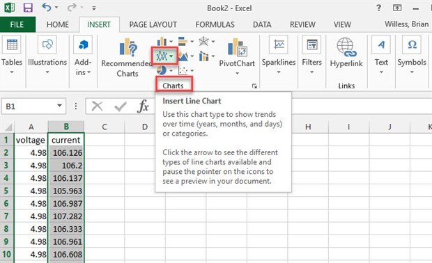

Graph the Current Data
  • Using your mouse, or keyboard, select all the data in the "current" column
  • In the "Charts" grouping, select "Line Chart"
  • A line chart is inserted into your workbook

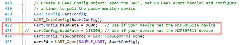

Software Changes
  • Serial Port Speed
    • If your kit uses the MCP39F511 device, set the serial port baud rate to 115200
    • The baud rate is defined in main.c around line #422
  • Data divisors
    • The two kits also return data differently
    • The data divisors are defined in main.c around line #231

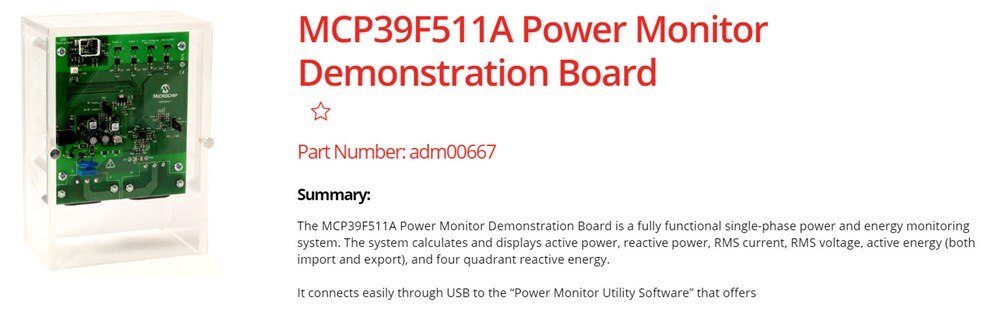

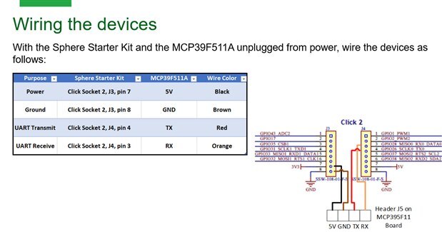

Hardware Changes
Use the table below and the pictures to correctly wire the Avnet Starter Kit to  the Microchip demo board
That's all there is to it.  After making the two software changes and correctly wiring your hardware run the app and turn on your connected device.
