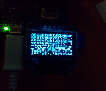

Lightweight u8x8 sublibrary text output
char buff[30];
uint8_t i, j;
u8x8_SetFont(&g_u8x8, u8x8_font_amstrad_cpc_extended_f);
for (i = 0; i < 8; i++)
    for (j = 0; j < 16; j++)
        sprintf(buff, "%c", j + (16 * i) + 65);
        u8x8_DrawString(&g_u8x8, j, i, buff);

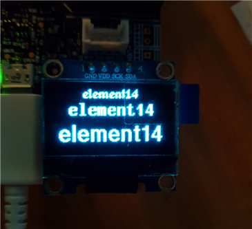

u8g2 variable fonts
u8g2_ClearBuffer(&g_u8g2);
u8g2_SetFont(&g_u8g2, u8g2_font_oldwizard_tr);
lib_u8g2_DrawCenteredStr(&g_u8g2, 10, "element14");
u8g2_SetFont(&g_u8g2, u8g2_font_t0_22b_tr);
lib_u8g2_DrawCenteredStr(&g_u8g2, 30, "element14");
u8g2_SetFont(&g_u8g2, u8g2_font_helvB18_tr);
lib_u8g2_DrawCenteredStr(&g_u8g2, 60, "element14");
u8g2_SendBuffer(&g_u8g2);

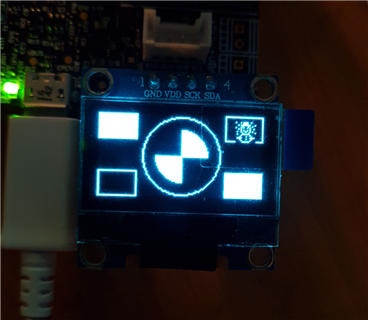

u8g2 graphics
u8g2_DrawBox(&g_u8g2, 0, 0, 30, 20);
u8g2_DrawFrame(&g_u8g2, 98, 0, 30, 20);
u8g2_DrawDisc(&g_u8g2, 64, 32, 20, U8G2_DRAW_UPPER_RIGHT | U8G2_DRAW_LOWER_LEFT);
u8g2_DrawCircle(&g_u8g2, 64, 32, 30, U8G2_DRAW_ALL);
u8g2_DrawFrame(&g_u8g2, 0, 44, 30, 20);
u8g2_DrawBox(&g_u8g2, 98, 44, 30, 20);
u8g2_SetFont(&g_u8g2, u8g2_font_unifont_t_symbols);
u8g2_DrawGlyph(&g_u8g2, 106, 18, 0x2603); /* dec 9731/hex 2603 Snowman */

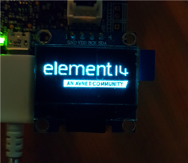

u8g2 bitmaps
u8g2_DrawXBM(&g_u8g2, 0, 0, e14_logo_width, e14_logo_height, e14_logo_bits);
XBM is source code friendly bitmap format. You can convert your own images to XBM for example using Gimp:
  1. Menu Image > Mode > Indexed... > Use black and white (1-bit) palette > Convert
  2. Menu File > Export As... > [change output file extension to .xbm] > Save
