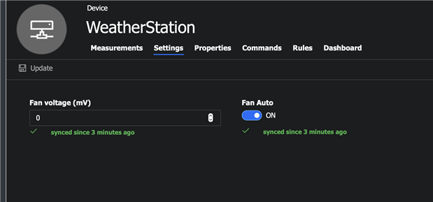

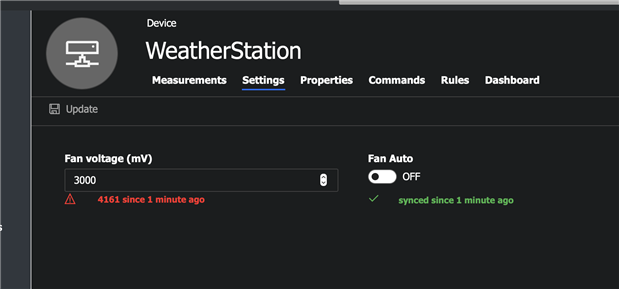

This also provide AUTO mode for setting the fan speed based on PM and IQA class values
uint8_t ltc1695_auto(uint8_t pm, uint8_t iaq) {
const speed[7] = { 0,3000,4200,4500,4922,4922,4922 };
above array is the corresponding voltage of the max value for IAQ and PM, for example IAQ is 2 and PM is 3, the voltage is 4500mv.
The board A B button used for choose of AUTO/Manual speed, push B switch to manual mode and increase the fan speed, push A reduce fan speed, stop and switch to AUTO mode, the APP LED indicate the mode of FAN, blinking mean manual set, and long lighting is AUTO mode.

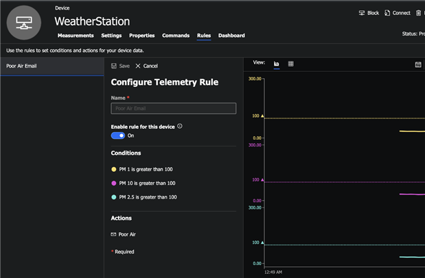

Azure IoT Central
At the end, we connected the APP to Microsoft Cloud service, which for logging, monitoring and even make control of the devices though security online platform. As our project foundation is the Avnet ADC demo, we have basic framework of Azure.
First, we need build a create a new application under Azure IoT Central, create a new Device Templates, added the necessary telemetry, which is the sensor data, i am not go though the detail, the elements14 with a very good starting tutorial.
Under Measurement, we build 8 telemetry, the field name is corresponding of the json string name inside the i2c.c AccelTimerEventHandler which is the timer loop for update the sensor data.

Future more, we create two item under Setting, which for set of FAN speed (Number) and the FAN mode (Toggle).
Under device_twin.c we added two item on twinArray[]
{.twinKey = "fanspeed",.twinVar = &ltc1695_manual_value,.twinFd = NULL,.twinGPIO = NO_GPIO_ASSOCIATED_WITH_TWIN,.twinType = TYPE_INT,.active_high = true},
{.twinKey = "fanmode",.twinVar = &ltc1695_mode,.twinFd = NULL,.twinGPIO = NO_GPIO_ASSOCIATED_WITH_TWIN,.twinType = TYPE_BOOL,.active_high = true}
When the user change the settings under Azure IoT centre and click update, the requirement will send to device, and triggering the deviceTwinChangedHandler, therefore we update the fan condition under this handler.

We also need to inform Azure IoT centre when the Fan status change
void updateFanDevice() {
for (int i=4;i<=5;i++)
checkAndUpdateDeviceTwin(twinArray[i].twinKey, twinArray[i].twinVar, twinArray[i].twinType, true);
Let's come back to Azure IoT centre, we need to create a new real Devices under Devices > Plus > Real, use default Device ID,
After that, click the Device created, and click upper right "Connect" item.
Copy the Scope ID, Device ID and Primary Key, run dps-keygen to generate the connection string
#define MY_CONNECTION_STRING "HostName=iotc-xxxxxxxx-xxxx-xxxx-xxxx-6ca12a71a134.azure-devices.net;DeviceId=xxxxxxxx-2616-4cfe-ac6a-35c9fff2e2bbb0;SharedAccessKey=4Uxxxxxxxxxxx/6OraNMh4bIOUxxxxxxxxMhefA+"
and change "AllowedConnections" string in app_manifest.json.
"AllowedConnections": [ "192.168.1.101", "iotc-xxxxxxxxx-8707-4aeb-a938-33xxxxxxx.azure-devices.net" ],
Reference of element14 tutorial for more detail.
Now, the Azure IoT centre is able to logging the device data,
Under setting, we are able to change the Fan setting:
Simple change the value and click "Update", the fan speed will change immediately.
If you push the hardware button to change the setting of fan, Azure will inform you the value do not match, it normal, and you can edit the value and send update usually.
