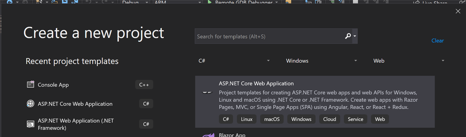

To prove this concept a simple .Net Core web service could be built. I started with the Visual Studio Template ASP.Net Core Web Application.

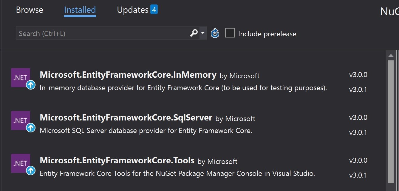

For data storage, I used an In Memory EF Core database to simulate a database without actually having to use a full SQL server. This will also provide a simple migration to a full persistent database. The package can be added to the project via the NuGet packages below.

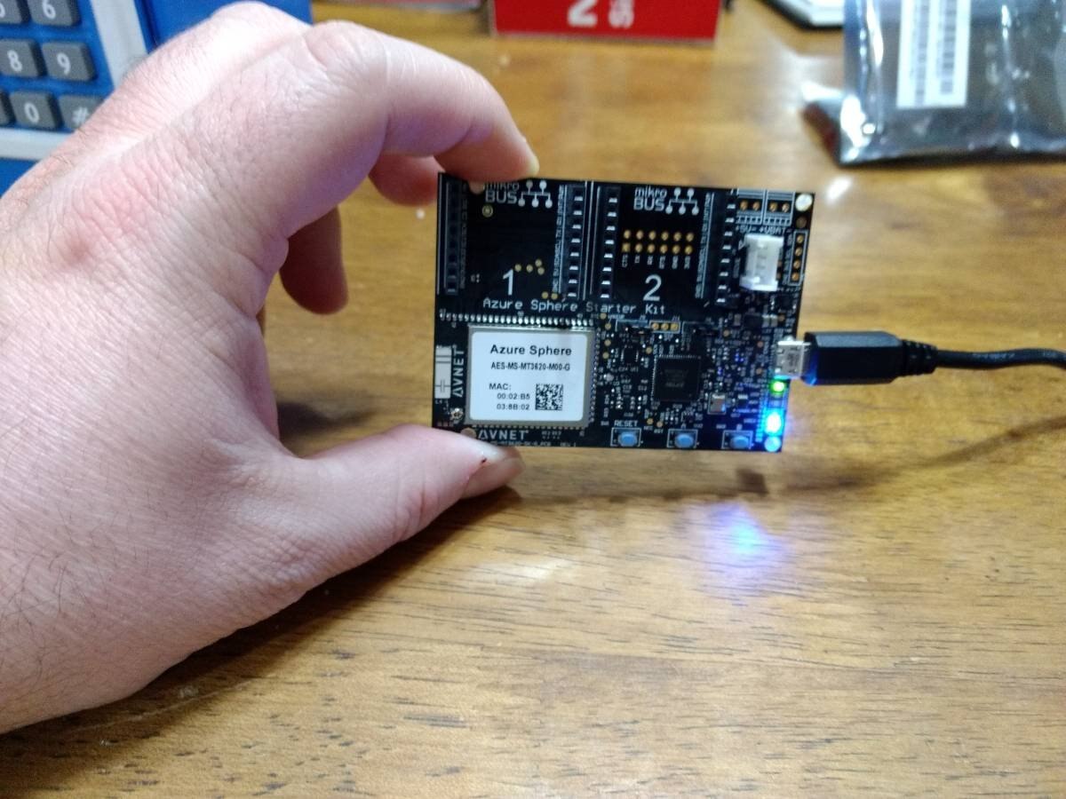

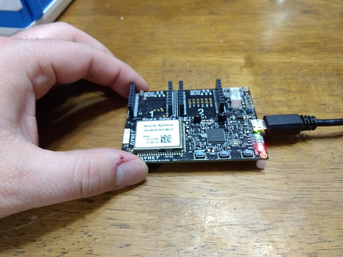

I then used the Accelerometer data to decide whether the unit was parallel to the ground or vertically oriented which would be the two states of the garage door if this sensor was attached to the door. When the unit is  reading near zero it was reading in the vertical position, where as a value of near 1 was indicative of the unit being parallel to the ground as if the door were open. At the same time, I went ahead and changed the LEDs to indicate whether the door was in an open position by changing the LEDs from Blue to Red based on the position.
