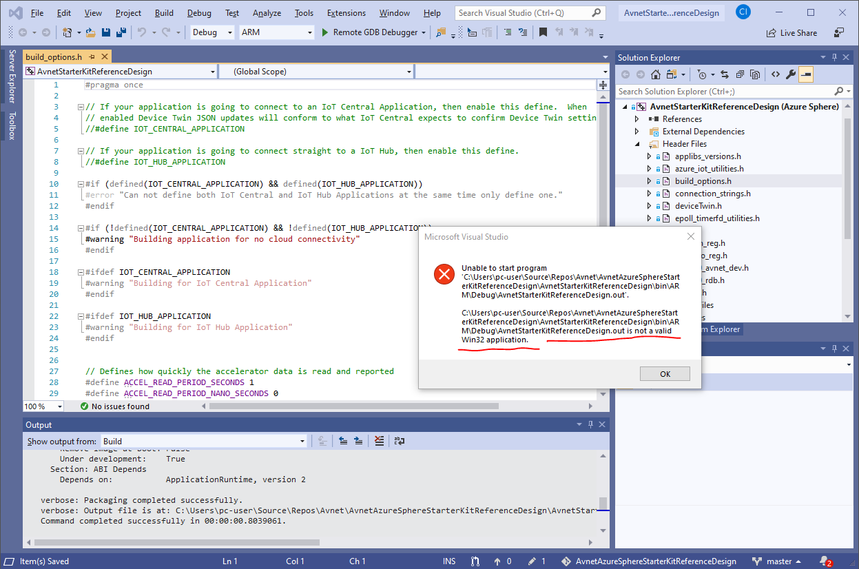

Hello Everyone,
I am going through this tutorial:
Avnet's Azure Sphere Starter-Kit (Out of Box Demo) Part 1 of 3
and I was able to clone the git hub example project but when I try to run the project I get an error stating that AvnetStarterKitReferenceDesign.out is not a valid Win32 application.  Here is a screenshot:
Did anyone get this error?  Is it any fix for it?

    This error implies that you're trying to run the application on your PC rather than deploy it to the device. I think this has happened to someone else. Let me do a quick search and see what the easiest…

    Hi David, thank you for the quick response. It looks like I bumped into this problem before - if I open the project by double-clicking the file name then it works but if I open it from the GUI "open a…

    It seems the previous time it happened was to you about a month ago! Check the answer there as you seemed to get it working: Question about Error Message when running the Azure Sphere Reference Design

    thank you for the quick response.  It looks like I bumped into this problem before - if I open the project by double-clicking the file name then it works but if I open it from the GUI "open a project or solution" button it gives me that run error.  I will use the double-click starting method from now on.  Thank you for your help.
