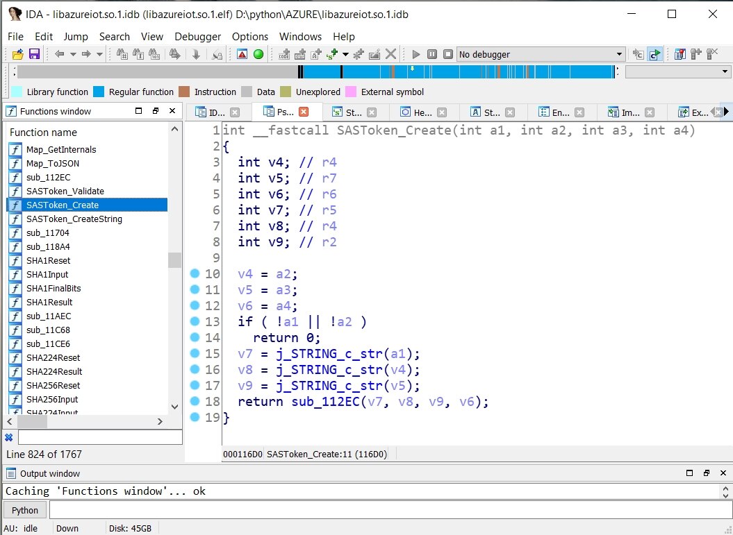

  • wizio
    wizio over 7 years ago in reply to bwilless
    or is telemetry like Windows 10 telemetry...
    Brian, you're wrong here,
    Microsoft MQTT comunication is "normal" TLS encrypted from wolfSSL with private key for SAS Token ( Pluton here, just works like a firewall )
    Reference:
    https://github.com/Azure/azure-c-shared-utility/blob/master/src/sastoken.c
    used in libazureiot.so (full version)
  • wizio
    wizio over 7 years ago in reply to wizio
    if you don't believe it.....
    Reference
