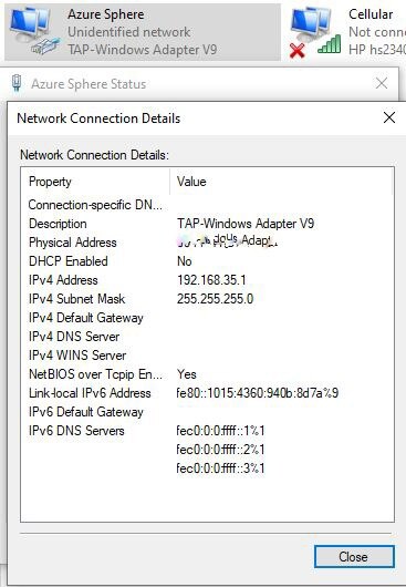

Hello,
I have used the starter kit sense one month.
I sent pings to Microsoft servers.
Everything worked well.
Last time I tried to connect it receive an error message:
error: Could not connect to an Azure Sphere device. Please check the device is correctly connected.
error: Command failed in 00:00:00.5959221.
Waiting for 2 seconds, press a key to continue ...
   .... ERROR: Invalid Device ID ....
+              ERROR             +
   .... ERROR: No reply from Starter Kit ....
I reinstalled the SDK. Downloaded the latest version.
Checked TAP-Windows Adapter v9
Reinstalled drivers For Virtual COM Port (VCP).
Erased the Restore.json file.
Checked the the Azure Sphere Device Communication Service if is started.
When connect the starter kit to the PC it can not be recognized and it not appears in COM & LPT section of Device manager.
The green LED is on, the yellow one only flash twice and goes off.
I will appreciate If anyone can help me to solve my problem.

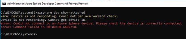

    Is this your app log or azsphere log
    from screen-shots azsphere must work
    azsphere dev show-attached ?
    or Microsoft has replaced any API function image

    Hello,
    this is Azure Sphere console.
    After azsphere dev show-attached I received:

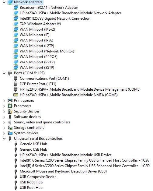

    if you connect board - there is 3 uarts in device manager?
    Ако вържеш платката излизат три COM ports и единия винаги е зает от AzureSphereService image other is recovery uart, other is Pluton debug  tracer < -- have text data
    The service is TAP-TUN-SLIP ( Uart to Network ) azsphere is just HTTPS-REST-API uploader
    the command azsphere dev show-attached
    is GET https://192.168.35.2/status
    Response {"uptime":288}

    fantoms over 7 years ago in reply to wizio
    There is no additional COM ports when I connect the board to the PC. I think this is the problem.
    The picture of the COM ports in first post is with connected board.
