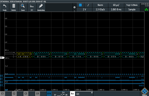

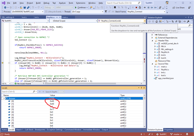

The problem I have now seems to be an MT3620 one. I frequently (but not consistently) get a stray byte at the start of my response. Sometimes it's the first byte repeated. Sometimes it's 0xFF. Perhaps it could be left over from the last response. I've written code to detect and remove it, but it really shouldn't be there. I've taken a close look at my code and nothing is out of the ordinary. The error comes back from the I2CMaster_Read function in the Azure Sphere SDK.
Has anyone seen this problems before or have any other ideas?

    The SCL and SDA lines I'm using already have 4.7k pull-ups on the Azure Sphere as they're also used for the onboard LSM6DSO gyro/accelerometer. There are also 10k pull-ups on the NFC click board. The result doesn't seem to vary with bus speed. I will double-check that the signal is reasonably clean.

    I have had similar problems working with the Uart with the POXIS read and write functions. I solved the problem by doing the readings and writings in separate threads and adding nano sleeps in the threads to let the uart data be read or written.
    Maybe this is not yout problem as I2C Azure Sphere operations are all blocking, synchronous operations. In the UART only asynchronous operations are supported by now.
    Perhaps you can increment the timeout ( I2CMaster_SetTimeout) or make a delay before reading.

    I'm already writing, waiting for IRQ to go high and then reading. There's a few ms between sending the command (off-screen to the left on the 'scope screenshot) and reading the response. I had similar problems without the delay - i.e. using I2CMaster_WriteThenRead.
