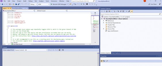

Creating the Blink project
We are using Visual Studio to create this project.  Start “Visual Studio 2019” or any other version of “Visual Studio”
Create a new project
Select create new project in Visual studio project.
                     Pic (3)

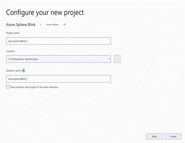

Project name and location
Give project a name and select the location where this should be created.
                                    Pic (5)

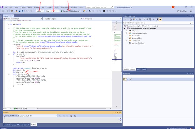

Debug with Device
We will see how we can debug when out Azure Sphere device is connected.  Make sure your device is connected to laptop with USB.  Select “Debug” , “ARM” as show in the screen below. Click on “Remote GDB Debugger”
                                                               Pic (7)

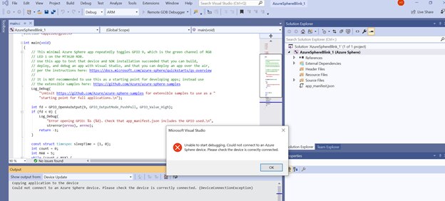

If the device is not connected, you will see following error.
                                                                           Pic (8)
If device is connected, you will see the LED blink indefinitely.

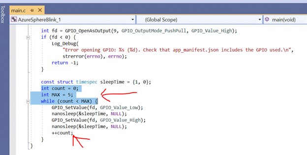

Updating Code
Let’s try to update very simple code to understand.
We will change our code so that LED blink only 5 times.
We will define an integer variable count, MAX and use that in while condition.
Here is code which we can update in existing code as shown in picture below
// Keep counter for how many blink
int count = 0;
// Max number of blinks
int MAX = 5;
// Stop after 5 blinks
while (count < MAX)
// Increase count after each blink
++count
