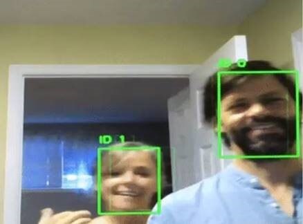

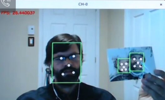

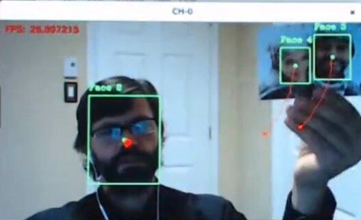

I also describe how to modify the face detection example, to add additional processing, including:
     adding face landmarks
     adding simple centroid-based tracking
For those who prefer to develop in python, refer to the following tutorial which covers how to implement the face detection and tracking in python.
     http://avnet.me/ultra96-python-face-tracking

    Please extract the archives on the BOOT partition of the SD card, in the Vitis-AI-Library/overview/samples.
    Build each of the examples directory on the Ultra96-V2 embedded platform with the provided build.sh script.
         $ cd /mnt/Vitis-AI-Library/overview/samples/facedetectwithlandmark
         $ source ./build.sh
         $ cd /mnt/Vitis-AI-Library/overview/samples/facedetectwithtracking
         $ source ./build.sh
    Execute the examples with the USB camera:
         $ ./test_video_facedetectwithlandmark 0
         $ ./test_video_facedetectwithtracking 0
