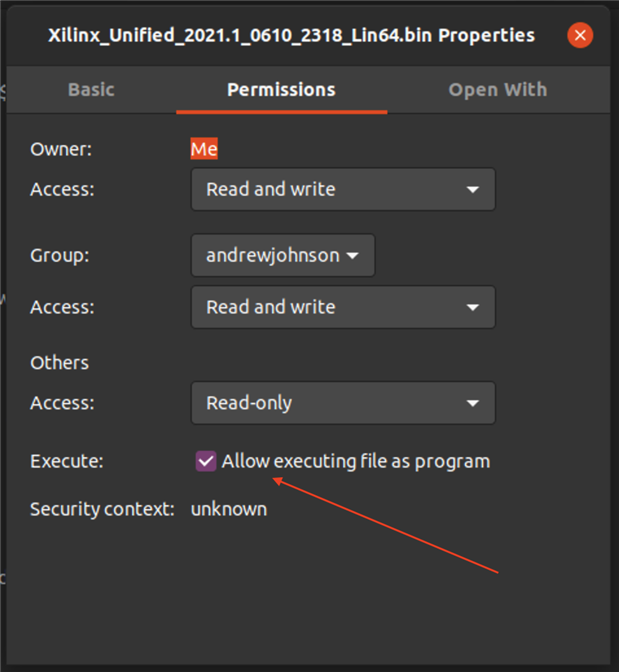

From Ubuntu Files, find the installer and open its properties, select permissions tab and select Executable.
This is the easier way.  Alternatively, in the terminal, in the downloads directory for Xilinx, enter command chmod +x Xilinx*  I did it the easy way, I’m assuming that typing Xilinx* will work to save entering the full name.  Also, I think you can try pressing tab instead of the asterisk and it will expand the full name, don't know didn't try it.  If you don't set it executable, it will try and load the bash script into an editor instead of running.
From terminal enter: sudo Xilinx* to launch the installer.
You can then follow the instructions for installing under windows.  If you don’t use sudo to run it, there will be problems in creating the default directory (/tools), but you don’t have to use that directory - I now know what problems occur if you use sudo but I don’t know what problems occur if you don’t use sudo.  What I do know is that as it’s the first time I'm using these tools, I don’t want to stray off the tool defaults covered in these workshops. Note that I found that the download size including DocNav is 30.32 and without DocNav, 30.03, slightly larger than installing under Windows 10.  Bryan highly recommended installing DocNav if you have the space.

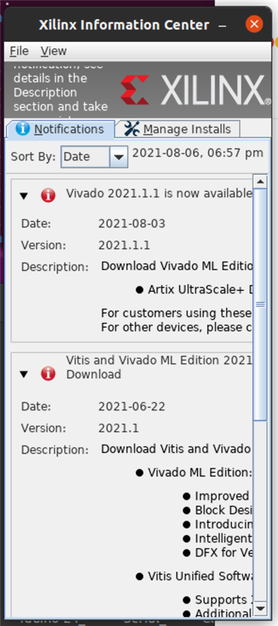

After installation, this pops up:
A non-expandable window!  Hmmm…. From the little I can see, I don’t know enough yet to determine if we need those updates.  No doubt we can find out in the upcoming sessions.  We're definitely using the ML Edition though.
