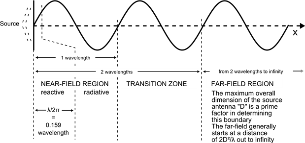

It can be refered to as EM or Electro Magnetic radiation but the true conversion doesn't occur until several wavelengths away from the source.
     Image source Near and far field - Wikipedia, the free encyclopedia
Within the near field reactive region, any conductive objects can cause the antenna can be detuned.

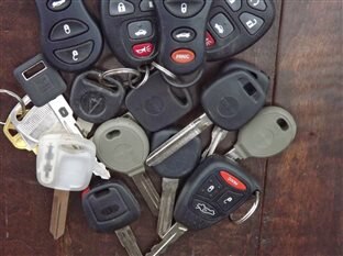

Anyone that has a modern car probably hasn't realised there is a tag inside their key, which is registered in the cars Engine Management Computer.
    Image source  Google search various multiple finds
My car doesn't have one of those keys. image

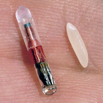

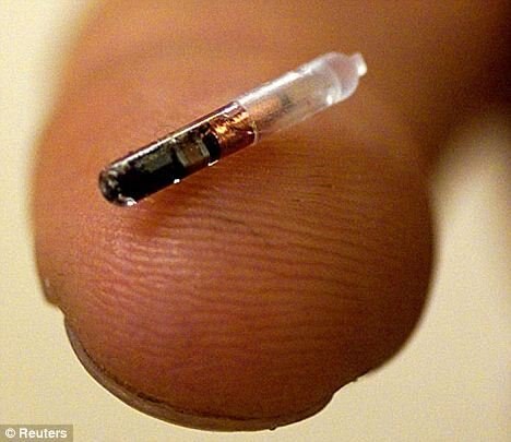

If your pet is micro-chipped, they have a tag using the same technology inserted under the skin.
