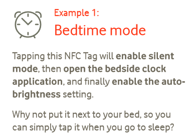

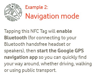

BUT the manufacturers included two stickers (tags) in with the phone.
One was a 'BED' tag, and the other a 'NAVIGATION' tag.
These are programmable, so you can modify what they control and then write it back to the tag.
So with some of these tags, I can stop having to access several menus to turn on and off the features I want.

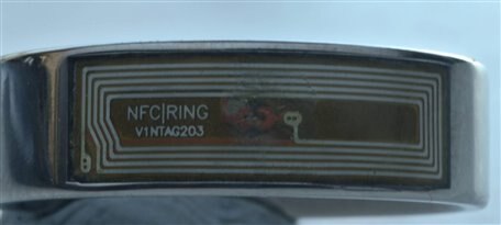

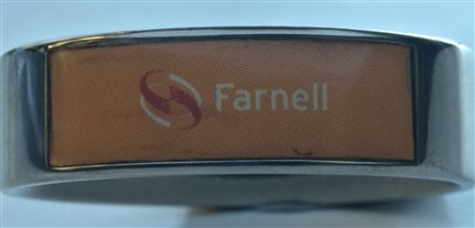

At the same time element14 had procurred some customised NFC Rings, and Dr Christian DeFeo kindly found one for me.
They are based on the signature range and feature a Public and Private tag.
Signature – NFC Ring
     photo source
http://store.nfcring.com/products/signature                                                       plus the 3 minions (me, myself and I)
Dudley    Dudley has used one to unlock his phone, but the early version app has now been upgraded.
My Experience with the NFC Ring
I initially tried them on the Nexus 7, and it was difficult to find the right spot.
With the wireless charging coil also on the rear, the NFC 'sweet spot' was tricky to find using just the ring.
Now that I have a few tags, I will revisit it in a future blog.
I have been able to read (and accidently write) my ring using my phone, but it is a little tricky.
One of the benefits of the ring is that a simple skimming exercise tends to energise both tags, meaning the data is corrupted or invalid.
This also means unless you hold your mouth just right, your valid reader can also pick up both tags.

    Wouldn't it be rather easy for someone to subtly swipe (both sides) of the ring in a crowded subway for example, copying your information without you noticing ?
    In theory if you held your mouth just right, then maybe, but if the reader is far enough away then its more likely to trigger both tags.
    When both tags are triggered, then both short their antenna which is passed back to the reader 1 bit (or half a bit) at a time.
    The two tags are described as 'private' and 'public' and I'm not sure if the antenna design (effective size) is the same.
    The ring is difficult to use (compared with other tags) and in the next post I'll do some distance checking.
    You could try it out with your two cats ...hold both tags near the reader and see if it works.
