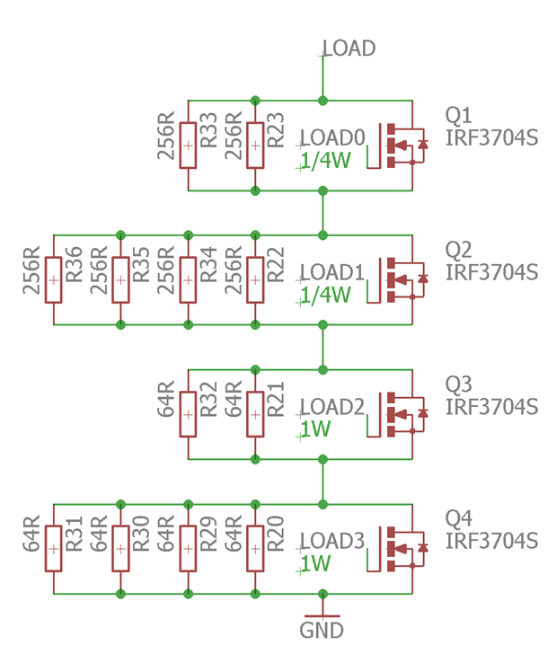

Morning all,
Query regarding shunting series resistors with MOSFETs to create a high power load...
System:
Up to a 10V source, capable of up to 5A peak, well under 1A continuous.  Source voltage decreases with time down to zero, I want to get as close to zero as possible without the resistance changing (i.e. the MOSFET changing state due to low gate voltage).
Requirement:
To be able to place a variable load across the source which is digitally controlled, ideally with MOSFETs not relays.
Question:
Most MOSFET drivers use a charge pump which is driven from the high side.  My high side changes, however.  Is there a way I can drive the MOSFET driver with a separate power source?
  • michaelkellett
    0 michaelkellett over 9 years ago
    I can't quite reconcile your spec with the schematic.
    What is the maximum voltage that will be applied at the point marked "LOAD" relative to GND ?
    Will the applied voltage always be positive.
    How fast must the MOSFETs switch on and off and how fast might the applied voltage at "LOAD" change.
    The MOSFET you have chosen will cope with a gate voltage ref. source of +/- 20V max.
    If, as I guess, the maximum applied voltage at "LOAD"  will only be 10V you can drive the MOSFETs with gate voltages of 15V and ensure that the topmost MOSFET will be well and truly on (13.5mR at 12A from the data sheet). If you don't need to switch fast you can use CMOS logic, open collector/drain transistor drivers with pull up resistors or op amps to drive the MOSFETs. The clever feature of MOSFET driver chips is that they can source and sink large currents but you only need this if you must switch the MOSFET on and off quickly or if there are very fast changes in drain voltage.

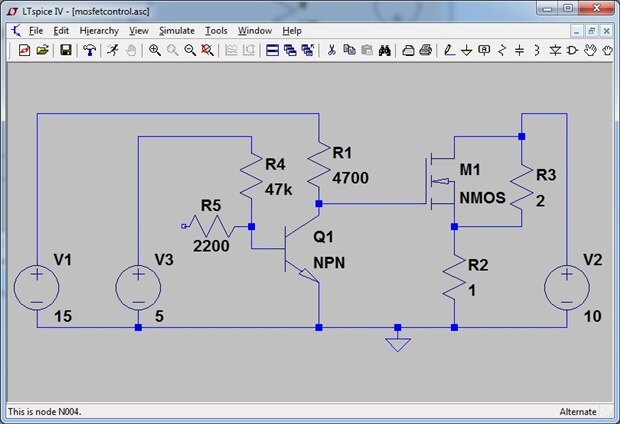

    Something like this would do:
    V2 is your supercap voltage, M1 is one of your MOSFETs, R2 limits the lowest load resistance you use.
    Apply the control voltage to the free end of R5, if you are using 5V logic this will work fine. If 3.3V logic then V3 needs to be 3.3V.
    If the micro starts up (I'm assuming this is controlled by a micro) with the drive to R5 open circuit then R4 turns on Q1 and makes sure that the MOSFET is off.
    Q1 needs a gain of at least 100 at Ic = 3mA.
    The MOSFET will be on if Q1 is off (input low) - V2 won't affect this (so long as it's less than 10V).
    You can have several MOSFETs in series each one will need its own drive transistor and associated resistors.
    MK

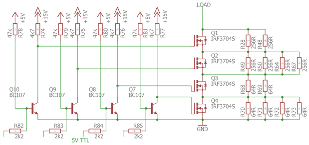

    0 e14 Contributor over 9 years ago in reply to michaelkellett
    Like this?
    Two questions:
    1. I get how Q4 will work, but how about the high side MOSFETs?  Will they not be permanently off as the gate-source voltage may be low/negative? e.g. if Q4 is on then the source voltage at Q3 would be pulled to 10V?
    2. You have V1 on your schematic as 15V.  Not sure where this has come from?  I am assuming this is a boost converter to solve the problem above?  In which case is this just a deconstructed high side MOSFET driver with the charge pump being powered from the Vlogic side rather than Vout?
    Many thanks
    Simon
  • michaelkellett
    0 michaelkellett over 9 years ago in reply to e14 Contributor
    If LOAD = 10V and all MOSFETs all off the voltage on Q1 source and Q2 drain =  10/(128 + 64 + 32 + 16)*(64 + 32 + 16) = 4.66V, if you now turn Q10 off the gate of Q1 will change form about 0.1V to 15V and Q1 will turn on.
    By using 15V for the gate drive positive voltage we can be sure that with a maximum of 10V on LOAD we never have less than 5V positive gate drive to turn a MOSFET on and that the off voltage (ref the MOSFETs source) will be between 0.1 and -10V.
    I'm not sure why you think Q4 on could result in Q3 source at 10V, if Q4 is on it will connect its drain and Q3 source to GND = 0V
    V1  = 15V is a DC supply that you must make somehow. It must be there all the time, independently of the load voltage. You could use a MOSFET drive if you pick one with a separate input pin for the high drive voltage - doing it with discrete parts makes it  more obvious what is going on.
    You really should have  a resistor in series with Q4 source and GND, otherwise if you accidentally turn all the MOSFETs on you will get  a very large current which may damage things.

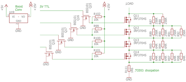

    Hi MK, again, thanks very much for replying.
    Yep, aware of the opamp route but it is a constant resistance I need, not constant current.  We'll be testing the supercap at different resistance loads (among other things).
    I'm not sure about the Q3/4 statement I made (it was late last night), sorry lol.  Please ignore!
    Thanks for the current spike point.  I have a few upstream components adding a bit of resistance but one has a peak load of 6A.  I have added a 1R6 resistor for now which reduces the spike to 5.9A.  I'll revisit this later and consider the dissipation as  that's going to be rather high.
    So taking the point about needing a separate 15V supply, and since the IRF3704 has a gate tolerant of +-20V, would this not be simpler with lower component count (space is a premium rather than cost) or am I missing something...
    Cheers
    Simon
    • Reject Answer
  • michaelkellett
    Using little MOSFETs as drivers is fine.
    BSS101 is obsolete with many people so I didn't find a  data sheet, 2N7000 would do fine.
    Is it really TTL levels (0.4 -> 2.6) or CMOS logic on 5V supply giving 0 -> 5V - probably doesn't matter but I didn't think anyone used TTL any more image
