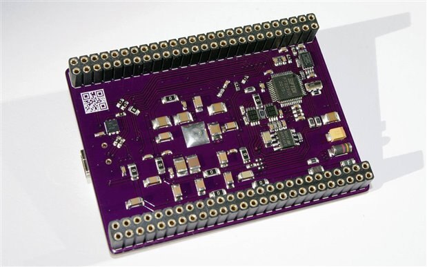

    well, i use FT2232H to program flash, while it's reseting main processor, because usually while processor is in reset, it has high-z output state on all pins (usually). But that means you have to connect to processor with 3 state bus driver, because when programming is done, it should not load bus.
    It should work for nor flash with 8b data bus, with spi flash i have no problems. That means you could use usb to load data, and use labview or write your own program to read hex data and download it do flash
    btw this board features ADSP-24189 running at 650MHz with native f32 supportimage
