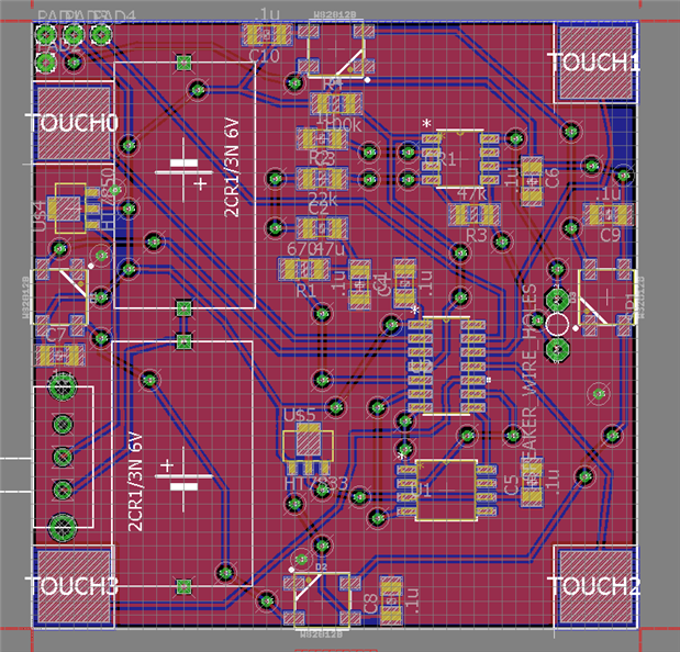

Looking for advice for designing a PCB with several functions.  I am an amateur PCB designer and only designed one other small board but it worked.
This project currently has the following features:
1.  5V & 3.3V power regulators.
2.  SPI signals from an ATTINY841-SU SOIC-14 MCU to a Dataflash SPI flash soic-8 IC.
3.  1W audio amplifier to external 8R .5W speaker.
4.  5x WS2812B surface mount Leds.
5.  5X capacitive touch pads (externally connected).
6 2x 6V  2CR1/3N2CR1/3N batteries in parallel
7.  2.25" square PCB, 2-sided, standard options.
I am looking for advice as to how to route the traces for best performance, I'm working with Eagle 8.3.2.  This a project for some gifts I am making for Halloween in a quantity of ~50.
I am mainly concerned about signal integrity and noise, especially the capacitive touch connections.  Currently I routed these last but there are many vias on these traces and I'm concerned that nearby external objects may affect the capacitance readings.  I could route these first on top with no vias but then the other signal traces are more complicated.  Is SPI sensitive to routing with several vias?  How about WS2812B data signals or small voltage audio signals?  How sensitive should I expect this system to be to routing overall?

    Why not post  a.pdf of where you are at the moment - much easier to understand.
    Don't use traces as thin as 0.005" (0.125mm) unless you reall need to go that thin (which I doubt). You'll get cheaper and more reliable boards if you use more relaxed design rules (with your parts I would try for 0.25mm track and gap to start with). Power traces should be wider, according to current.
    SPI from the ATTINY and connections to the WS2812B will stand a reasonable amount of vias, crossovers etc.
    You will do well to keep the tracks for the touch switches away from other tracks, especially ones with switching signals.
    Keep the audio signals away from the high speed switching signals.
    MK

    Ok, here we are, I couldn't export a pdf though:  There are vias on every signal I believe.  I haven't studied PCB design, but this board should be simple by most standards.  The speaker outline on the right is not used for mounting it's just to run the wires to it.  My approach was to run power first, keeping separate supplies to the major systems.  The WS2812s will draw the most current, I put them on their own 5V supply branch.  I am considering re-routing putting the cap-touch traces on top as a priority with no vias so they can't be influenced by objects near the bottom of the board enclosure.

    The best way to do this board would be to put the ground pour and all non-touch traces on one side and the touch traces and pad on the other. Remove the ground pour under the touch pads, it won't hurt under the traces. You probably couldn't route it like that but you might get very close.
    If you just want to tweak what you have now, then increase the gap between the ground pour and the touch traces, remove the ground pour under the touch pads.
    You could put U1 closer to U2 to shorten the SPI traces but they should be fine as they are. It might be good to get the pads in the top left corner further from the touch pad, same with the connector.
    If you want to post a schematic we can comment on that too !
    MK

    Thanks for your suggestions.  This is my first project with Eagle.  I am actually going to attach copper conductive adhesive tape to the touch pads, and the tape will attach to the externally mounted touch surfaces.  This device is just meant to be low cost and last a few weeks.  As far as the part spacing I was trying to keep it reasonably spaced to make assembly easier as I am doing it myself, thus the 1206 parts as well.
    Some more questions:
    1.  As the touch pads on the PCB are actually connection points for the tape do you still recommend removing the ground plane there?
    2.  Can you tell me what is printed on the silkscreen from the Eagle layers ?  I have a lot of text showing on the board from different sources but I just want the component names and outlines on the silkscreen layer like any normal board.  How do I set up the silkscreen like this?
    The schematic is large I need some time to figure out how to post it so you can see it.

    Any capacitance to ground will reduce the sensitivity of your touch system - if you are using a standard library and method defined by Atmel/Microchip for the ATiny then it will have supporting documentation and advice.
    I can't help you with Eagle because I don't use it.
    I find no problem with hand soldering 0603 parts, and I can do 0402 at a pinch but that isn't so much fun.
    If you are hand soldering a surface mount board there is very little penalty in placing components on both sides, so you could easily make this board half the size if you wanted to (batteries, speaker and touch connections on one side and everything else on the other).

    I just looked again at your batteries:
    Check the data here:
    https://www.duracell.com/en-us/techlibrary/product-technical-data-sheets?region=262&code=px28l
    This battery (and the Duracells will be better than most) offers most of its life at 5.2V or less - two in parallel to power your design doesn't seem right since you have a 5V regulator.
    MK

    Thanks, the batteries I received measure at 6.2V.  I think they may be a different chemistry because they can supply 80mA each and up to 250 peak.  Voltage quickly drops with current but I didn't want to risk hurting anything.  I will consider removing it after I test some prototypes.  I rerouted the board to keep the cap touch on the top layer with no vias and removed the ground plane from under the touch pads, but I have to confirm this is the right strategy because I am using a simple ADC based touch measurement that just utilizes the ADC internal capacitance to measure external capacitance.  I was wondering if you have ever made a device with a spiflash memory because I have a problem which is if I leave the chip connected to the MCU by SPI then if I program the MCU the data on the spiflash is getting erased, even though the spiflash write-protect pin is asserted.
