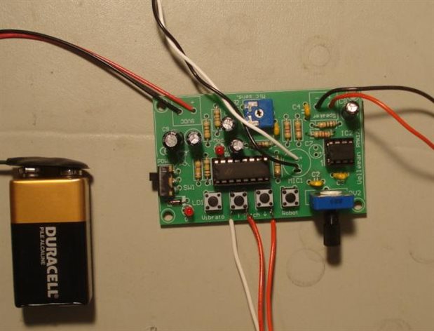

The audio processing module is a voice changer kit available to purchase from various places, like for example on amazon.com:
http://www.amazon.com/Velleman-MK171-Voice-Changer/dp/B004XZQ6RE/ref=sr_1_13?ie=UTF8&qid=1440257874&sr=8-13&keywords=voice+changer
Here is a picture of my audio processing board:
I have modified this kit by adding an audio line-in and an audio line-out connectors instead of soldering a microphone and a speaker to the board.
In order to control this kit with TTL pulses instead of pressing the buttons I had to solder two wires on the high pitch and low pitch switches and one on the ground.  These signals are normally pulled-up and they need to be driven low to get the same effect as pressing the buttons, but because FRDM-KL05Z board operates at 3.3V and the voice changer kit at 5V I couldn’t connect directly these wires to the FRDM-KL05Z outputs.  To solve this issue without adding level shifters, I inserted a diode in series with the wire.  The diode allows pulling down the node but blocks the 5V coming into FRDM-KL05Z when the signal is not asserted.

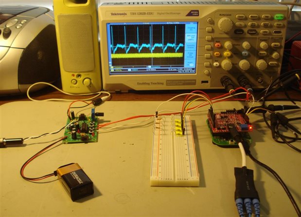

Some Experimental Results
To be able to see aberrations in the ECG during these experiments I intentionally lowered the compare window margins in the code, so that the project became more sensitive to small perturbations or variations of heart activity.  Here are some pictures of the four types of ECG aberrations detected by this system:
We notice in this picture the ECG signal displayed on the Tektronix 1202B-EDU oscilloscope by the blue trace.  There is no aberration detected and the yellow signal that shows what is sent to the audio processing module has no pulses.  Also all four LEDs are OFF.
We notice in the picture that the timing between the two R-wave peaks marked with pink in the figure is slightly shorter than the previous heart rate cycle.   The program code running in the FRDM-KL05Z module detect this small difference, turns ON LED1, and sends three digital pulses to increase of pitch of the audio signal followed by another three pulses that would decrease back the pitch to normal.
These pulses are shown by the yellow trace on the TBS1202B-EDU oscilloscope.  The yellow signal actually represents two TTL type digital signals encoded here this way since I did not have a third measuring channel on this oscilloscope.  So to visualize the moments when the high pitch and low pitch pulses are sent with reference to the ECG analog signal I built this simple circuit structure:
so the high pitch control pulses are attenuated by a factor of 1/3 and the low pitch pulses are attenuated by a factor of 2/3, and both these attenuated signals are mixed in the same output signal.  So on the yellow waveform, the first group of three pulses represents the TTL pulses sent to increase the sound pitch and the second group of pulses with larger amplitude represents the TTL pulses sent to decrease back the sound pitch.
