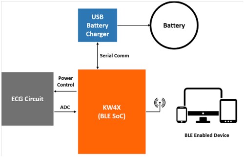

Bluetooth Low Energy Heart Rate Monitor (Reference Design)
The BLE Heart Rate Sensor is a portable device operated by a rechargeable battery. It includes the proper circuitry to obtain and process ECG signals for heart rate calculation. A SoC that includes a M0+ core microcontroller and a BLE radio acquires processes and reports the gathered information via BLE to an enabled Smartphone or device.
The ECG signal is obtained from the finger tips and processed by the Kinetis KW40Z SoC Then the user’s heart rate is calculated and transmitted to a smartphone application using BLE The reference design can be powered by a Li-Ion coin-cell battery Due to the low-power features of Kinetis KW40Z MCU a 3.6V 200mA/h Li-Ion coin-cell rechargeable battery can provide the power of up to 40 hours of continuous use The NXP  MC34671MC34671 is in used as a battery charger solution for the device
The Heart Rate Sensor application implements a GATT server and the following profile and services:  Heart Rate Profile v1.0
  • Heart Rate Service v1.0
  • Battery Service v1.0
  • Device Information Service v1.1
The application behaves as a GAP peripheral node. It enters the GAP General Discoverable Mode and waits for a GAP central node to connect. When the collector configures notifications, the sensor starts sending heart rate measurements every second.

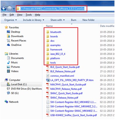

After installing, you will find below resources inside the connectivity software path:

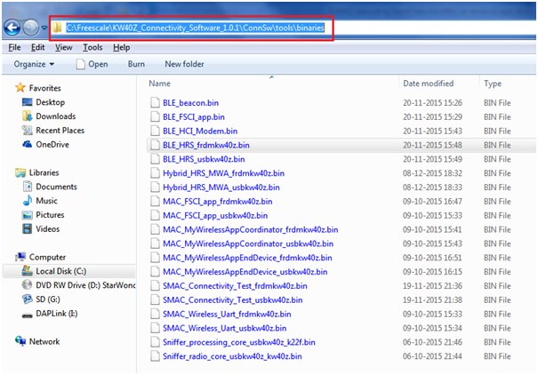

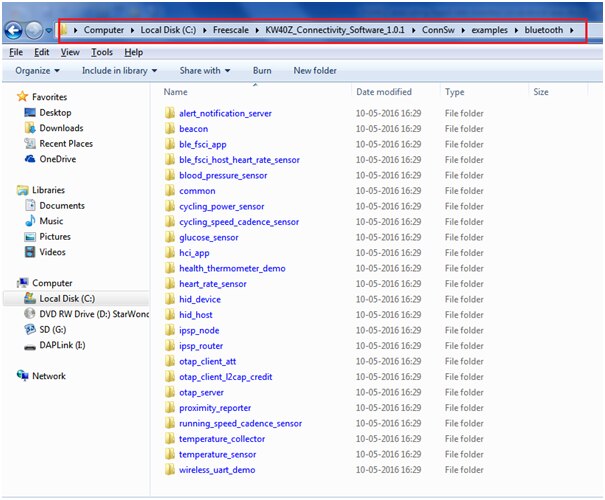

The example projects are been located in below link:
C:\Freescale\KW40Z_Connectivity_Software_1.0.1\ConnSw\examples\bluetooth
There are two options in executing the Heart rate sensor example project:
1) Build and Run a Bluetooth LE Example Application.
      or
2) Flashing a Binary Image File without Using an IDE. Use the precompiled binary provided by KW40Z Connectivity Software which is located at
“C:\Freescale\KW40Z_Connectivity_Software_1.0.1\ConnSw\tools\binaries”

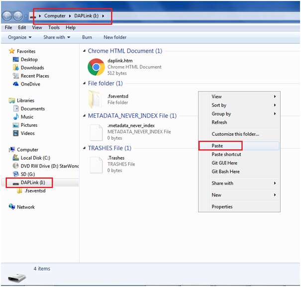

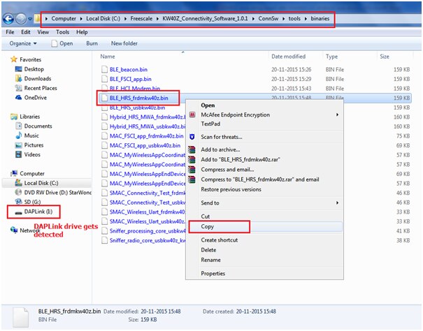

In order to flash the corresponding binaries to the  FRDM-KW40ZFRDM-KW40Z board the best approach is to use the OpenSDA on-board interface CMSIS-DAP Mass Storage Device functionality by simply dragging and dropping the binary image in the mass storage drive exposed by this OpenSDA firmware

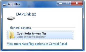

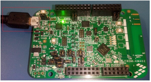

Plug on the frdm-kw40z hardware board to your computer via usb cable
After plugging in you will get the below AutoPlay DAPLink window (you board gets detect as DAPLink drive)
Open the DAPLink folder and copy paste the “BLE_HRS_frdmkw40z.bin” file from the location “C:\Freescale\KW40Z_Connectivity_Software_1.0.1\ConnSw\tools\binaries”
Now paste this file into the DAPLink folder as shown below:
Now your target board is ready to execute

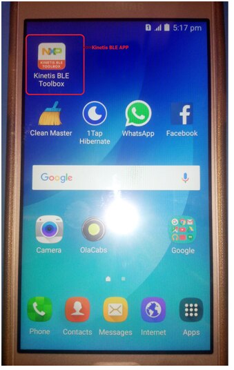

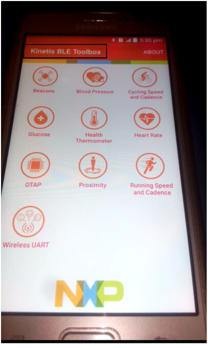

I have installed Kinetis BLE Toolbox Android app on Samsung smart phone as shown below:

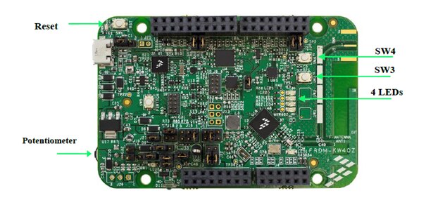

After flashing the board, the sensor is put in deep sleep (all 4 LEDs are off). To wake up and start advertising, press the SW4 button. When in GAP Discoverable Mode, the LED1 is on. When the central node connects to the peripheral, LED1 remains solid.
To disconnect the node, hold the SW4 button pressed for 2-3 seconds. The node re-enters the GAP Discoverable Mode when the SW4 button is pressed again.

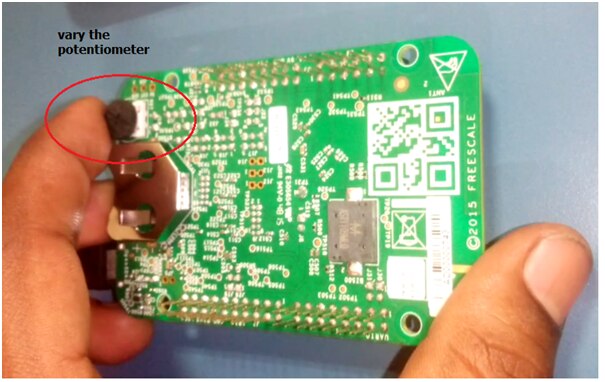

By default the heart rate value format is set to 8 bits and the contact status is on.
To vary the heart rate value, use the potentiometer on the back of the board.
To make the Heart Rate Sensor visible, press the SW4 button to start sending advertisements. The sensor name “FSL_HRS” shows on the device when its scanning is active. A solid LED1 indicates a successful connection between the two devices. Hold the SW4 button pressed for 2-3 seconds anytime to get the sensor to initiate disconnect.

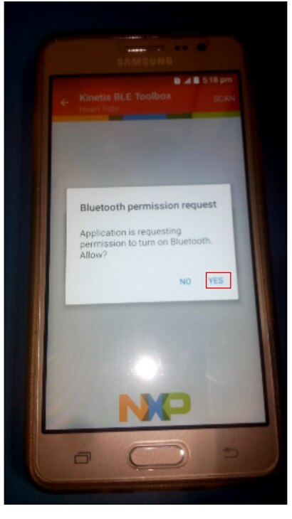

Step-2: open the Kinetis BLE Toolbox app in your smart phone, for the first time it will ask its Bluetooth to switch on
Now your app will look like as shown below:

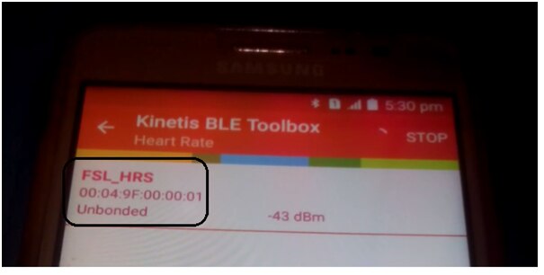

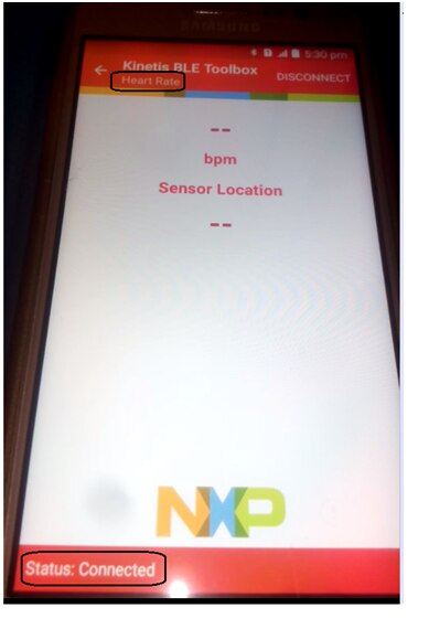

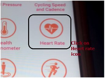

Step-3: Click on Heart rate icon
Step-4: You can find “FSL_HRS” Bluetooth device on the App as shown below:
Click on FSL_HRS to select this device. Then you can see the status as connected as shown below:

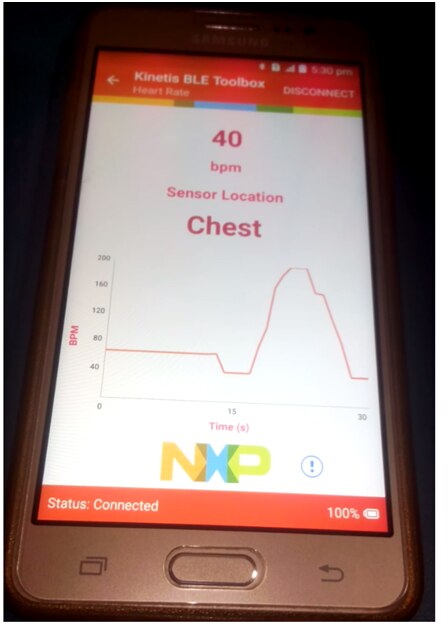

Step-5: Now vary the potentiometer to see the sensor value as shown below:
You can see the corresponding graphical value on the app as shown below:
