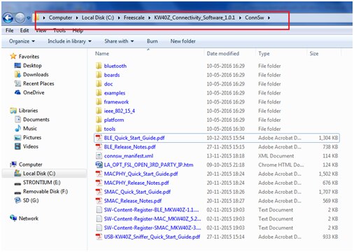

After installing this software you will find the resources at  “C:\Freescale\KW40Z_Connectivity_Software_1.0.1\ConnSw”
This folder contains all the necessary Bluetooth driver information’s, example projects, platform library, tools, framework and board related header files

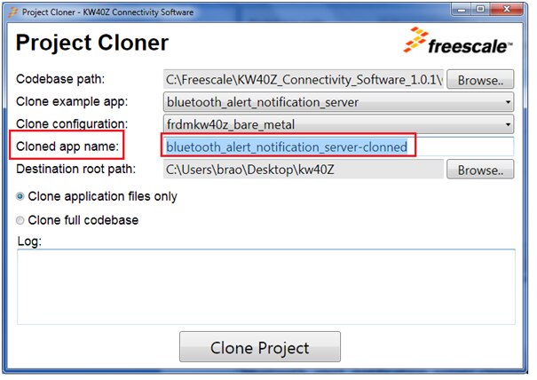

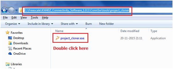

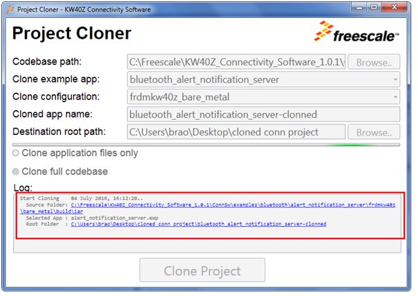

Navigate to the below path “C:\Freescale\KW40Z_Connectivity_Software_1.0.1\ConnSw\tools\project_cloner” And run the project cloner application

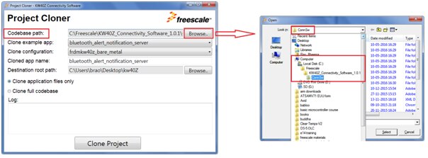

Now we need to select the path for “codebase path” as shown below
We need to select “C:\Freescale\KW40Z_Connectivity_Software_1.0.1\ConnSw” as its path

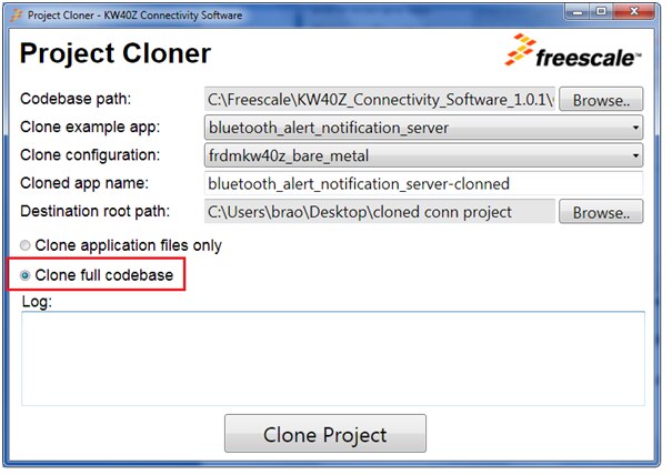

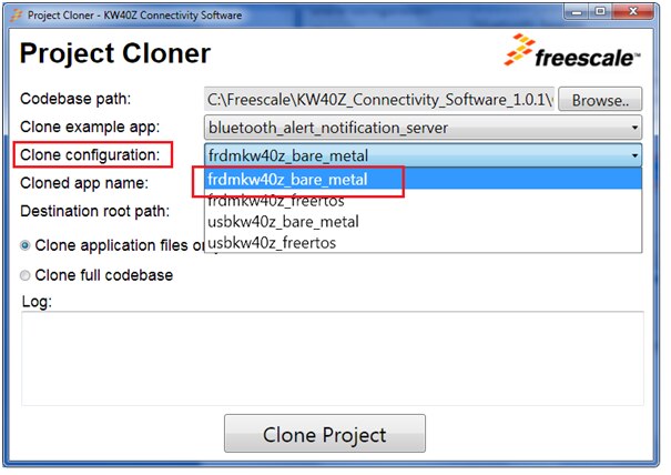

Next select the example application to be cloned (Clone example app), and the desired configuration (Clone Configuration).
Here i have selected “bluetooth_alert_notification_server" as project needed to be cloned
Next in clone configuration select “frdmkw40z_bare_metal” as shown below
Under cloned app name provide name of your choice i have given it as “bluetooth_alert_notification_server-clonned”
And select the destination folder where the project needs to be saved
I am saving this project under a folder “C:\Users\brao\Desktop\cloned conn project”
By default the Project Cloner will clone only application files (board specific files and example app files). To clone all the files, select the Clone full codebase radio button.

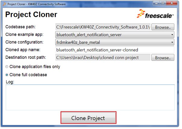

Now press the Clone Project button to start the cloning process. The log window will display “Cloning completed” when the process ends.
You can see the process starts and logged information can be seen as shown:

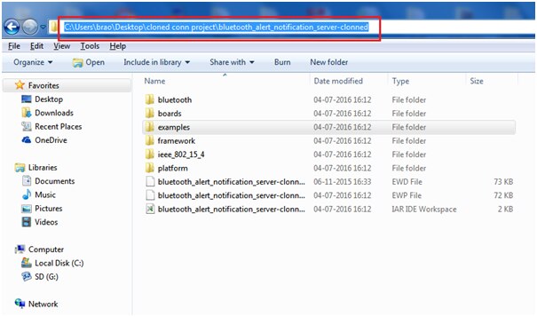

You can see the cloned project in folder “: C:\Users\brao\Desktop\cloned conn project\bluetooth_alert_notification_server-clonned”

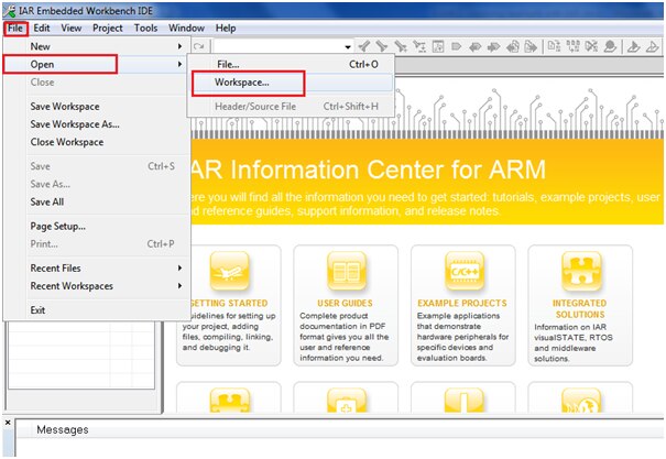

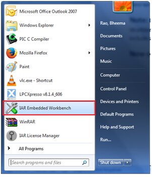

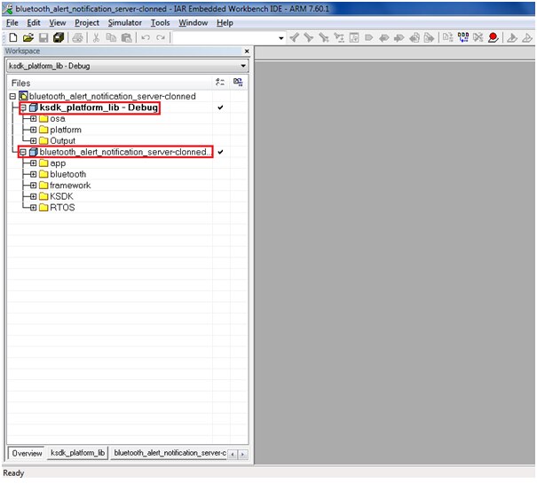

Now open IAR IDE tool

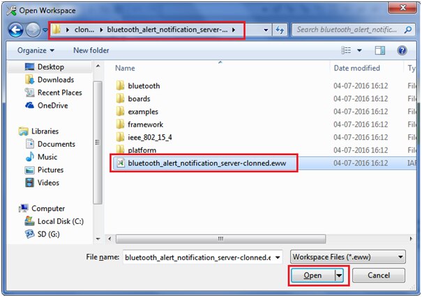

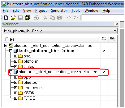

Open the cloned IAR workspace “bluetooth_alert_notification_server-clonned.eww” from below location
“C:\Users\brao\Desktop\cloned conn project\bluetooth_alert_notification_server-cloned”
After opening in IAR the project folder looks as below:

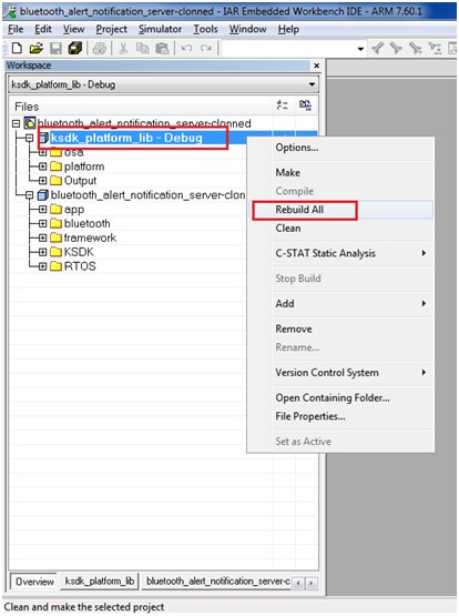

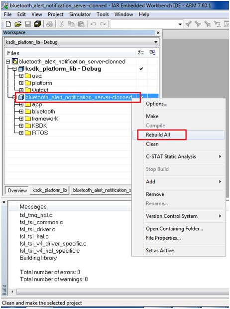

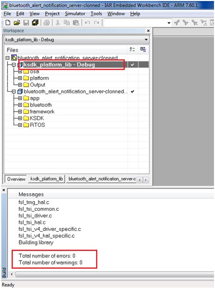

The KSDK platform libraries are RTOS dependent, so appropriate libraries must be built for the selected RTOS. For any connectivity application, the following Kinetis SDK libraries must be built with the IAR Embedded Workbench for ARMRegistered in order to enable the complete board support and RTOS kernel support:
Select the KSDK platform (bare-metal) library project
Build the KSDK platform library project.
It builds with zero error

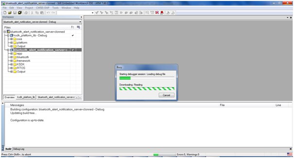

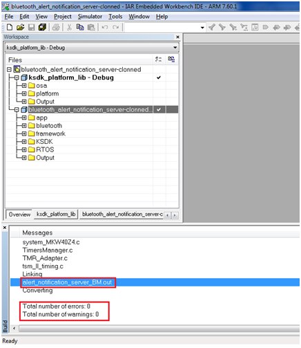

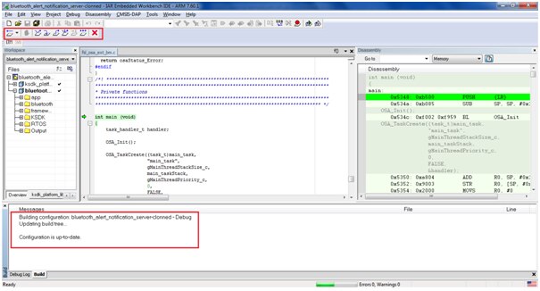

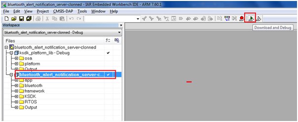

Next Select the “bluetooth_alert_notification_server-clonned” project and build it as did earlier
It builds with zero error and an executable *.out is generated
Debugging the cloned project:

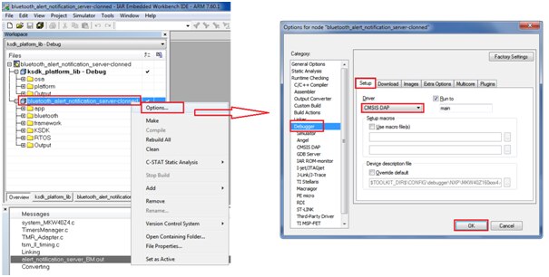

Make the appropriate debugger settings in the project options window:
The projects are configured with “CMSIS-DAP” firmware as the default debug configuration. Please make sure that your board’s OpenSDA chip contains a CMSIS-DAP firmware or that the debugger selection corresponds to the physical interface used to connect to the boards.
Now connect the board and Click the “Download and Debug” button to flash the executable onto the board.
You can see below project execution on IAR tool
You can start debugging the project by clicking on single stepping (step over, step into, step out) or directly you can click on “go” to execute the project
