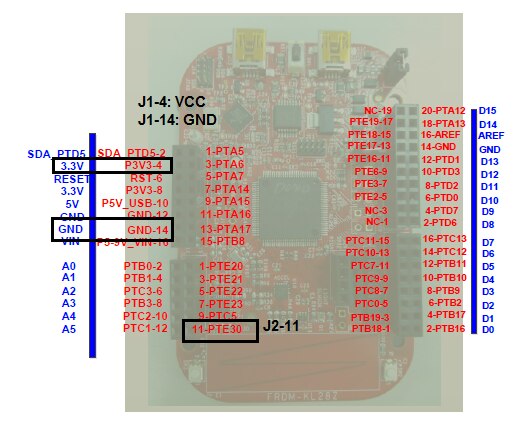

ADC port is assigned to ADC0-SE23 -> PTE-30 which is located on jumper J2-11as shown below:

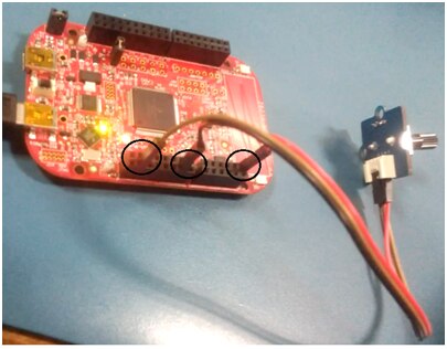

The potentiometer connection is done as shown below

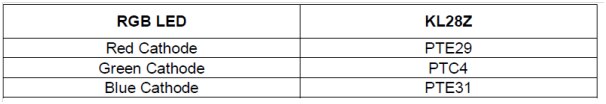

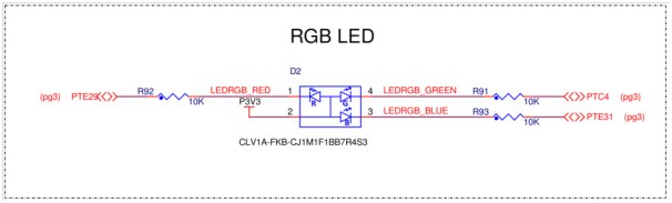

RGB led’s are connected as shown below

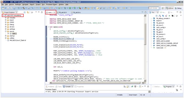

Software code for this project is given below:
  Add below lines in main.c file
#include"fsl_debug_console.h"
#include "board.h"
#include "fsl_adc16.h"
#include "pin_mux.h"
#include "clock_config.h"
#include "fsl_port.h"
#include "fsl_gpio.h"
#include "fsl_common.h"
#define DEMO_ADC16_BASE ADC0
#define DEMO_ADC16_CHANNEL_GROUP 0U
#define DEMO_ADC16_USER_CHANNEL 23U /* PTE30, ADC0_SE23 */
int main(void)
 adc16_config_t adc16ConfigStruct;
 adc16_channel_config_t adc16ChannelConfigStruct;
 BOARD_InitPins();
 BOARD_BootClockRUN();
 BOARD_InitDebugConsole();
 CLOCK_EnableClock(kCLOCK_PortE);
 CLOCK_EnableClock(kCLOCK_PortC);
 PORT_SetPinMux(PORTE, 29U, kPORT_MuxAsGpio); //RED
 PORT_SetPinMux(PORTC, 4U, kPORT_MuxAsGpio); //Green
 PORT_SetPinMux(PORTE, 31U, kPORT_MuxAsGpio); // Blue
 LED_RED_INIT(LOGIC_LED_OFF);
 LED_GREEN_INIT(LOGIC_LED_OFF);
 LED_BLUE_INIT(LOGIC_LED_OFF);
 int val,i;
 PRINTF("\r\nADC16 polling Example.\r\n");
 ADC16_GetDefaultConfig(&adc16ConfigStruct);
 ADC16_Init(DEMO_ADC16_BASE, &adc16ConfigStruct);
 ADC16_EnableHardwareTrigger(DEMO_ADC16_BASE, false); /* Make sure the software trigger is used. */
 #if defined(FSL_FEATURE_ADC16_HAS_CALIBRATION) && FSL_FEATURE_ADC16_HAS_CALIBRATION
 if (kStatus_Success == ADC16_DoAutoCalibration(DEMO_ADC16_BASE))
 PRINTF("ADC16_DoAutoCalibration() Done.\r\n");
 else
 PRINTF("ADC16_DoAutoCalibration() Failed.\r\n");
#endif /* FSL_FEATURE_ADC16_HAS_CALIBRATION */
 adc16ChannelConfigStruct.channelNumber = DEMO_ADC16_USER_CHANNEL;
 adc16ChannelConfigStruct.enableInterruptOnConversionCompleted = false;
#if defined(FSL_FEATURE_ADC16_HAS_DIFF_MODE) && FSL_FEATURE_ADC16_HAS_DIFF_MODE
 adc16ChannelConfigStruct.enableDifferentialConversion = false;
#endif /* FSL_FEATURE_ADC16_HAS_DIFF_MODE */
 while (1)
 //GETCHAR();
 for(i=0;i<=1000000;i++);
 ADC16_SetChannelConfig(DEMO_ADC16_BASE, DEMO_ADC16_CHANNEL_GROUP, &adc16ChannelConfigStruct);
 while (0U == (kADC16_ChannelConversionDoneFlag &
 ADC16_GetChannelStatusFlags(DEMO_ADC16_BASE, DEMO_ADC16_CHANNEL_GROUP)))
 val = ADC16_GetChannelConversionValue(DEMO_ADC16_BASE, DEMO_ADC16_CHANNEL_GROUP);
         if((val >= 0) && (val <= 1200))
            LED_RED_ON();
            LED_GREEN_OFF();
            LED_BLUE_OFF();
         if((val >= 1200) && (val <= 2500))
                   LED_GREEN_ON();
                   LED_RED_OFF();
                   LED_BLUE_OFF();
         if((val >= 2500) && (val <= 4095))
               LED_BLUE_ON();
               LED_GREEN_OFF();
               LED_RED_OFF();
 PRINTF("ADC Value: %d\r", val);
The project has been implemented using KDS+KSDK
