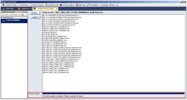

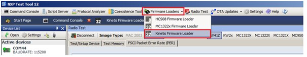

Open Test Tool software and connect one of the board to your computer, click on Firmware loader and select kinetis firmware loader option as shown:

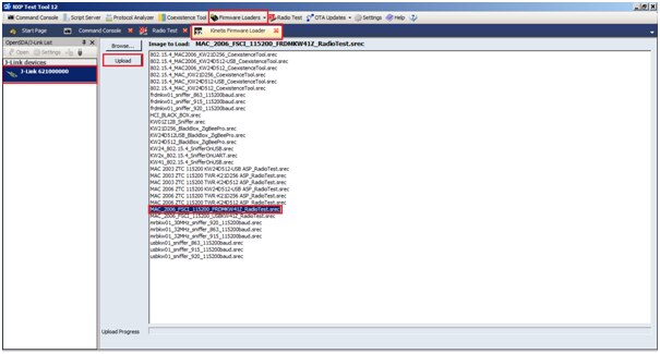

Next select “MAC_2006_FSCI_115200_FRDMKW41Z_RadioTest.srec” file to be loaded and click on upload the file

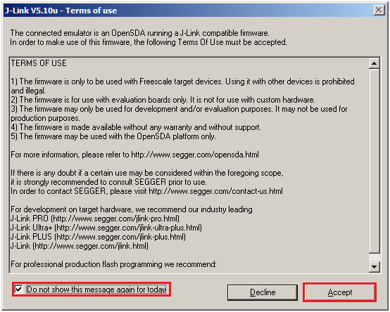

First time user will get below J-link firmware update click the selection as shown:
Now your board will get programmed as shown below:
You can unplug the board and connect the second board to program as we did earlier with first one.

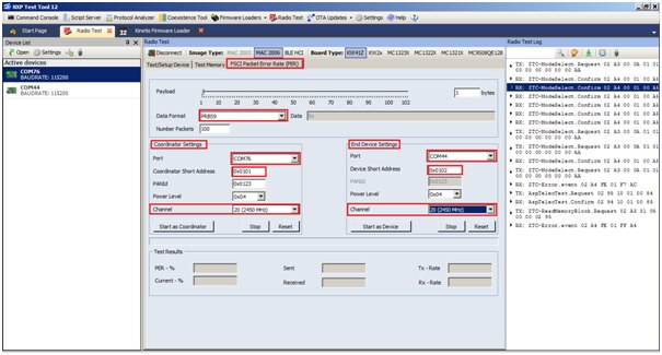

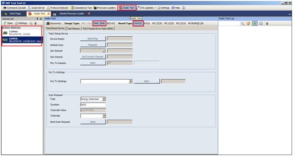

Now click on Radio Test button as shown below:
You can see both the boards have been detected in device list:
You need to select one board as coordinator and other as End Device as shown

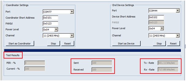

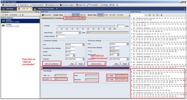

Once selection is done first click on start coordinator and then click on Start as Device

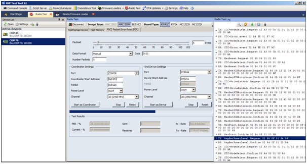

You can see the progress status of packet error rate test
The result can be seen on Test result column as shown below:
