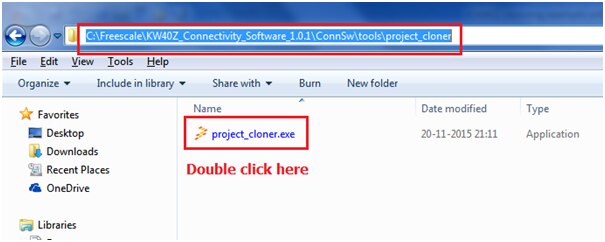

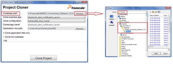

1) Cloning a project: run the Project Cloner application (ConnSw\tools\project_cloner\project_cloner.exe)
2) Building the Binaries using IAR
3) Executing the project using generated binaries
Step -1: Cloning a project
Navigate to the below path
“C:\Freescale\KW40Z_Connectivity_Software_1.0.1\ConnSw\tools\project_cloner”
  And run the project cloner application

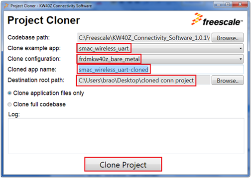

Now we need to select the path for “codebase path” as shown below
We need to select “C:\Freescale\KW40Z_Connectivity_Software_1.0.1\ConnSw” as its path

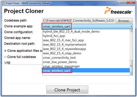

Next select the example of wireless uart application to be cloned (Clone example app), and the desired configuration (Clone Configuration).
Under cloned app name provide name of your choice i have given it as “smac_wireless_uart-cloned” and other options as shown below:
And select the destination folder where the project needs to be saved
I am saving this project under a folder “C:\Users\brao\Desktop\cloned conn project”

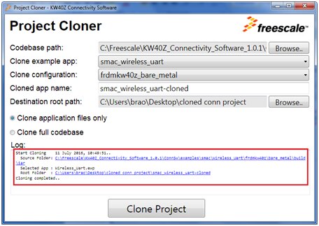

After cloning you can see the data logging of cloning process

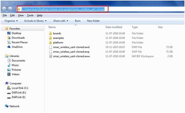

You can see the cloned project in folder
“C:\Users\brao\Desktop\cloned conn project\smac_wireless_uart-cloned”

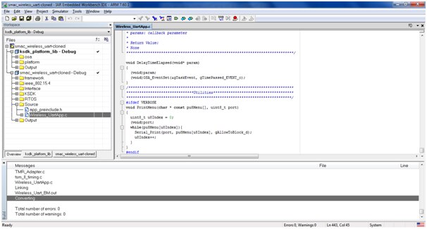

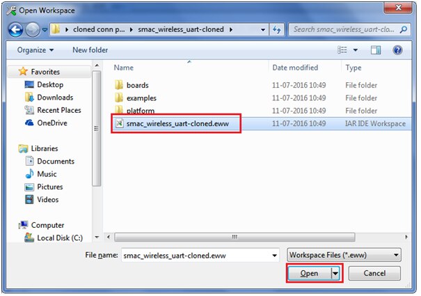

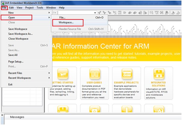

Open IAR Tool
Open the cloned IAR workspace “smac_wireless_uart-cloned.eww” from below location

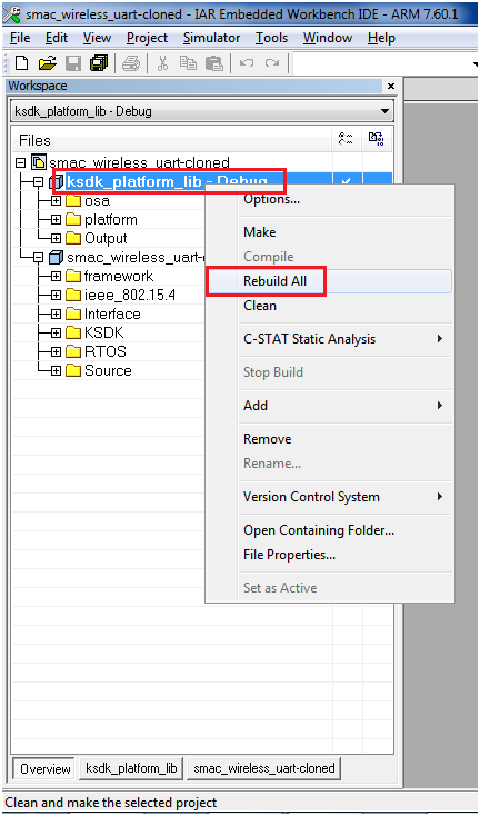

The KSDK platform libraries are RTOS dependent, so appropriate libraries must be built for the selected RTOS. For any connectivity application, the following Kinetis SDK libraries must be built with the IAR Embedded Workbench for ARMRegistered in order to enable the complete board support and RTOS kernel support:
Select the KSDK platform (bare-metal) library project and Build the KSDK platform library project.
It builds with zero error

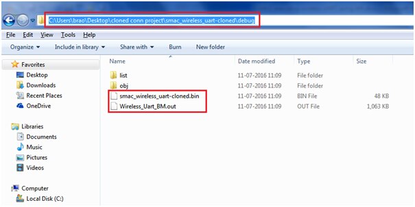

Next Select the “smac_wireless_uart-cloned” project and build it as did earlier It builds with zero error and an executable *.out is generated
Step-3 Executing the wireless uart using the generated binaries
We need two  FRDM-KW40ZFRDM-KW40Z boards to execute this project The binaries are located in the below folder
“C:\Users\brao\Desktop\cloned conn project\smac_wireless_uart-cloned\debug”

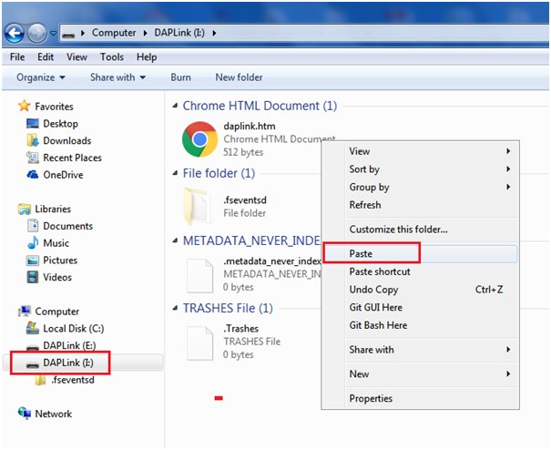

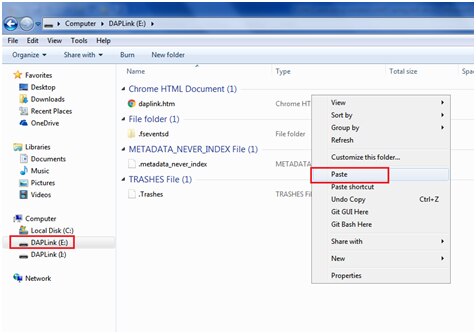

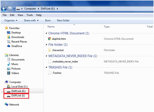

Now connect both the boards when connected we can see it in explorer as shown
Now copy the generated “smac_wireless_uart-cloned.bin” file from debug folder and paste it into both the DAPLink foders as shown below:
And to the other board's DAPLink

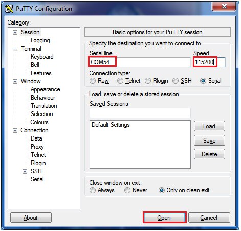

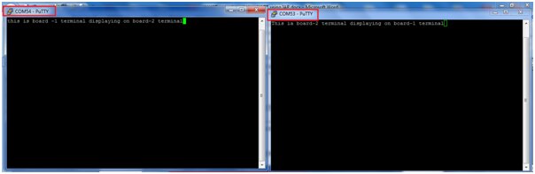

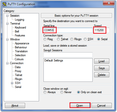

Now open the Putty hyperterminal:

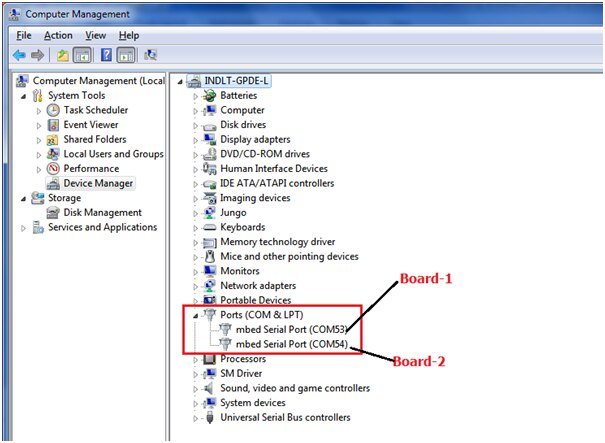

You can see both the boards in device manager listed under ports (COM & LPT)
COM53 board-1 settings:
COM54 board-2 settings:
After flashing the board, the device is in idle mode (all 4 LEDs flashing). To start scanning, press the SW4 button. When in GAP Limited Discovery Procedure of GAP General Discoverable Mode, LED1 is flashing. When the node connects to a peer device, LED1 turns solid. To disconnect the node, hold the SW4 button pressed for 2-3 seconds. The node then re-enters GAP Limited Discovery Procedure.
The application is built to work with a similar application on a different device.
The start screen is blank after the board is reset.
Press the SW4 button on the first board to start scanning for devices. Do the same on the second board. After 5 seconds, the first board enters GAP General Discoverable Mode and the second board connects.
As soon as the LED1 turns solid on both devices, the user can start writing in one of the consoles. The text appears on the other terminal, as shown in the figure below.

    Correct, I just wanted to make the clarification that the SMAC version of the Wireless UART is not Bluetooth Low Energy. In other words, SMAC Wireless UART uses the 802.15.4 radio part of the KW40Z and NOT BLE.

    Hello bheemarao,
    It is great guidance to be able to use FRDM-KW40Z. Nevertheless, I guess there was a confusion about the Wireless UART project you are showing to clone. There are two kind of Wireless UART examples in the KW40Z Connectivity Software. One is related to SMAC, which is a lightweight protocol based on 802.15.4 standard. The second one is related to BLE, which I guess it is the one you wanted to explain in this thread. All, instruction are correct, they would be the same just that the example project you need to select is the one related to BLE which is named "bluetooth_wireless_uart_demo". Hence, the next figure shows what should be selected to clone a BLE Wireless UART Project.
    Thanks and best regards,
    Miguel
