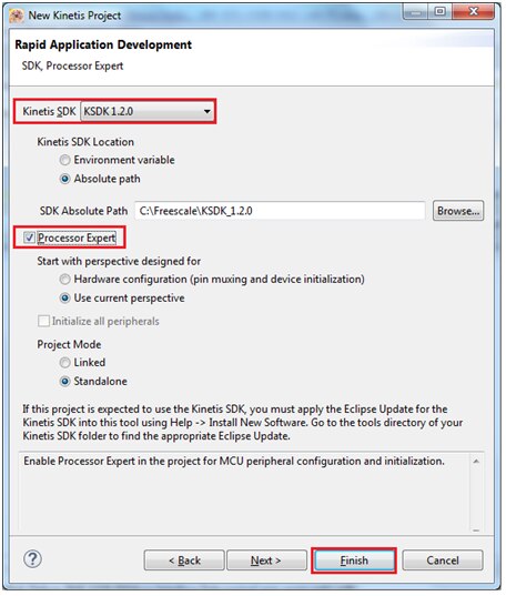

In the next screen you can find below options to be selected in Rapid Application Development window
Select the check box “Kinetis SDK”
And select the radio button “Environment variable” by which default it displays “KSDK_PATH” which is in installed directory.
Make sure that "Processor Expert" is checked as we are creating project using processor expert option.
Next click Finish button and proceed further.

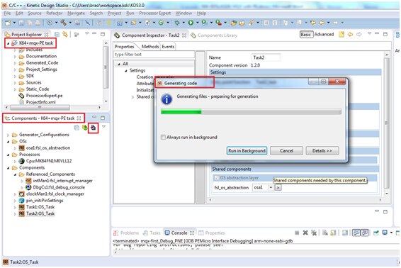

Click the Generate Processor Expert Code button.
You can see configuration files are updated while code generates as shown below:
The task reference code is generated in os_tasks.c as shown below
