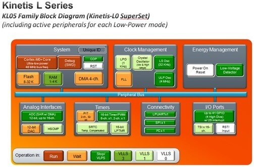

Then the block diagram below gives a detailed view of the peripherals embedded in the KL05 MCU featured on the FRDM-KL05Z
The FRDM-KL05Z is based on a MKL05Z32VFM4 device, which is a 32KB Flash, 4KB RAM, 32 QFN version.
