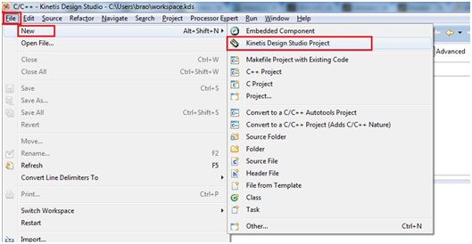

Next create a New project by clicking
File -> New  -> Kinetis Design Studio Project

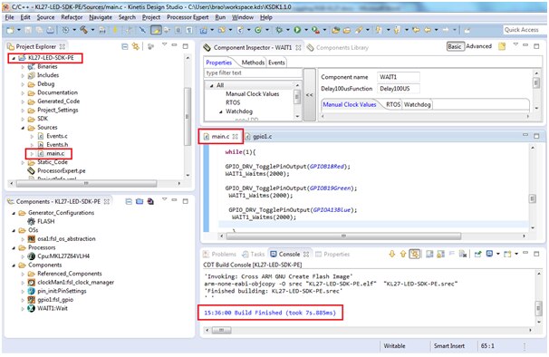

The project has been created with processor expert options included (i.e component window) and the project window looks like as shown below:

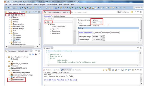

Next we need to add the component for gpio functionalities,
Select fsl_gpio from component library as shown:

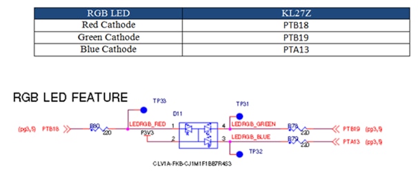

As we know the LED’s have been connected to the board as shown below:
Click on fsl_gpio component to assign the 3 port pins as output connected to Led

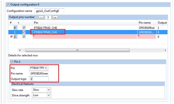

Next select on Output pins > Output configurations option and press on ‘+’ button to increase the output pin numbers
Now select the first configuration and change the port pin setting to PTB-18 connected to Red LED, Rename this as ‘GPIOB18Red’
Similarly make the settings for the second one connected to PTB-19 port pin which is Green LED. Rename it as ‘GPIOB19Green’

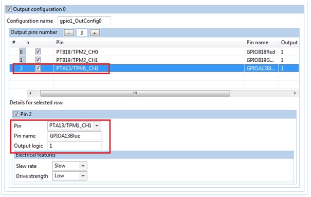

We are assigning PTA13 for blue led and make the below settings:
In all the three settings we have assigned Output logic = 1 (since LED is active Low connection)

Now add the component wait() which is used to insert some delay routines in our program
As our project creation is by using processor expert we need not have to add any board related header folders to the project, those all required files are been taken care by processor expert itself.
These files have been generated in “Generated_Code” folder as shown below
Now to ensure our project is created without errors we will build it once
It builds with no error

You can see these LED’s are connected in active-Low connection, i.e common Anode, we should provide Low signal to port pins to glow a LED.

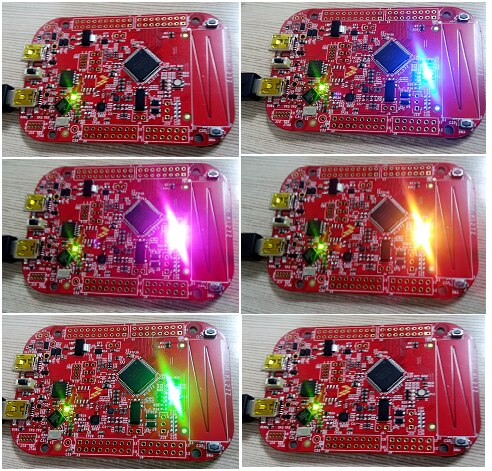

Now we shall toggle all the 3 LED’s one by one with some software delay() i.e blue is on for some time then blue+red is on for some time then blue+red+green is on for some time, this is one cycle of toggling pins and next time reverse happens i.e red+green is on (blue = off) and green is on (blue, red = off) then green also off (all the 3 led’s are off) this sequence loops back.

Now it’s time to clean and compile/Build the project
You can see the build output as shown below:

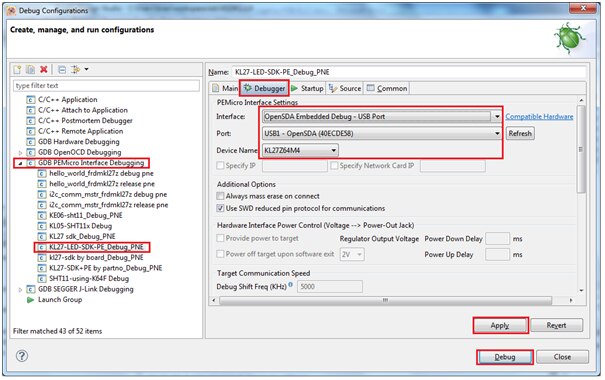

Now we need to setup for Debug configuration:
As a pre-requisite the board is loaded with OpenSDA provided in “FRDM-KL27-QSP.zip”
Select ‘GDB PEMicro interface Debugging’ and double click or right click and select ‘New’
You can see a default name as project name as shown below: make sure under ‘Main’ tab C/C++ application there is *.elf file name of your project.
Next click on Debugger tab check the interface is selected to OpenSDA and port is assigned as shown below
(make sure you have connected the board to PC via USB mini connector to “Open SDA” J-13 jumper of the board)
Now you can see the Debug window opens ready for single stepping or Running the project as shown:
Click on Resume button or press ‘F8’ button for executing the project.
You can see the output as shown
Attached is the video recording of the project execution.
