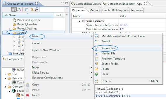

Using the Component in your Code
At this point, go back to the C/C++ Perspective and click Project->Build Project (don’t forget to select the project in the left side view first). Build Project will (amongst other things) perform these steps behind the scenes:
1. It will take the output from PE, auto-generate C files and compile them
2. It will compile your own code
3. It will link up all the individually-compiled files and make a single executable file that you can download to the board.
At this stage, although everything above will occur, we are only interested in using the Build Project for item 1 listed above, because we want to see the auto-generated files as a result of adding the 'Individual pins' I/O component earlier.
You’ll see in the Generated Code folder that some new files got created:
To use the feature, you’ll need to know what functions and events you can make use of. There are several ways to do this. One way is to right-click on the component and select Help on Component. There is lots of information including examples for many peripherals.
Another way is to click on Methods in the Component Inspector and you’ll see a list of them all, as shown here:
Or, you could double-click on the generated code files, and inspect the comments in the header file, or look at the C source file. Yet another way is to just hover over the names in the Components view, and some help will float on top.
The main() function actually has already been created, it is in a file under Sources called ProcessorExpert.c and if you open the file you can scroll down to it and find where it says ‘Write your code here’.
At that location, it is possible to drag the PutVal method directly into the C file.
The screenshot above shows what happens when you drag it across. The floating text occurred by hovering over the method in the Components view and it shows that a single parameter (bool Val) is required. The code was tidied up to look like this (a while loop to blink with a delay):
/* Write your code here */
/* For example: for(;;) { } */
int ledstate=0;
int i;
while(1)
     Bit1_PutVal(ledstate);
     ledstate=ledstate^1;
         for (i=0; i<100000; i++);
  /*** Don't write any code pass this line, or it will be deleted during code generation. ***/
Then, the code was saved and the project built again.

    mcb1 over 13 years ago +1
    shabaz Very nice and clear step by step instruction. I presume the "Build-Project" is a way to piece all the bits together for the software, which then allows you to write using those pieces.? Rather like…
    shabaz over 13 years ago in reply to mcb1 +1
    Hi Mark, Thanks! I wanted to document while it was fresh in my head, because I know I will have to relearn this again in a few days time if I don't! I should have mentioned that part in some more detail…
    It took a few hours, but I eventually figured out the PE settings in order to use the LCD component. It turns out I was misinterpreting how to use the function that selects which segments to display. I…
