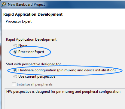

Click Next until you see a ‘Rapid Application Development’ screen. Here you can enable PE:

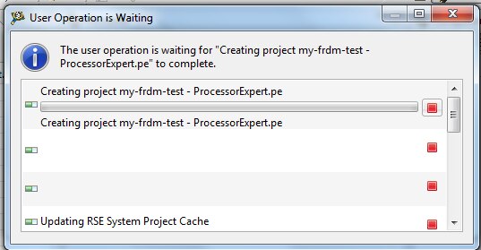

You may see this message occasionally with Eclipse. Just wait for it to disappear.

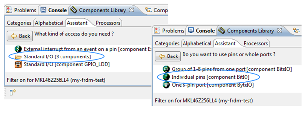

There are different ways of finding the feature that you want to add. In this example, go to Assistant and then scroll down to Digital input/output, double-click to see a Standard I/O folder and then double-click that to select Individual pins as shown here, and then right-click on it and select Add to Project.

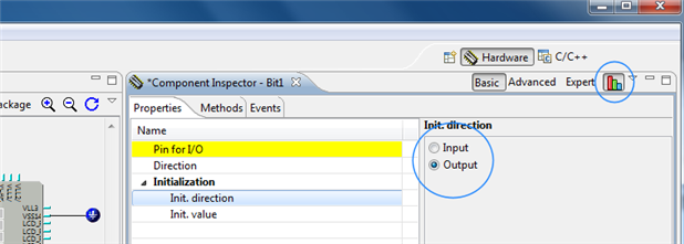

Now that the feature has been added to the project, it can be configured using the Component Inspector which by default is at the top right:
The attributes like pin direction are listed, and the values can be modified by clicking on them. This is the basic view, but some hidden attributes may appear by clicking on Advanced or Expert. It is not needed in this case. There is also a graph-like icon that provides an alternate view that looks like this:
Clicking on the graph icon again reverts back to the original non-graph view. Use whichever one you feel comfortable with.

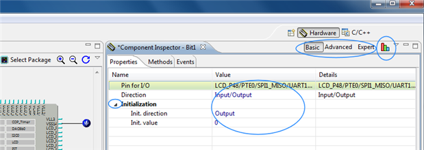

Looking at the  FRDM-KL46ZFRDM-KL46Z schematic it can be seen that a red LED is wired here to a pin(pin 26 marked PTE29/CMP0IN5
Using this information it is possible to set the attributes until they look like this (I encountered a bug in the graphical view where it would display a red exclamation point even when there was no conflict, so I had to use the non-graph view).
Notice that in the diagram you can see a symbol showing Port E is now in use on that pin (pin 26). The Components view will also show the feature that was added. Since there is an asterisk on the Component Inspector view, save the change.
The initial value was set to zero, which means the LED will be lit (LED cathode is being controlled according to the circuit).

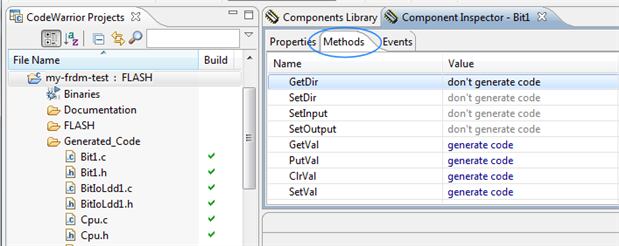

You’ll see in the Generated Code folder that some new files got created:

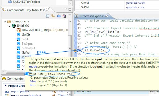

To use the feature, you’ll need to know what functions and events you can make use of. There are several ways to do this. One way is to right-click on the component and select Help on Component. There is lots of information including examples for many peripherals.
Another way is to click on Methods in the Component Inspector and you’ll see a list of them all, as shown here:
Or, you could double-click on the generated code files, and inspect the comments in the header file, or look at the C source file. Yet another way is to just hover over the names in the Components view, and some help will float on top.
The main() function actually has already been created, it is in a file under Sources called ProcessorExpert.c and if you open the file you can scroll down to it and find where it says ‘Write your code here’.
At that location, it is possible to drag the PutVal method directly into the C file.
The screenshot above shows what happens when you drag it across. The floating text occurred by hovering over the method in the Components view and it shows that a single parameter (bool Val) is required. The code was tidied up to look like this (a while loop to blink with a delay):
