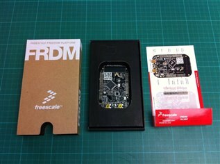

Well, not so much actually. The packaging is rather basic but good looking and is generic enough to be used for other FRDM boards, which is nice.
The box contains two things:
  • FRDM-KL25Z board
  • a quick reference card
It's a bit of a pity that no USB cable is provided, but as someone who is regularly playing with other dev kits, it was no problem to find one. Another thing to note is that the I/O pins are not populated with header pins, nor is the coin cell battery holder. The kit can be obtained for a bit less than 15EUR from Farnell, which is a totally acceptable price point for anyone looking to get started with something new.

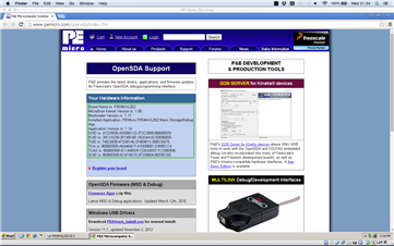

Using the board straight out of the box, it wouldn't show up in the debugger configuration interface, even though Windows detected the device and installed the drivers. Opening one of the html pages on the KL25Z drive that appears when the board is plugged in, an overview of software versions is provided. I searched for my issue online and verified if no new versions were available.
I found that my board wasn't running the latest version of the Bootloader (1.09 vs 1.11) and that no applications was installed. After upgrading the bootloader and installing the debug application, which is done by putting the board in bootloader mode (holding reset button while powering on the board) and dropping the upgrade files on the BOOTLOADER drive, the board was listed in the debugger configuration.

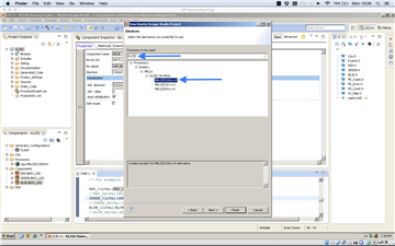

The "Hello World" of electronics: flashing an LED. In this particular case, I tried to light the RGB LED in different colours. As I was not familiar with the syntax, it took some time before I figured it out. The more I'll experiment with the board, the easier things should go in the future. To start, I created a new project, gave it a name, selected the correct processor and enabled "processor expert mode". You can follow the steps in the screenshots below:
Once the new project is created, it is possible to drag in components to control. I've found two ways to control the RGB LED: either configuring the BitIO_LDD component from scratch or using the predefined FRDM_KL25_LEDRGB components. Using the predefined components will ensure among other things that the correct pin is used as an output. Using the predefined components, some fields are not editable. If needed, they can be edited by switching to "advanced" mode.
