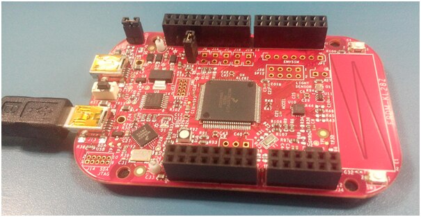

FRDM-KL28Z Description:
The KL28Z is a sub-family of 32-bit Kinetis microcontrollers based on the ARM CortexR-M0+ processor. It is an extension of the existing L series MCU family, with additional memory. The KL28Z sub-family provides up to 96 MHz (HSRUN mode) CPU performance. It supports ultra low power, up to 512 KB Flash with 128 KB SRAM and integrates functions such as USB with crystal-less recovery.
The FRDM-KL28Z hardware is a Freedom development board assembled with the following features:
  • MKL28Z512VLL7 MCU (96 MHz, 512 KB Flash, 128 KB RAM, 32 KB ROM,100 LQFP package)
  • 3-Axis Digital Angular Rate Gyroscope, FXAS21002CQ (U2)
  • Accelerometer and magnetometer, FXOS8700CQ (U10)
  • OpenSDA: On-board serial and debug adapter (U7)
  • I/O headers for easy access to MCU I/O pins
  • Ambient light sensor (Q1)
  • Flexible power supply options: USB, coin cell battery, external source
  • Capacitive touch slider
  • Reset push button (SW1)
  • NMI and LLWU buttons (SW2, SW3)
  • RGB LED (D2)
The FRDM-KL28Z hardware is form-factor compatible with the ArduinoTm R3 pin layout, providing a broad range of expansion board options. The on-board interfaces include an RGB LED, a 6-axis digital sensor (combining a 3D accelerometer and 3D magnetometer), a 3-axis digital angular rate gyroscope, an ambient light sensor, and a capacitive touch slider.

2. With the board unpowered, hold down the Reset button on the FRDM-KL28Z and plug in a mini-B USB cable into the “SDA USB” USB port on the board.
3. Release the Reset button.
4. The board will enumerate as a “DAPLINKBOOT” drive.
5. Drag and drop the application .bin file you just downloaded into this drive.
6. Do a power cycle, and now the board will be running the JLink OpenSDA application.

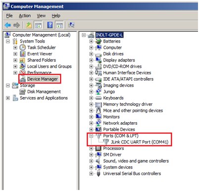

After loading the boot loader to your hardware board you can check the same at your computer’s device manager as shown below:

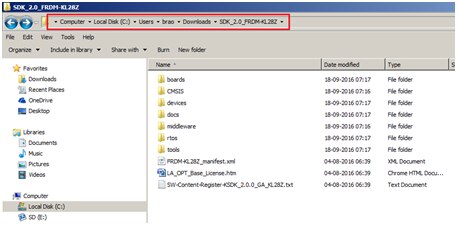

Step-2 Kinetis SDK V2.0 configuration generation for FRDM-KL28Z
Refer to my earlier blog on getting SDK V2.0 for FRDM-KL28Z
SDK has been stored at location “C:\Users\brao\Downloads\SDK_2.0_FRDM-KL28Z”
  SDK_2.0_FRDM-KL28Z is the sdk package

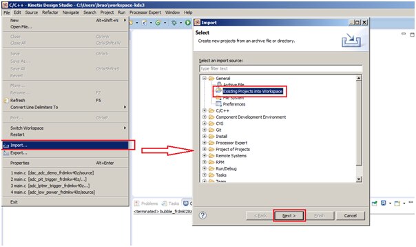

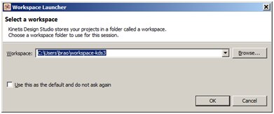

Open KDS 3.2.0 from default workspace
Select File->Import from the KDS IDE menu. In the window that appears, expand the "Project of Projects" folder and select "Existing Project Sets". Then, click the "Next" button.

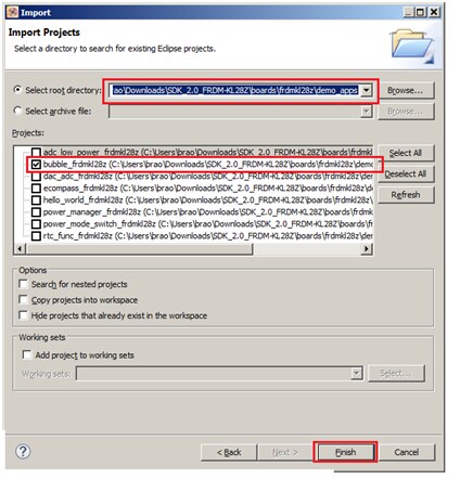

Click the "Browse" button next to the "Import from file:" option.
Now direct the path of SDK V2.0 as shown in step-2
“C:\Users\brao\Downloads\SDK_2.0_FRDM-KL28Z\boards\frdmkl28z”
  You will find “demo_apps” folder in which few application demos can be found
Click on finish and proceed further

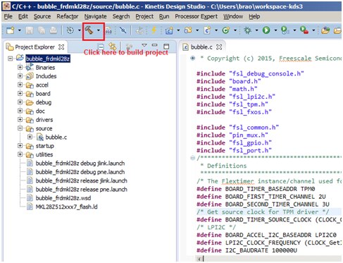

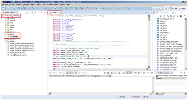

You can browse the application code in bubble.c file in workspace as shown

To build the project click on hammer button as shown:

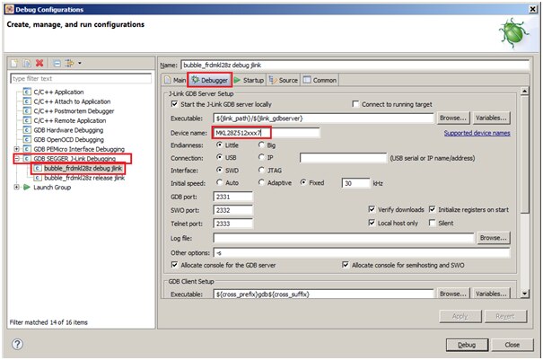

Open debug configuration from below shown window

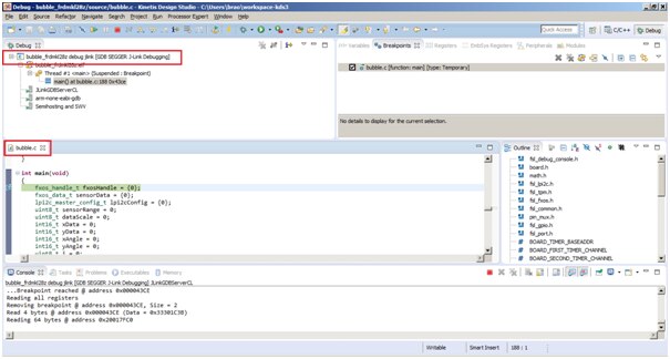

Now proceed by clicking Debug button
You will see the debug window as shown below:
Press Resume button to start executing the project

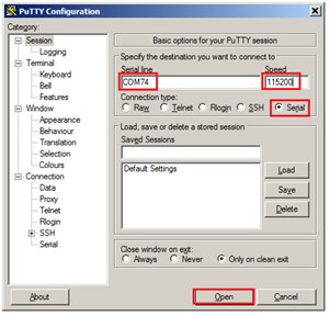

Open hyperterminal window of your choice, i have putty terminal:
As shown earlier the port number can be detected from device manager
Open a serial terminal on PC for OpenSDA serial device with these settings:
- 115200 baud rate
- 8 data bits
- No parity
- One stop bit
- No flow control

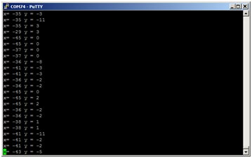

When the board is programmed, simply tilt the board to see the LED illuminate. One LED color indicates X-axis angle while another indicates Y-axis angle. When the example runs successfully, you can see the similar information from the terminal as below.
You can see the project execution on the terminal as shown below:
You will see the change of LED brightness when change angles of board
