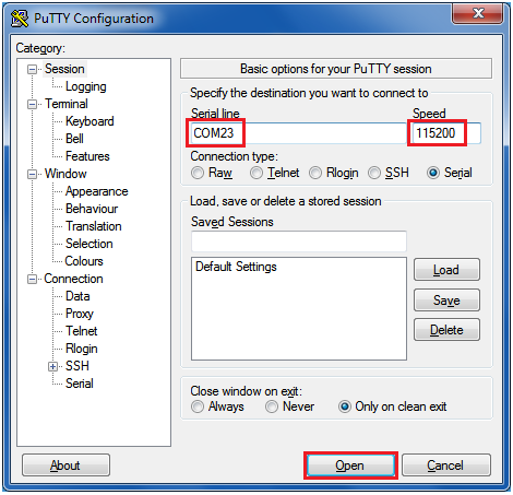

Plug in the boards to your computer and open the device manager from your control panel, you can see the com ports connected as shown below (in my case it is com23)
Open hyper terminal application from your computer, in my computer i am having putty terminal
Configure COM23 port to below configuration:
After opening putty terminal press the reset button then you can see the below execution window:
After pressing the space bar key from your computer, the user is prompted to enter a voltage to output on the DAC:
After entering a valid input, the ADC captures the voltage set by the DAC and displays the result in the terminal:
At this point, the user can test another DAC output value or terminate the demo. This configuration exhibits up to 2% error when reading back voltage.
