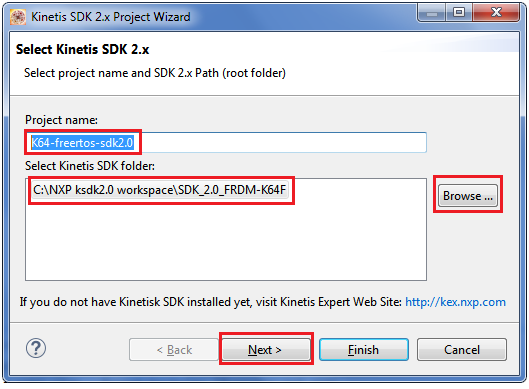

  • Start Kinetis Design Studio
  • Select the menu File > New  > Kinetis SDK 2.x Project
  • Enter project name of your choice i have named as “K64-freertos-sdk2.0” and Browse to the location “C:\NXP ksdk2.0 workspace\SDK_2.0_FRDM-K64F “
Select where you have unzipped the SDK package from previous step and press Next

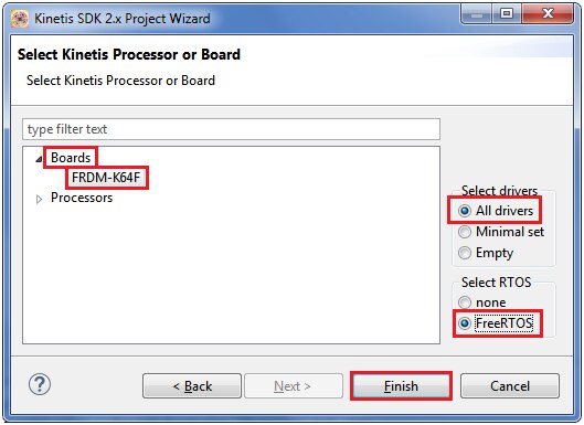

  •   Select board or processor and make sure you have selected FreeRTOS as shown below

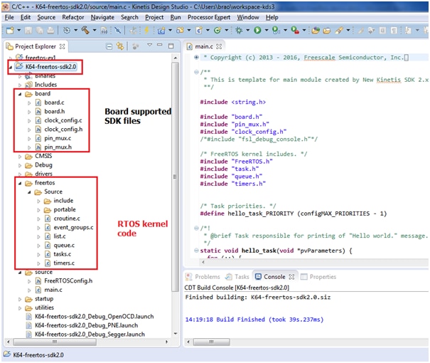

In the project created you can see the following folder structure:

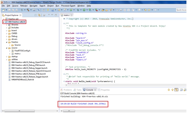

To check the project created is error free click on the hammer button to build the project as shown:

Now build and execute the project
You can see the project builds without errors

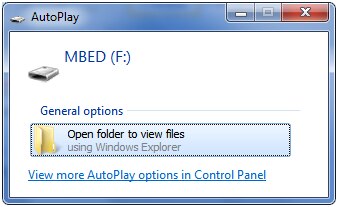

Now connect the K64 to your computer, you will find mbed folder appears
Copy paste the “K64-freertos-sdk2.0.bin” to this mbed folder you can see red and green led toggles alternately for a delay of 1 second.

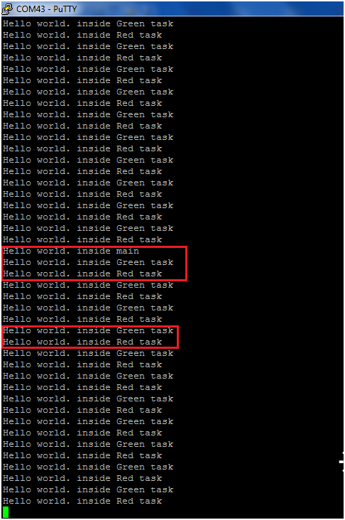

Optionally you can open the hyperterminal “putty” and configure the serial com port settings:
You can see the sequence of the task execution as shown:
You can see Red and Green led toggling sequentially using task scheduling:
