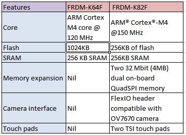

  • bheemarao
    bheemarao over 10 years ago in reply to clem57
    Hi Clem,
    Thanks for watching the tutorial.
    Find below the comparision sheet for K64F and K82F freedom board:
    for more details please click on the below link:
    K8X Freedom Development Platform|NXP
    Best Regards
    Bheema Rao
  • clem57
    clem57 over 10 years ago
    Sorry if off topic, but how does the K64F compare to the newer K82F in terms of I/O storage and processor capabilities?
    Thanks in advance,
    Clem
