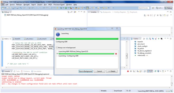

Now we will proceed to execute the project by debug process:
Make sure you have connected the K64F freedom board to USB port:
  Open debug configuration as shown below and press ‘Debug’
You will see below debug window:
Click on the resume button to ‘Run’ the project or ‘Step into’ and ‘Step over’ button for single stepping execution:
You can see RGB led glowing sequentially:

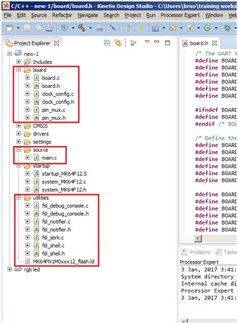

    bheemarao over 9 years ago in reply to nxavier
    Hi Nelson,
    If you import any example from “C:\NXP ksdk2.0 workspace\SDK_2.1_FRDM-K64F\boards\frdmk64f\demo_apps” from ksdk workspace or also if you create new project workspace it will create all the required folders like board, drivers, utilities, source..etc (as shown in below snap shot)
    Out of which "board" folder consist of all board related hardware information like LED, button, debug uart port gpio pins, clock configuration
    "drivers" folder consist of all the peripherals header files like FTM, ADC , DAC, I2C, PIT, UART, WDT .... it will be having al the API to perform the operation
    "startup" folder consist of system configuration function and a global variable that contains
    the system frequency. It configures the device and initializations..
    "utilities" folder has files corresponding Definition to support advanced format specifier for printf scanf..debug console input and output operations..
    finally the folder “source” has main.c where we will be coding our applications in which we will be #defining the required header files as shown below and access the corresponding api’s from driver folder
